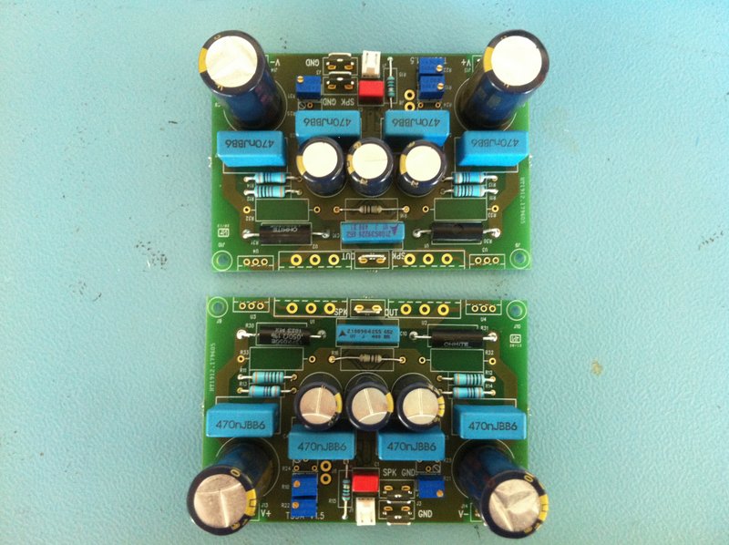

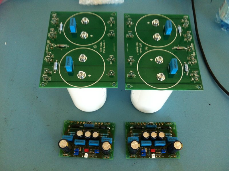

Progress.

The psu board needs to be calculated.

Ok. I have had the modules running for 12hours each. (please remember that this is without the renesas mosfet)
The do not drift a lot ... Delta 15mV
The idle current is stable. I am running 1.2A.
At +/-25V (18vac) the temp on a sk56 100mm from Fischer is 60 degreess
For +/-32V it is 68 degreess
For +/-36V we are hitting 72.
So the heatsink should be <0.4K/W og 2 heatsinks Per Channel.
In the first test i am a bit surprised as i was expecting tube sound, and this is true for the highs. A bit to soft or to sweet in my opinion... But it is not bad at All!!!
The bass does not suffer under the relatively High output impedance. The bottom and mids is really High class. No softie basguitar and it is easy to distinguese the instruments on Katie Melua - just like heaven.
