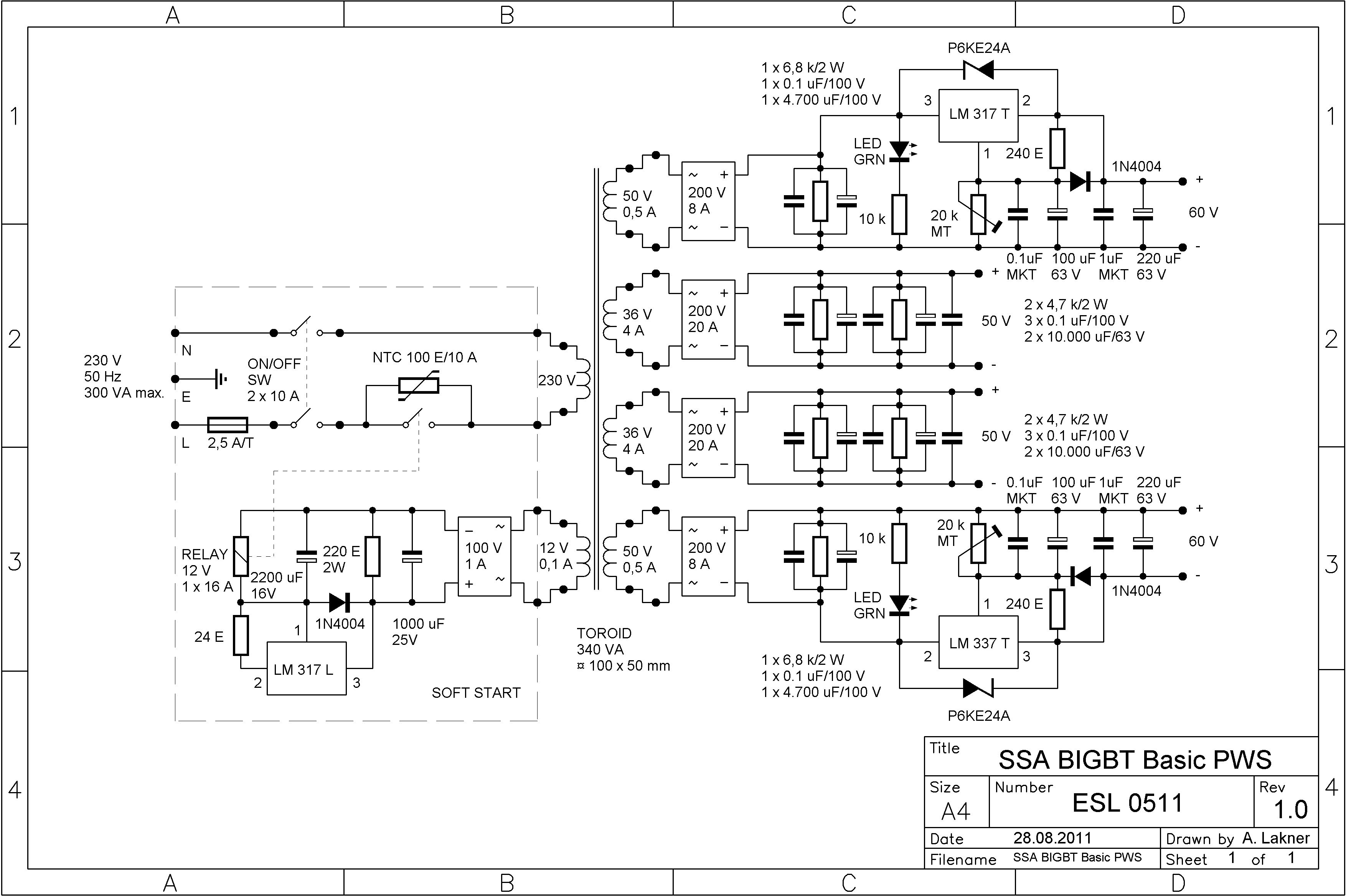

Hi LC,
In Order to futur supply update to supply fisrt amp stage with +10V did you see any objection in bellow schematic?
Marc
