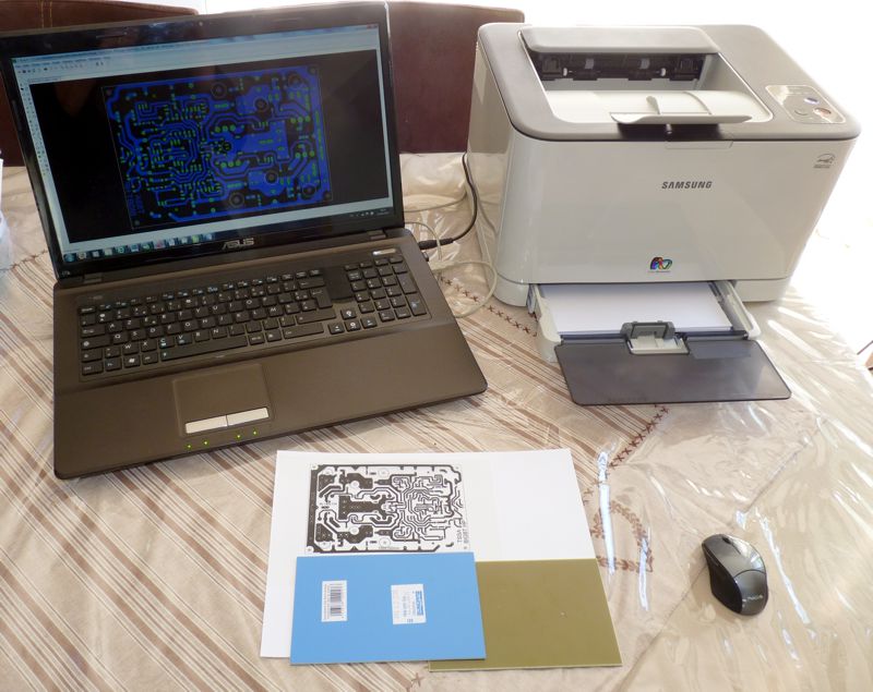

So i was waiting the new printer...to transfert eagle production on special laser transparent paper. I have bought the H2O2 that lefted. Next step is UV treatment, board revelating, and than eatching.
Marc

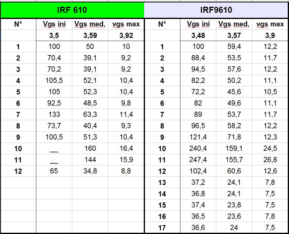

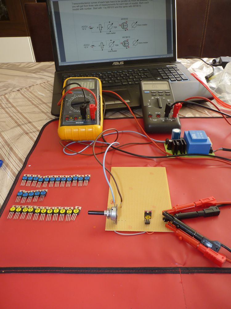

I achieve with LC help to take mesure of my IRF 610/9610 stock. I apply LC procedure desbribed forward in topic
Potentiometers on charts hehe, you see how nicely they revealed themselves Sherlock. :magnify:
Now you can pair them as much as you like, same n-channels, same p-channels, complementary pairs as well, anything you want. For actual BIGBTs take all four IRFs with same resistance (IRF610 - 1,9, IRF9610 - 1,12). :wiz:
There's even Vgs very similar at both cahnnels, you really can pair them perfectly from the stock you have.
Two words more about forthcoming single BIGBT: 360 Wmax, 30 Amax, 230 Vceo , enormous and linear transconductance - quite a beast. :hbeat:
Now you can pair them as much as you like, same n-channels, same p-channels, complementary pairs as well, anything you want. For actual BIGBTs take all four IRFs with same resistance. :wiz:
There's even Vgs very similar at both cahnnels, you really can pair them perfectly from the stock you have. 😱
Ok, so no need to take more at mouser yet. I plane to use pair irf610-8//9610-5 and IRF610-9//9610-1.
Marvelous number. What dou you think of NJW1302/3281 for another BIGBT module since in datasheet they indicate
NPN/PNP Gain Matching within 10% from 50 mA to 5 A
regards Marc
