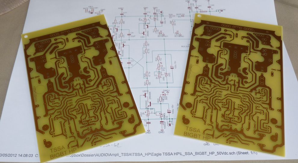

After Mouse-r Cat arrives to inspection, mhmm nice bags of toys you've got there. :magnify:
:up: PCB time :clock:
Yep, i just came from store with plastictainer, liquid mesure, and extra gloves for HCl/H2O2 manipulation....

PCB-s are looking great, we're just about to start soldering separate stages and simultaneously testing their functionality. It will be systematic construction process, also very educational one and above all a lot of fun. :up:
Regards Andrej 😉

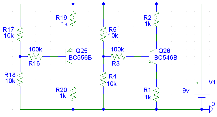

Regular hFE measurement by multimeter with this function is completely sufficient. Multimeters measure hFE at Ic=1 mA and that is OK for relative matching. Several times I rechecked hFE matching by Ic=100-500 mA by other methods and matched transistors always stayed in the same pairs as defined by multimeter. You are not seeking absolute hFE value of each BJT but using only relative comparison to find best matches. 😉
So i must be able to use the schematic below for this use. 0R22 are arrived to...
Marc

The hFE function on most cheap and cheaper DMM is based on a constant Ib. This gives misleading results.
But worse, the Ib is set so low that, the hFE results are for an Ic that is off the left side of most manufacturers' plots of hFE vs Ie.
This combination of design faults makes the added on hFE function a virtual waste of effort and waste of resources.
