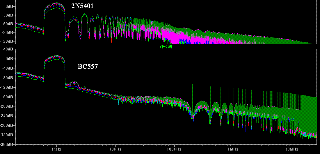

What is your favorite input transistor?
Have you tried various transistor for the input stage? How do you choose your transistor? I found that in TSSA this transistor matters a lot. Usually I still can use my standard 2N5401 for prototyping but here it is not possible at all. Yes, low noise transistors work better but I was surprised that the difference is so big. Attached is a simulated comparison between BC557C/547C and 2N5401/5551. Actually the 2N5401 doesn't work at all even with 0.1V input while BC557 can give THD of 0.002% at 60W output

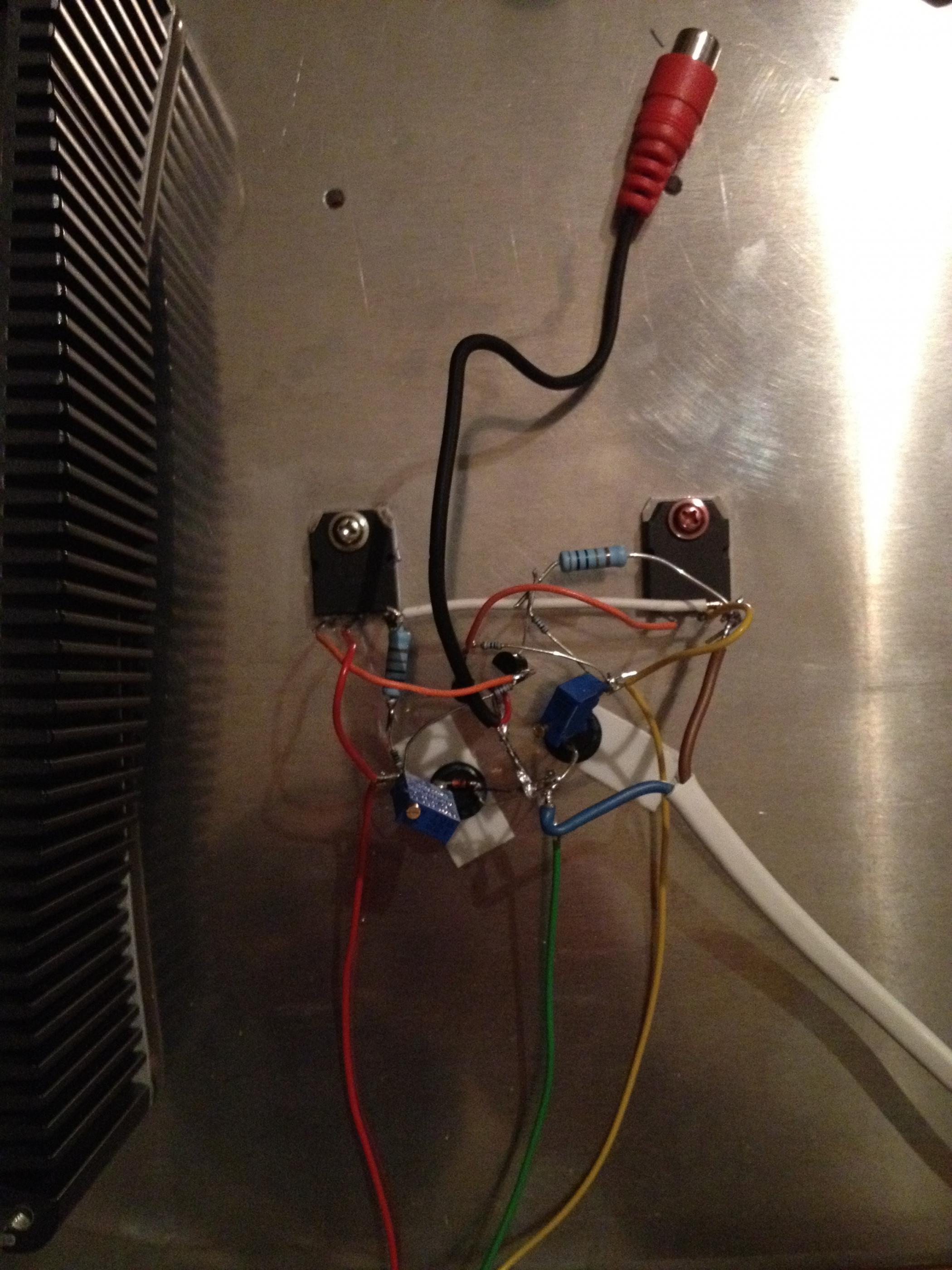

Started to build the first version of the TSSA (the schematic in post #1).
I got an -2.5V on the output without any load. I was to tired to troubleshoot so Im going to finish it tonight. Has anyone done schematic #1 successfully? This thread is to long to follow... =)

Hi McDaisy
Look to post #19, #20 Sonnya's work.
Also Gerhard did it.
Two trimmers serves to set the bias (output drain current) and output offset to zero. Sch is so simple that by rotating trimmers you should get linear readout change of these two values accordingly.
-2,5 V at the output simply means the offset is not finnaly set. Probably trimmer value should be changed if you reach the end position before zero output.
This is probably only the case in simulation or did you practically tested that 2N5401/5551 are not suitable. 🙄
Otherwise BC550/560 are very good for audio, best performance, low noise, at 1-10 mA bias (collector current). 😉
Only simulation (the fft is fine but distortion is not: it is not sinewave at the output). But with such a simulation result of course I don't want to use 2N5401.
I used BC550/560 actually. Even BC550 is not as good as BC557 (almost tho) in simulation. My original concern was: if transistor change can change the simulated result significantly, then it will be difficult to control the real result without real measurement and tweaking. No wonder someone got -2.5V at the output 😀

Hi Lazy Cat!
Thanks for the quick reply... Ill check it out tonight. But I still think something is wrong. Its because Im using smps and it got hot really really quick so I disconnected it until I find the fault...

Not related to BCs but rather to N-P ch Vgs threshold difference. 😉
