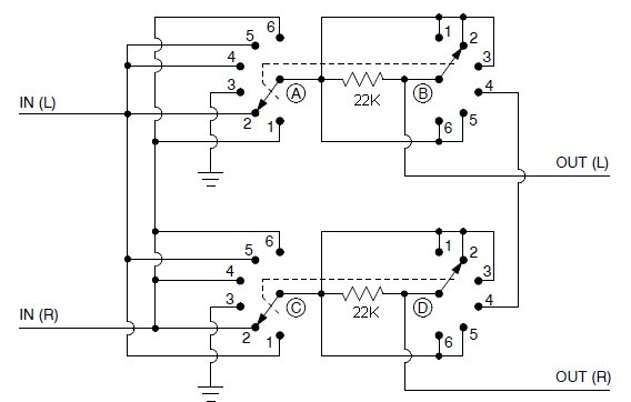

The old "output mode" switches that used to be ubiquitous on every receiver through the 1980's were very handy for "fast flipping" right/left channels to compare differences in balance/tone. With such a switch you can flip between left mono or right mono making it easy to compare tubes as you "roll along". Unfortunately this switch seems to have disappeared from most commercial amps. Here is what I mean, you've all seen one!:
https://goldpt.com/mode.html
Casual listeners would play around with the knob when they bought it, and end up
leaving it unknowingly in mono or L only, and listen to it that way for years.

Comparing the Left versus Right channel does not work if the dual triodes are in a single glass envelope.
That is the case of the preamplifier of this thread.
(One triode for Left channel and one triode for Right channel, all in the same glass envelope).
In this case, even if that preamp has a left and right channel switch, even that 1% is useless.
Back to the drawing board . . .
Build a DPDT switch box with RCA phono connectors on it.
Then get an identical 2nd preamp with different tubes in it.
Input the Left channel of A signal source to the switch box, and switch the output to the original preamp's Left channel, then to the 2nd preamp's Left channel.
Back and Forth, Back and Forth.
No long term "audio memory" required.
I am not talking about a double blindfold test anymore.
I am talking about instant switching A-B-A-B testing.
Simple but Expen$ive (A second identical preamp with different tubes).
If you can not hear the difference when testing that way, what is the point?
This lead me to a thought... Would it be technically possible to wire two single-triode tubes into one dual-triode socket?
