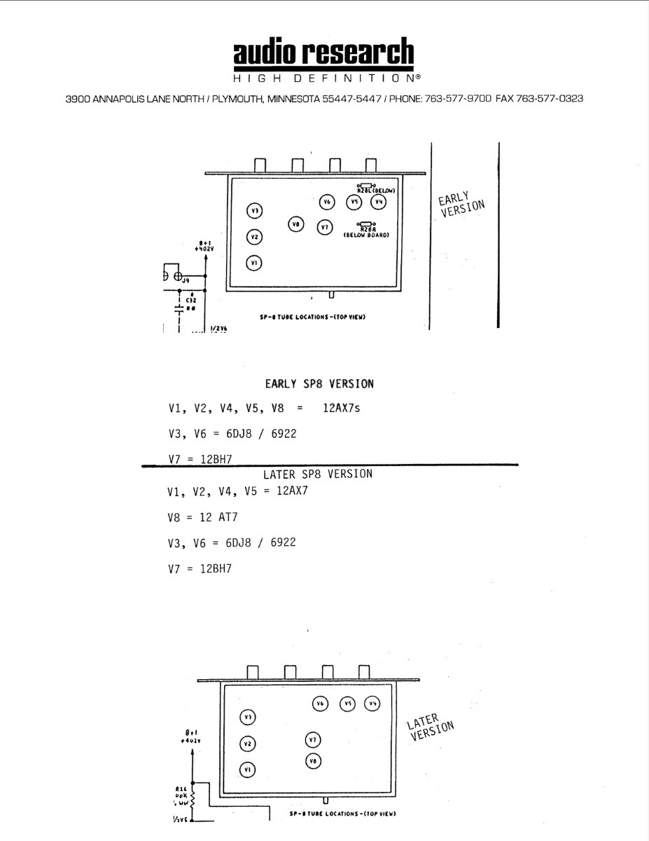

A tube kit amp I'm working on specifies that the output tubes are a gain tube and a follower to reduce output impedance, and lists the best tube types for each stage. In most commercial amps I see, they use the same tube in all locations, presumably for simplicity? Is the gain tube/follower tube common in most small-signal output stages? Should that affect how I think about tube rolling (ie, expensive NOS tubes in the gain, cheaper tubes for the follower)?
I have two real world examples to share, where I am trying to understand the tube rolls. The first is the Audio Research DAC3, which uses four 6922 tubes in it's output stage (schematic here: https://arcdb.ws/Database/DAC3/ARC_DAC3MKII_schematic_and_parts_list.pdf). I assume V1/V2 are the gain tubes and V3/V4 are the followers, so changing V1/V2 would have the biggest impact on sound?
My second example is the Audio Research SP8 preamp (https://www.arcdb.ws/Database/SP8/ARC_SP8_manual.pdf). It uses three tubes in the line stage and three tubes in the phono stage, as well as two more in the power supply. Notably, they output sections use two 12AX7s plus a single 6922. I don't understand this circuit, and don't really have any assumptions about which tube does what.
Anyway, just trying to get a bit more understanding before I stock up on vintage lightbulbs.
Correct.I assume V1/V2 are the gain tubes and V3/V4 are the followers, so changing V1/V2 would have the biggest impact on sound?
It's just two gain stages, plus a cathode follower, with overall feedback to acheive the RIAA curve. Again, the gain stages will have more impact on the sound than the cathode follower. However, it's not as easy to roll a phono amp because the RIAA curve depends on the gain stagecharacteristics, so you would likely end up throwing off your equalization in the process. Or you can think of it as adding some extra, unspecified EQ, which obviously will have a large impact on the sound.I don't understand this circuit, and don't really have any assumptions about which tube does what.
@Merlinb Thank you, that was exactly what I was looking for! For the phono stages: If I source a closely matched pair or appropriately spec’d tubes, is that not enough? Like, if the amp is currently running a matched pair of Electro-Harmonix 6922 and I replace them with a closely matched pair of NOS Mullard 6922, that could throw off the EQ more than doing the same swap in the line stage would change the sound?

Huh? Why would I want to do any of that? I want to roll 6922 tubes in my preamp and source devices with different brand 6922 tubes. Not power tubes, and not different tube types.
Aha, OK.
Tube rolling with Only the same Tube number.
6922 Only!
No 6DJ8, or other tube types need to apply.
Get ready to test the quiescent current of all those 6922 tubes in your preamp, one by one.
Then . . . decide if you need to make the currents equal before you listen.
Failing to have the same current might not a fair test.
But at least you can decide which tube sounds better, without regard to the different quiescent tube currents.
The same tube at different currents has different plate impedance, rp. And different rp can affect the RIAA equalization on many preamp circuit topologies.
If you don't set up the different tubes in different channels at the same time, and switch the signal back & forth from channel to the other channel,
You are counting on your "Audio Memory" to know which one sounds better.
Which RIAA recordings will you use?
Which phono cartridge will you use?
What is all the wiring capacitance from the cartridge all the way to the RCA phono jack at the preamp.
All these affect the "RIAA" equalization accuracy.
Just plug in the different 6922 tubes, and decide which ones sound better.
Don't worry about all the above complicated factors; rely on your ears.
Enjoy!

Quiescent current is determined by tube condition? Wouldn't the quiescent current between a pair of used tubes and a pair of new tubes be different?
Quiescent current is different from triode to triode in the same envelope, different from one tube to another tube, etc.
Much of the current difference is due to the chosen bias methods, the particular cathode resistor RK, plate resistor RL, B+ voltage, grid return resistor, Rg, etc.
Some circuits Magnify the above triode to triode, and different tube to tube current differences.
Some circuits Reduce the above triode to triode, and different tube to tube current differences.
Your preamp circuitry may be one, the other, or in the middle.

Have you started to measure the tube plate voltage, cathode voltage, and if necessary grid voltages?
I do not know your circuit topology, so just measure all three voltages.
Installed tube voltages?
Different tube voltages?

Are you saying that if I have two different tubes to compare, and they are the same type (ie, 6922), that I should measure the three voltages of the first tube, then swap, then measure the same three voltages again to compare?
Measure a set of tubes voltages. Then listen.
Measure a second set of tubes voltages Then listen.
Try and reduce the number of insertions and removals from the sockets.
Are the voltages close to each other, or far apart (the answer to what is "far apart" requires knowledge of the circuit, and how immune to differences it is).
Otherwise you only know how it sounds to you.
May be a good test, may not be a good test.
Just my opinions

Here is a link to the schematic: https://www.arcdb.ws/Database/SP8/ARC_SP8_manual.pdf
The tube layout is attached.
For general information: https://www.arcdb.ws/model/SP8
Put
Put
