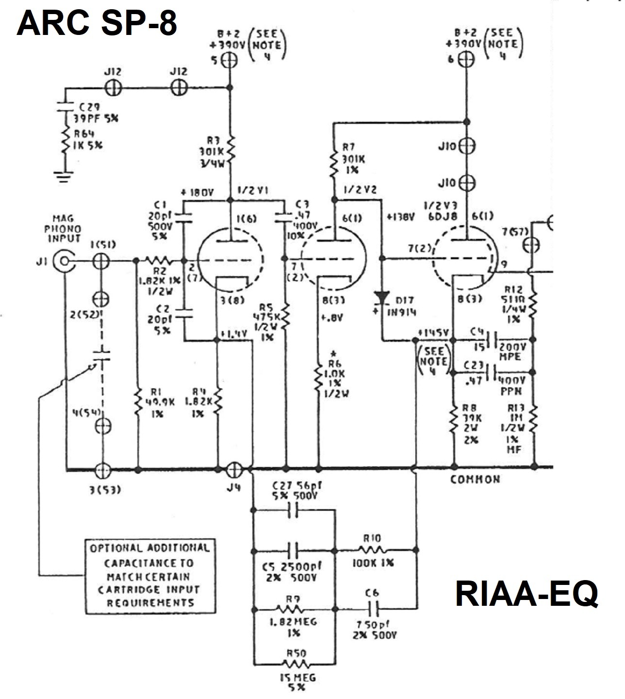

The moment you introduce Negative Feedback those differences are erased
Now response depends on NFB network, not on individualtube idiosincracies.
My point being that in your preamp, which uses NFB, you will hear no differences ...beyond Placebo effect that is.
So, because of the negative feedback, a brand new New Sensor 6922 and a 1960 NOS tube blessed by the Pope would sound exactly the same. What about a 6dg8 or other variant? Would there be variations in performance if a non-specified type was used?

But in a circuit without negative feedback, there would be measurable variation between tubes, but it would be essentially random? There wouldn't be common variations between tubes made at different factories?
The same electrical behavior in each individual tube stage remains, with or without global feedback.
Rather, the effective input voltage to the entire circuit is modified by the feedback to compensate
for differences between the input and output of the entire circuit.
Each stage still behaves the same, with or without the NFB. The input voltage (and so also the output voltage)
of each stage does change because of the feedback. But the individual stage output/input relationship
(ideally) remains the same, with or without global feedback.
Rather, the effective input voltage to the entire circuit is modified by the NFB to compensate
for differences between the input and output.
Which works out to mean any minor deviations in tube performance get “flattened out” by the negative feedback loop, right?
No, it's the entire circuit's output that is altered by GNFB. Each tube stage still does exactly the same thing, either way.
It's the input signal that is altered to compensate (and hence the output signal is altered as well), not the performance
of any individual tube stage, which remains the same.

Most of the circuits in your preamp use local negative or 2 stage negative feedback.
That, plus the self biasing tends to make the sound pretty much the same.

My goals are to explore sonic changes between compatible tubes.
Factor 1: Will replacing the original, used tubes of unknown lifespan with new (either new production or NOS) have an audible difference?
Factor 2: Will changing tubes between different manufacturers or vintages have an audible difference?
There is much “lore” about tubes, brands, and tonality, which I wanted to explore. I have been reading the descriptions for various 6dj8-family tubes here: http://www.audiotubes.com/6dj8.htm
I have the sense that much of this “tube lore” is nonsense, but I want to gain a better overall understanding, either through reading everyone’s comments here, or actually swapping tubes around, or both.
