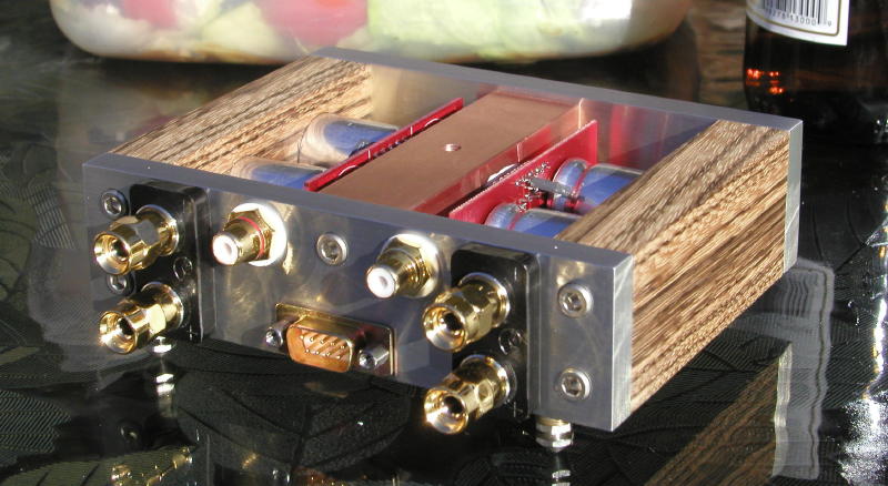

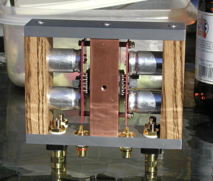

I'll come by this week to your place, so you'll be able to see it. But it seems to me like this is the nicest concept so far, it is so cute and literally fits in the palms of your hands.
I can't say its a commercial product, or I'll be prosecuted by opposition It is not yet, more tests to be done (especially on heat dissipation), but chances are that everything works fine. The amp can't get smaller than that.

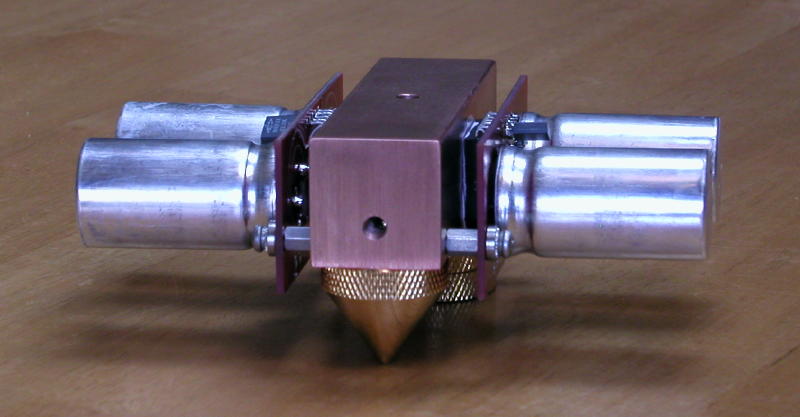

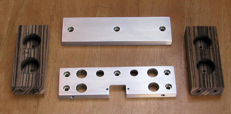

Beside 1" square copper bar (3.5" long), those all the other parts that make the amp. Those panels are 3/8"
The chassis can be made and finished in less than 5 hours. I'll post drawings on my site, so anybody can give it a try. I was considering using patented posts, but additional hole would weaken the rear panel considerably. I don't think it would be recommended, besides, you need as much of metal surface as possible (to get rid of the heat).

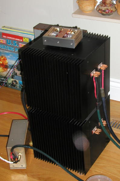

Well, the lower amp in this pic is AX. You see, it's disconnected. http://www.diyaudio.com/forums/attachment.php?s=&postid=359568
I'm using small monoblock on left in it's place. The top amp is A75 that I'm using for subs. I will try AX for subs, but have to remove the high pass filter yet.
The speaker wire on mids and highs is DH Labs Siver Sonic Q10, which is pretty good sounding (better than copper foil) and not that expensive: $9/foot.

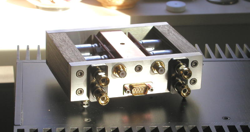

in case of overheating you could ofcourse use a band saw to make a heatsink profile in the copper bar or just use a (what;s that called in english? frees, in dutch) something like this:

I will still mount perforated panels on top and bottom and they will help with disippation. I don't expect any heat problems, as my other Patek (which is at least 1/3rd bigger), runs normally not even warm.
It's a good idea with those cutouts on copper bar, but the amp would loose a bit of weight in this way, and might fall off those class A amps
