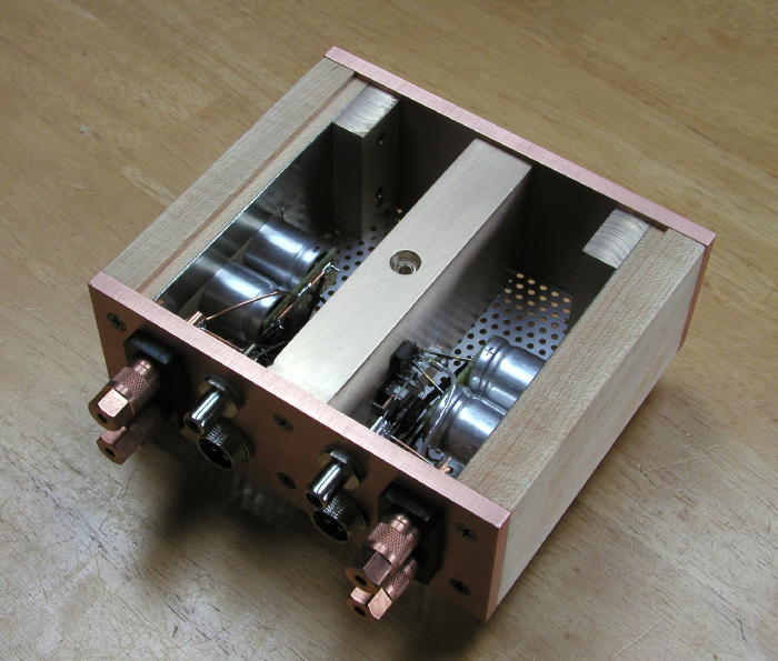

So here's my attempt at Patek amp. It uses similar size as Card, but it's slightly higher. I know it doesn't look very sexy, but the main concern was to achieve the mastery in the sound and not in the looks.

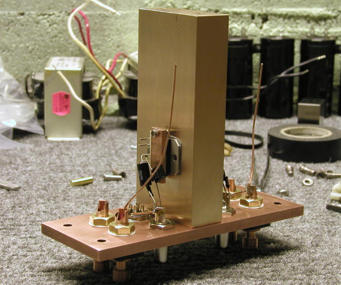

What I would suggest as Heatsink in such a design is actually a block of Bronze with several chimeys drilled out.
Keep the wood and C37 Lacquer it. And probably some Altman "Tubolator" Lacquer on the Chip and C37 on all Capacitors, plus wooden, C37 lacquered Capacitor Clamps for the (plastic stripped) PSU Cap's. Oh yes, also avoid any magnetic screws....
So I decided on the best materials I could use in such design and the core of the amp, the main support bar, is made out of bronze, while the front and back is out of 1/4" copper flat bars and "I keep the wood" so the sides are made of maple.
The size is about 5" x 6" and it's 2.5" high (excluding spikes)

But in what ways does it differ exactly from the original GC concept, or the "improved inverted GC concept" developed by you and members of this forum?
Don't just show off you chassis building capabilities ;) , offer some insights!
Circuitry? Chip (do I dare to ask? I assume that the LM3875 is still being used on this one)? :confused:
Shed some light!

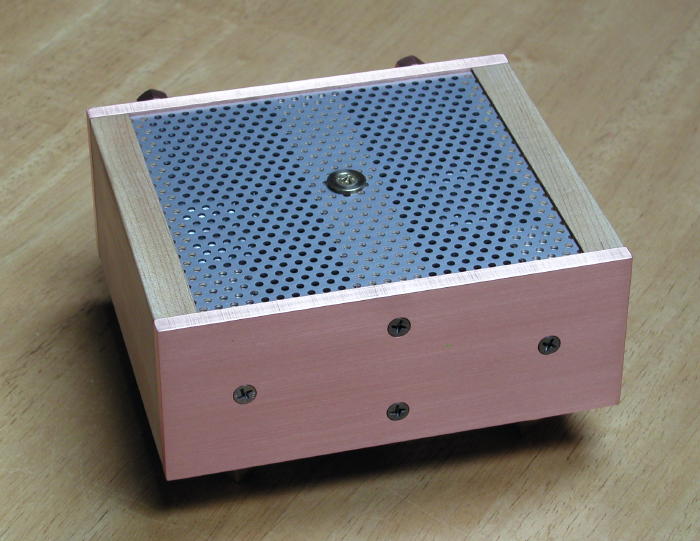

I didn't drill the convection channels through bronze slab, as from my experience the GC doesn't normally run that hot and I preferred to use top and bottom covers for a complete look. Here I used a perforated, ultralight aluminum panels. They shouldn't affect the sound in any way, as I know from other members, that this may be problematic. Their surface also helps to dissipate more heat and the holes keep the inside cooler. As usually, i'm using those brass spikes, as I get them pretty cheap and they sound good. One spike in a back, right in a place where the chips are mounted.

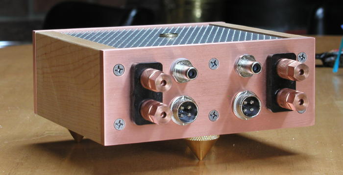

The rear panel is pretty straightforward and the only upgrade from my usual stuff are Kimber RCA jacks. I didn't implement volume control in this amp, as I want to use it as two channel monoblock for bi-amped system.
For stereo operation, I will come up with a support platform, containing PS and volume control with source switcher. I want to be more original this time;) and don't want to lower the amp's performance with a standard plastic pot.
Also titanium, aircraft screws are used.

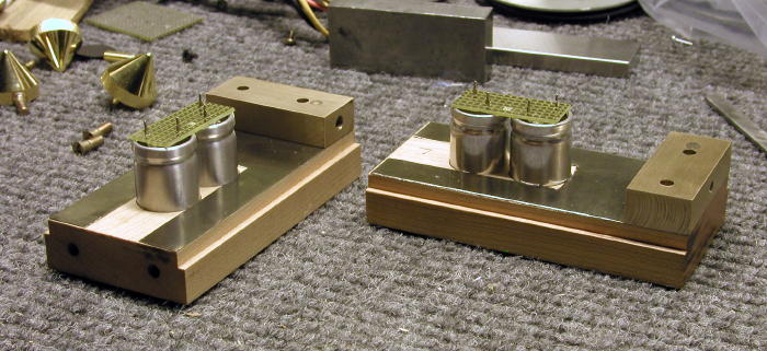

I like the approach of using more wood. Even if it means using some additional shielding material. For a cheaper approach I just used on an amp of mine some oak shielded with cheap PCB material (those PCB-material meant for etching your own boards, just without etching).
Wood is great. Even I can work on it ;) I've got two left hands when it comes to metalworks.

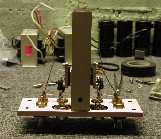

But what I also like is the concept of using a thick metal bar in the middle of the amp. Never thought pf that before (normally everybody attaches power devices to the "outside walls" of an amp, with inverted symmetry for stereo amps. This approach is nice....

IMHO, this approch is so far the best for that type of amp. Since I didn't want to copy 47Labs this time, the concept of center bar divides the amp again into halfs and seem to be better from resonance control view. Instead of bronze one can use copper and the front and rear panels could be made out of standard, preanodized, 1/8" bars available from HD. The wood adds a nice touch and works as capacitors support as well. This amp's character borrows more from tube equipment chassis materials and it can also be observed in its sound. It doesn't posses this aluminum glare and the silence between notes seem to be deeper. It is very smooth sounding right from the beginning. And for proper performance those BG need at least 24 hours.
I'm not using any small coupling caps. Signal goes directly through 244 ohm Vishay to + input. Feedback is 22k Caddock, another 22k vishay from + to ground and temporarily (for lack of anything better around) 655ohm Holco setting the gain.

The bar on the chip is copper. I didn't experiment with that, but since it worked on monoblocks I decided on same approach here. I like the shielding properties of copper, and I wanted to use natural materials, not man-made;)
