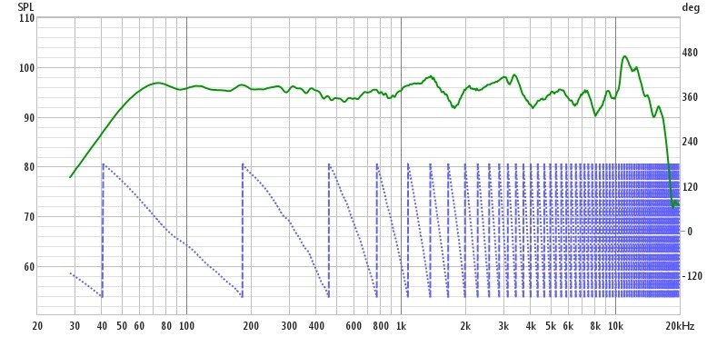

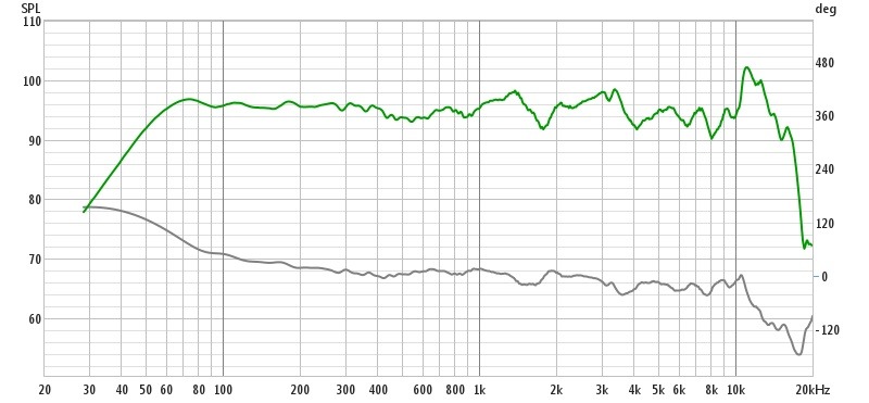

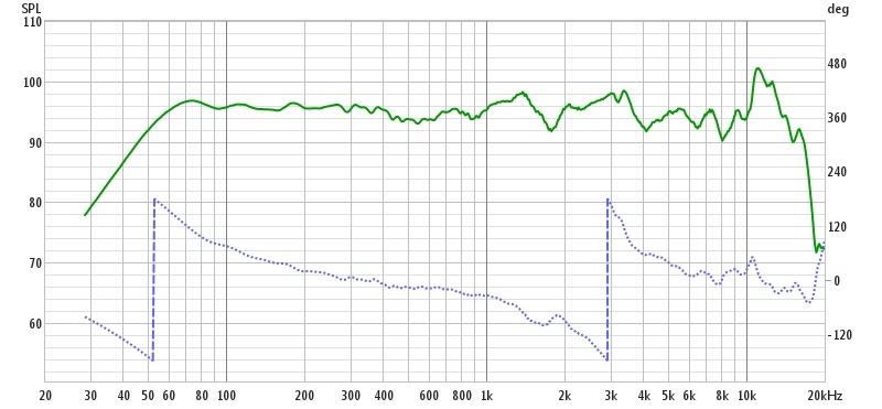

So, no further development, but I've learned a little more about phase in REW. I had thought that 'compute minimum phase' would remove the distance delay in the phase of my measurement. But I guess not? Here is the measurement with phase as taken...
and the notes that came up with the measurement say it has a delay of 3.1342 ms / 1.075 m / 3 ft 6.3 in. This is with a 2 channel capture with a mic and a timing ref channel. I left the delays in for my XSim work.

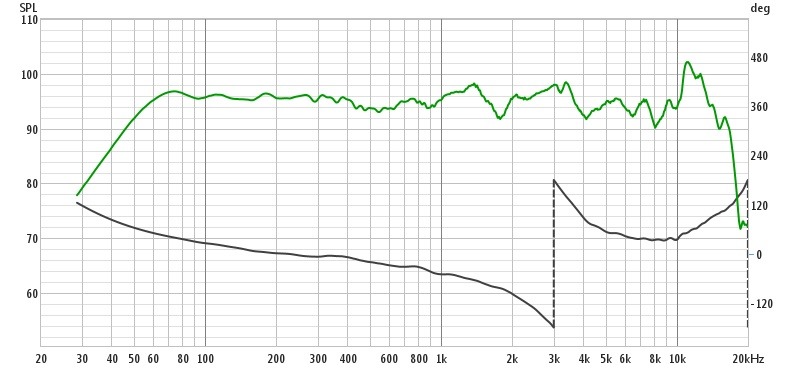

I can go to "actions" (gear icon, above graph on R) and select "offset t=0" and change that 0 to equal the time reported...
And now I see a phase flip at the XO point, which was what I had expected. And I think this is "phase" for the speaker.
But there is (after REW generates it) Minimum Phase and Excess Phase. I had kinda thought a speaker was a minimum phase system, so I am a bit confused about what these things mean WRT a measurement.
Min phase -
Excess phase -
Hmmmmmm... I've read a bit about it, but don't quite have it figured out. I'll continue to look for an explanation that makes sense to me.

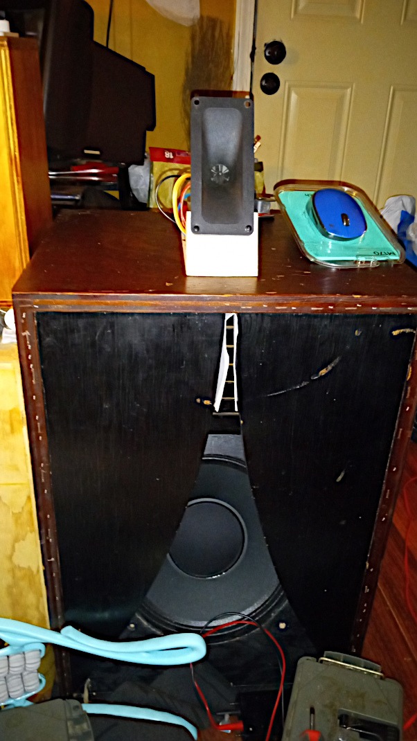

I've no measurements on this one - but it sounds really good and better than a 5x KSN1016 array on stepup
One KSN1016 Motorola) on the 5 watt tap of a 25v matching transformer. The 8 ohm tap is used for the primary and has 7.2 ohm/100uH Zobel - - crossover is all I have ~1.3uF cap. The wideband in the little Karlson K12 is Celestion's K12H-200TC. There's 22 ohms in series with the piezo.

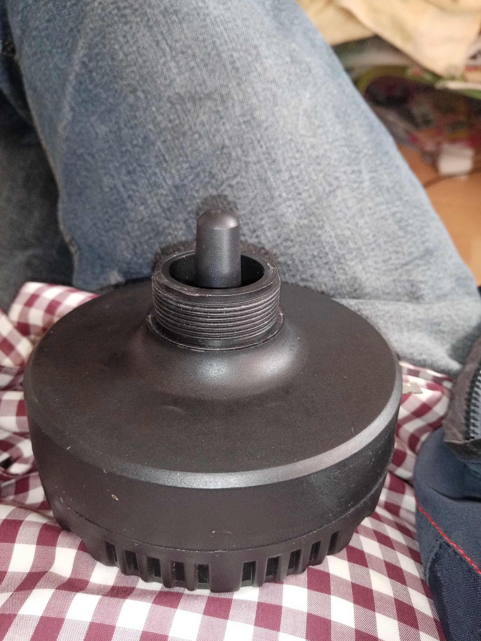

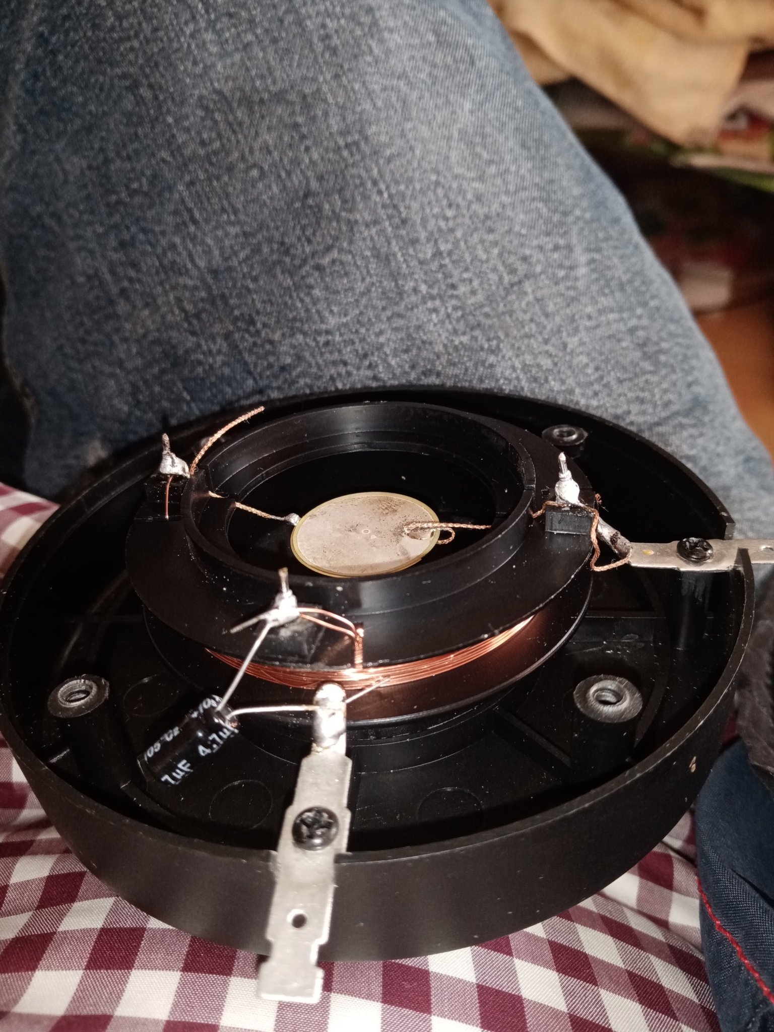

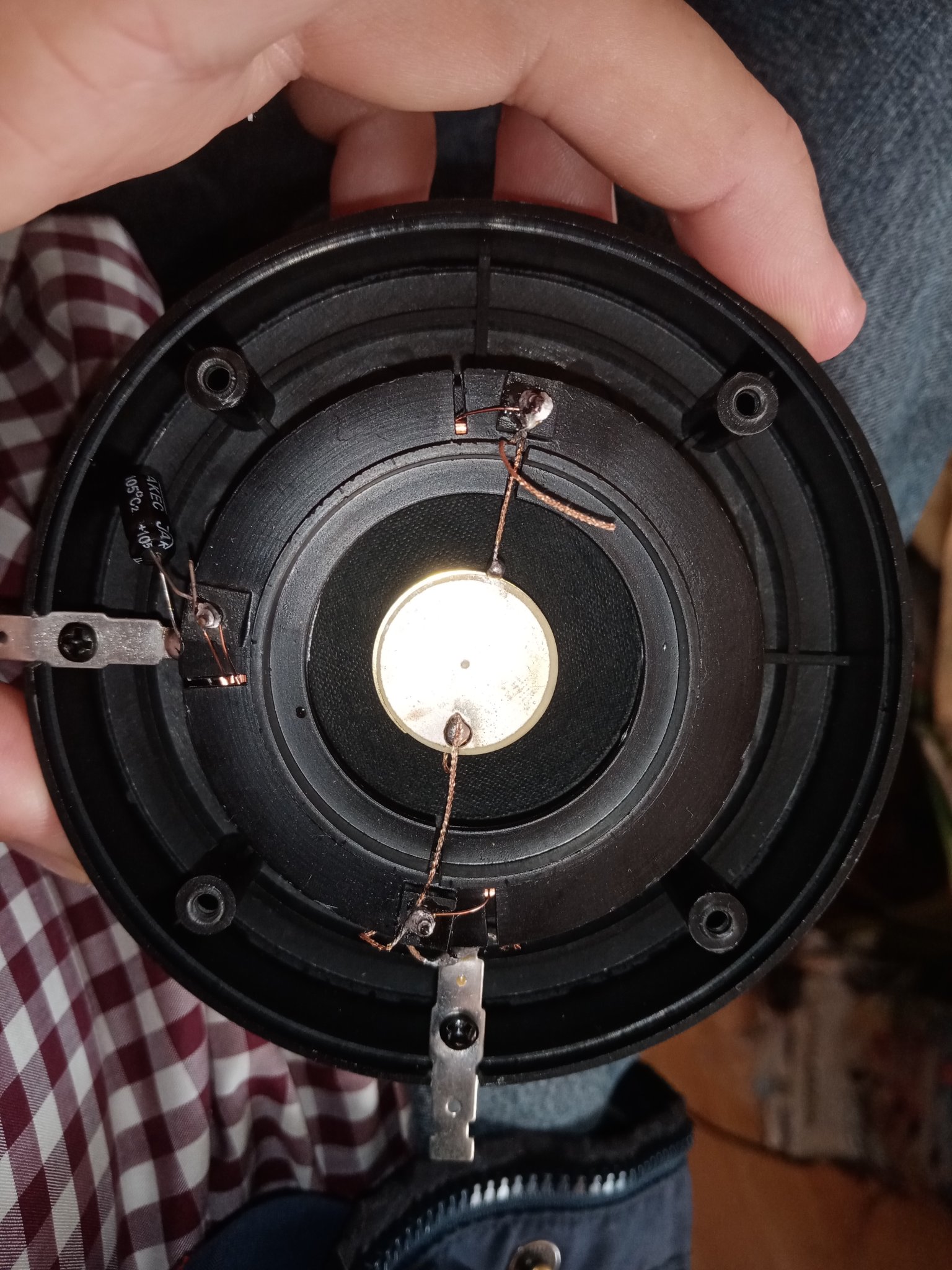

can me tell someone what kind of piezo tweeter this "professional" piezo from Mc Gee is?
What does the coil do?
Anyone knows its schematic?
There is a 4.7uF nonpolar 50v cap in line, the coil is in parallel?

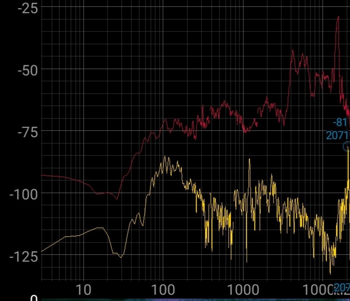

I measured it with white noise and Spectroid app without horn
drops like a stone at 4khz

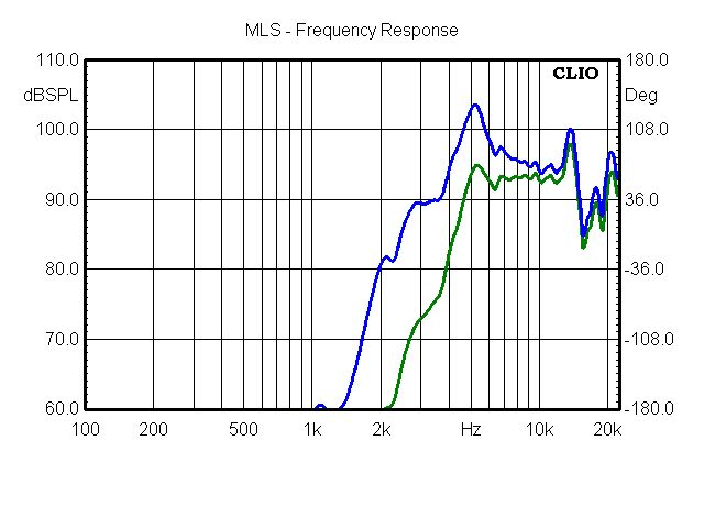

It doesn't have to be big, if you include series resistor with the inductor. That "dumping" resistor is crucial (6.8 ohms here), see my "ultimate" crossover for Motorola KSN 1005A:
https://www.diyaudio.com/community/threads/to-piezo-or-not-to-piezo.310934/page-2#post-5162616
Blue: Motorola KSN 1005A
Green: with "ultimate crossover"
That 33ohm resistor will actually cause very high frequency roll-off due to the natural capacitance of the Piezo driver.
If you replace the 33ohms with a .1mH inductor you will be amazed at the very high frequency response 🙂

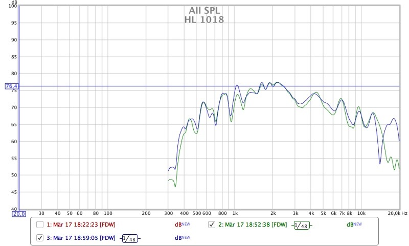

Thats the thread on the HL1018 horn
https://www.diy-hifi-forum.eu/forum...ee-HL-1018&s=2c28c0a3bbff04e3ff4676a733bebdd1
Here an image of what the horn can do with a "normal" driver (not piezo). Could be used easily from 800 hz on IF the driver can do it with low distortion. The acoustical knee after linearization would even allow for 450 hz. Blue line is for modified throat with a better transition.
Piezos do not have that rising efficiency with the horn like drivers which can make a travel.
