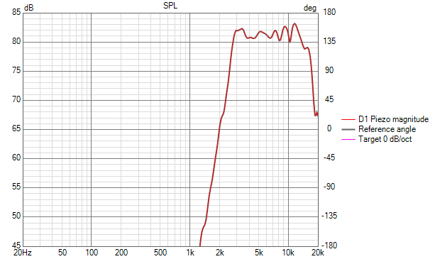

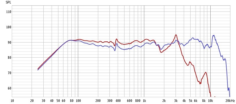

Here are the actual measurements from REW...
Red is driver alone, blue is whole system including wf / XO / twt. This is constant box, measurement environment, drive level.
unlikely to have anything to do with the crossover, more likely either box too small, box tuning too high, or rooom acoustics

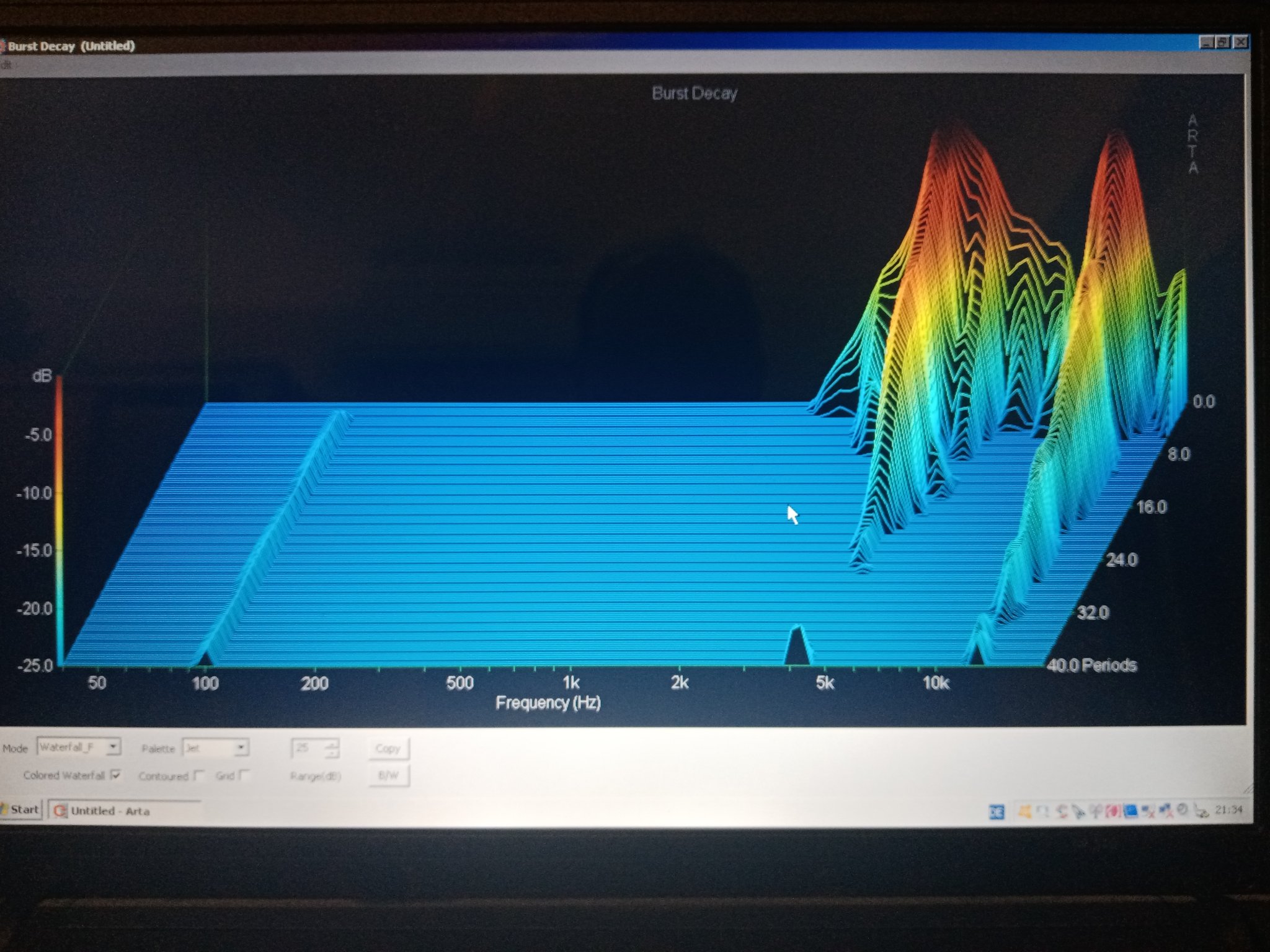

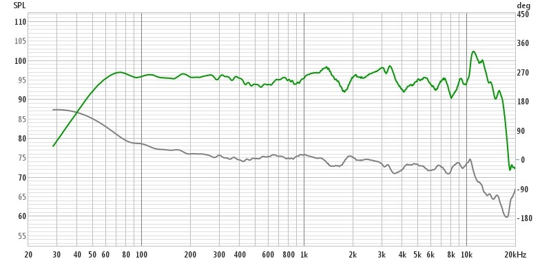

Here are some wrap up measurements for XO4 on this project. I've been enjoying listening to this speaker, I don't think the piezos sound terrible at all. The woofer is actually the THD limitation in this case. Here, check this out.

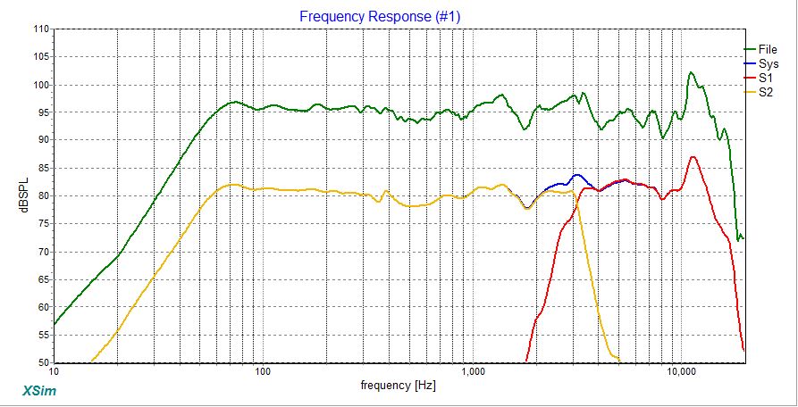

This is the measured output, vs the simulation. Things show up a little bit differently I presume because the confirmation measurement (green) and the measurements that fed the simulation were different sessions and I didn't manage to set everything up identically.
I'm taking ground-planes in my driveway, and angling my speaker down to point the listening axis at the mic. I've been shimming up the back of the speaker with scrap wood, but I think I'll have to make some sort of repeatable / adjustable incline platform to up my measurement game. Has anyone seen examples of others making something like this? Looking for ideas.
But the result is as expected. Tamed the LF boom, little peaks at 1500 and 3k. Tweeter resonance up at 11k -ish. The 3k prominence could have been dealt with maybe if I had re-done the woofer LP, but I didn't want to buy a new inductor for it. I didn't worry about the 11k peak, I figured it would be narrow dispersion, but some other measurements showed it wasn't, so maybe I should have dealt with that. I don't hear it in listening, maybe my ears are old, but I also think there's not really a lot of content above 10k.
Minimum phase (grey above) looks better than I expected. I think I have the piezo reversed and was expecting to see the phase flip somewhere but I guess not?

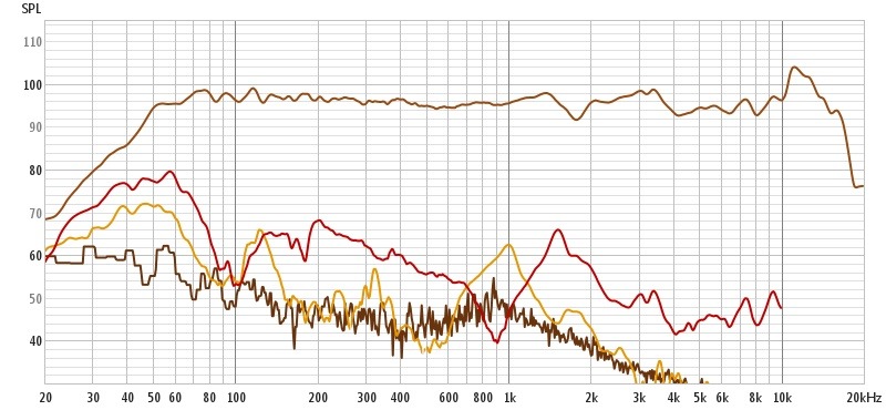

Here's distortion, I see the graph key wasn't included in the image export. Red is H2, yellow is H3, brown is noise floor. REW has more harmonics, but I have turned them off as they are below the noise floor (does that mean they're invalid? Or is there some means of determining what's going on down there?*). From the woofer-only (no XO) measurement in post 21 or 19, you can see the woofer has a resonance at 3kHz, so 3rd harmonic of 1k and 2nd harmonic of 1.5k makes sense. But the distortion in the piezo range is 50-ish dB down and H2 dominant so the THD of the Piezo seems fine to me.
* If the noise floor is tilting down (typical) then maybe you could see some THD below noise floor b/c the noise floor at the harmonic is lower than the noise floor at the fundamental?

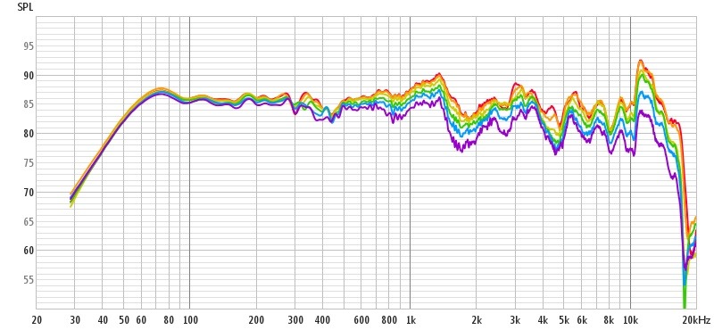

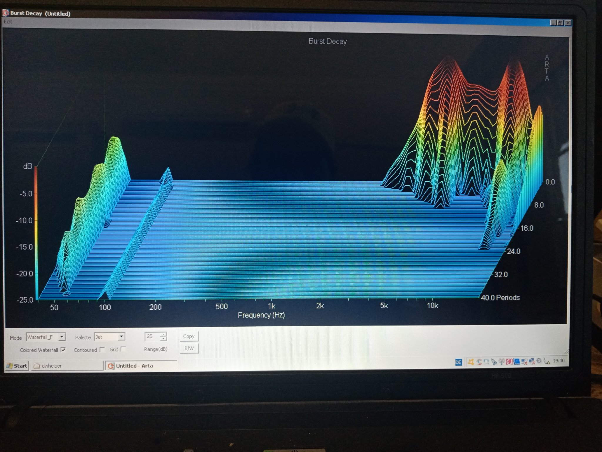

This is FR off axis, going 0-10-20-30-40-50 degrees. Not bad, I think! But 11k wasn't just a narrow dispersion thing.

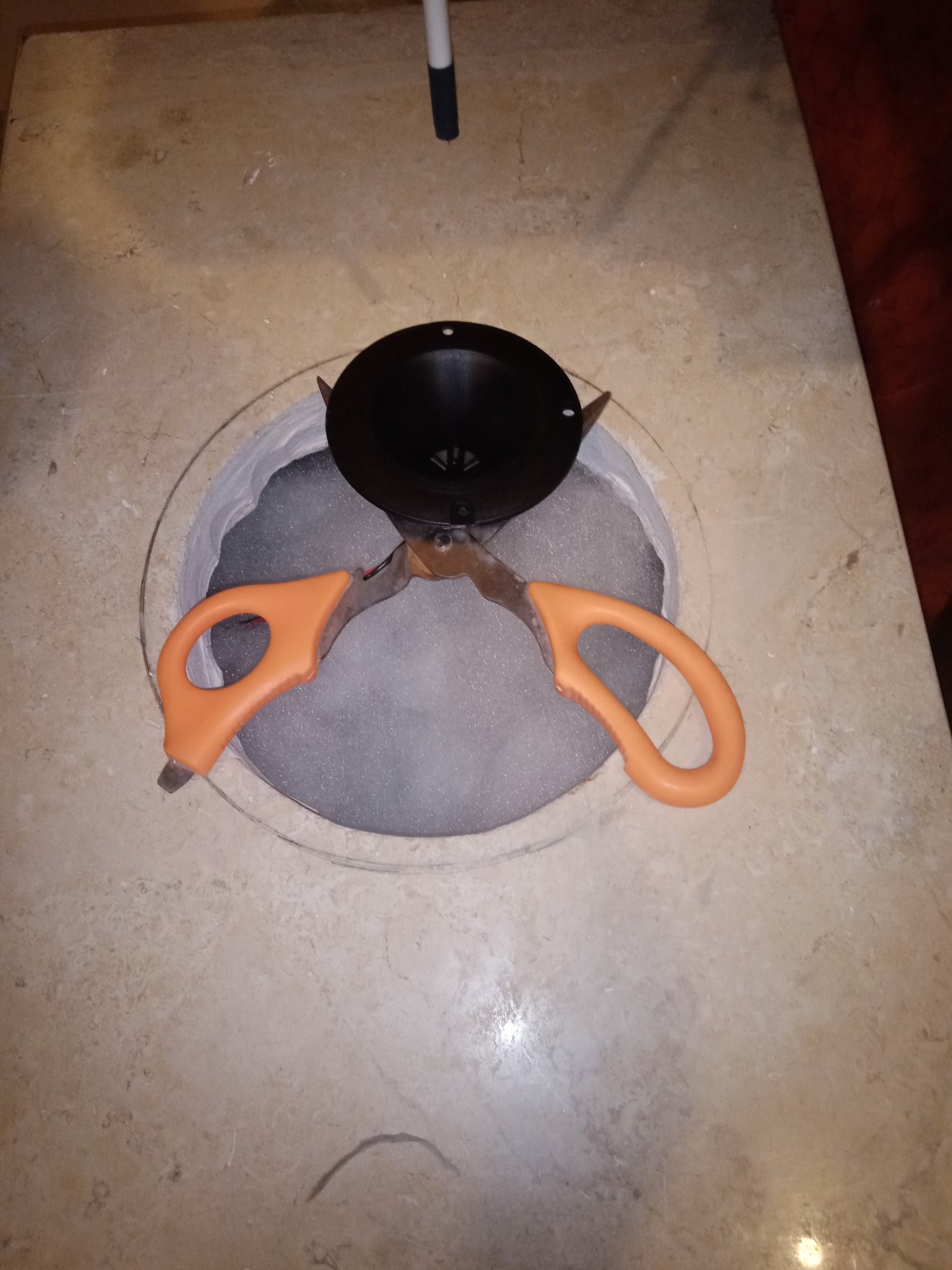

I use piezos for years, the "good old ones" from Monacor(?), type PHM8.19 (8x19cm).
They got their own enclosure, filled with sand to kill the plastic horn's resonances, and also a simple crossover, see below.
In front of them I mounted something which was called 'sound distributor lens' back than.
They sound fine. Listeners who doesn't know don't recognize them as piezos.

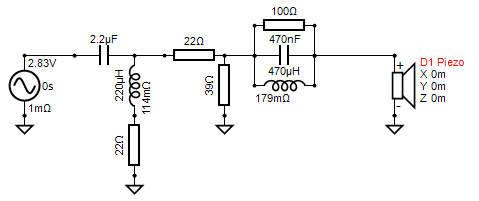

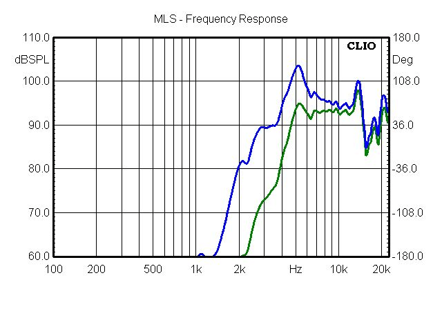

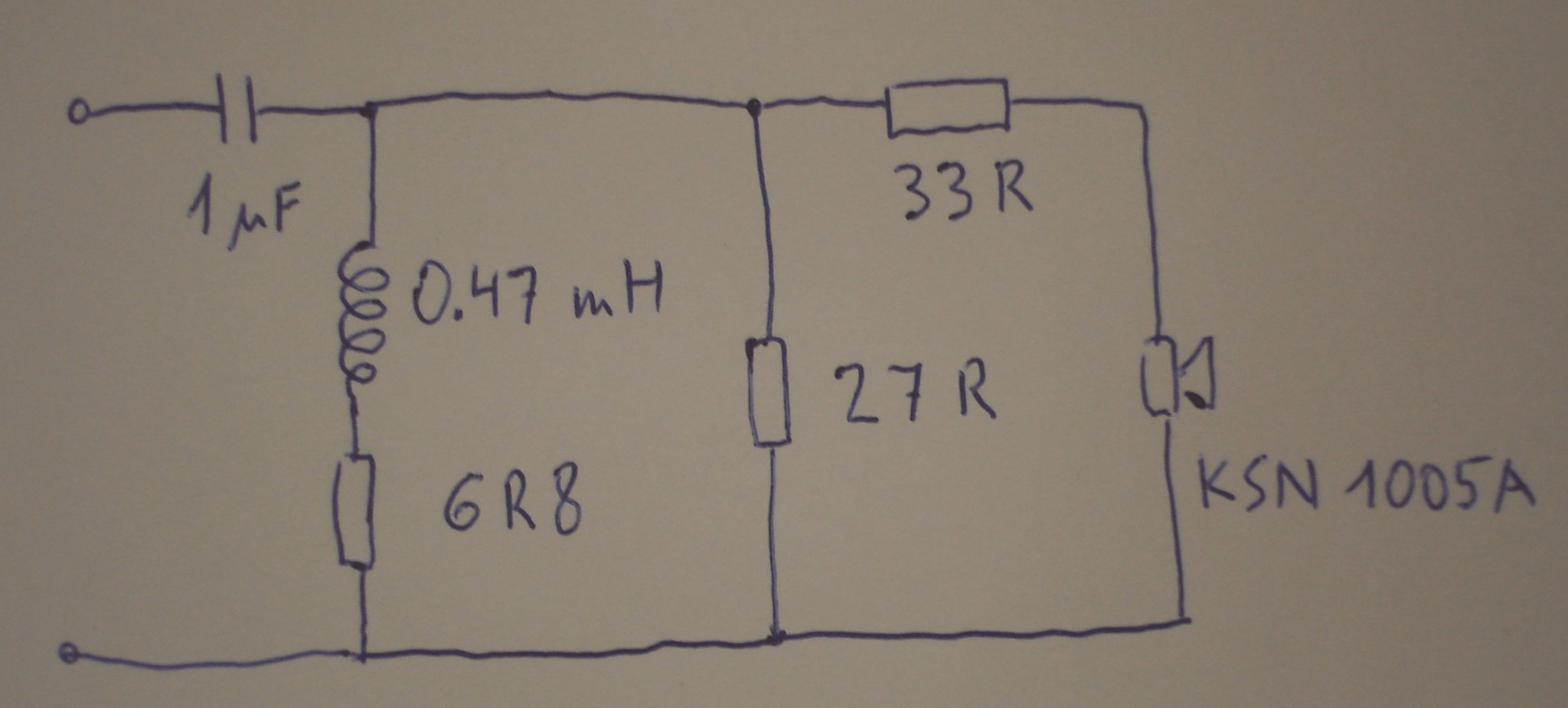

It doesn't have to be big, if you include series resistor with the inductor. That "dumping" resistor is crucial (6.8 ohms here), see my "ultimate" crossover for Motorola KSN 1005A:But the inductor is big, and that's a bummer. That L2 in my XO design (see post 19) is 6.8 mH.
https://www.diyaudio.com/community/threads/to-piezo-or-not-to-piezo.310934/page-2#post-5162616
Blue: Motorola KSN 1005A
Green: with "ultimate crossover"
Filter for "1016" piezo, with supplied REW measurements. Woofer SPL at 1m/1w is not taken in consideration, nor the phase relationship:
Take notice of the importance of the "dumping" resistor (22 ohm here, in series with 0.22 mH), which allows much smaller values of the inductor.
Sonce, that looks like a good result! I'll play with that topology in simulation to understand better.

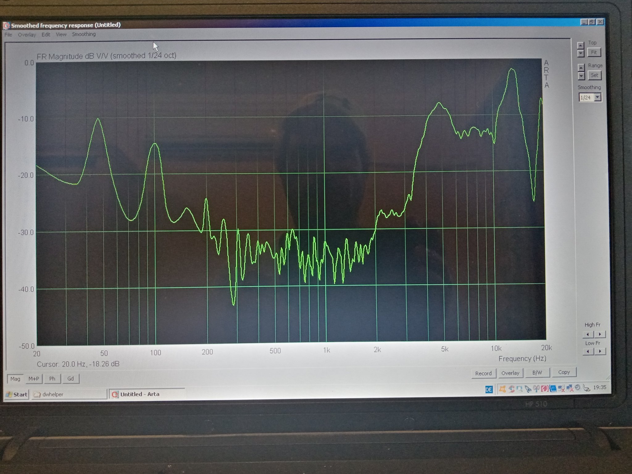

I am preparing a pair for indirect sound so frequency response is not critical.
Thin metal foil does not change the frequency response but I do that to all drivers I use (see thread "How to make a diy sandwich loudspeaker cone" here in the forum)

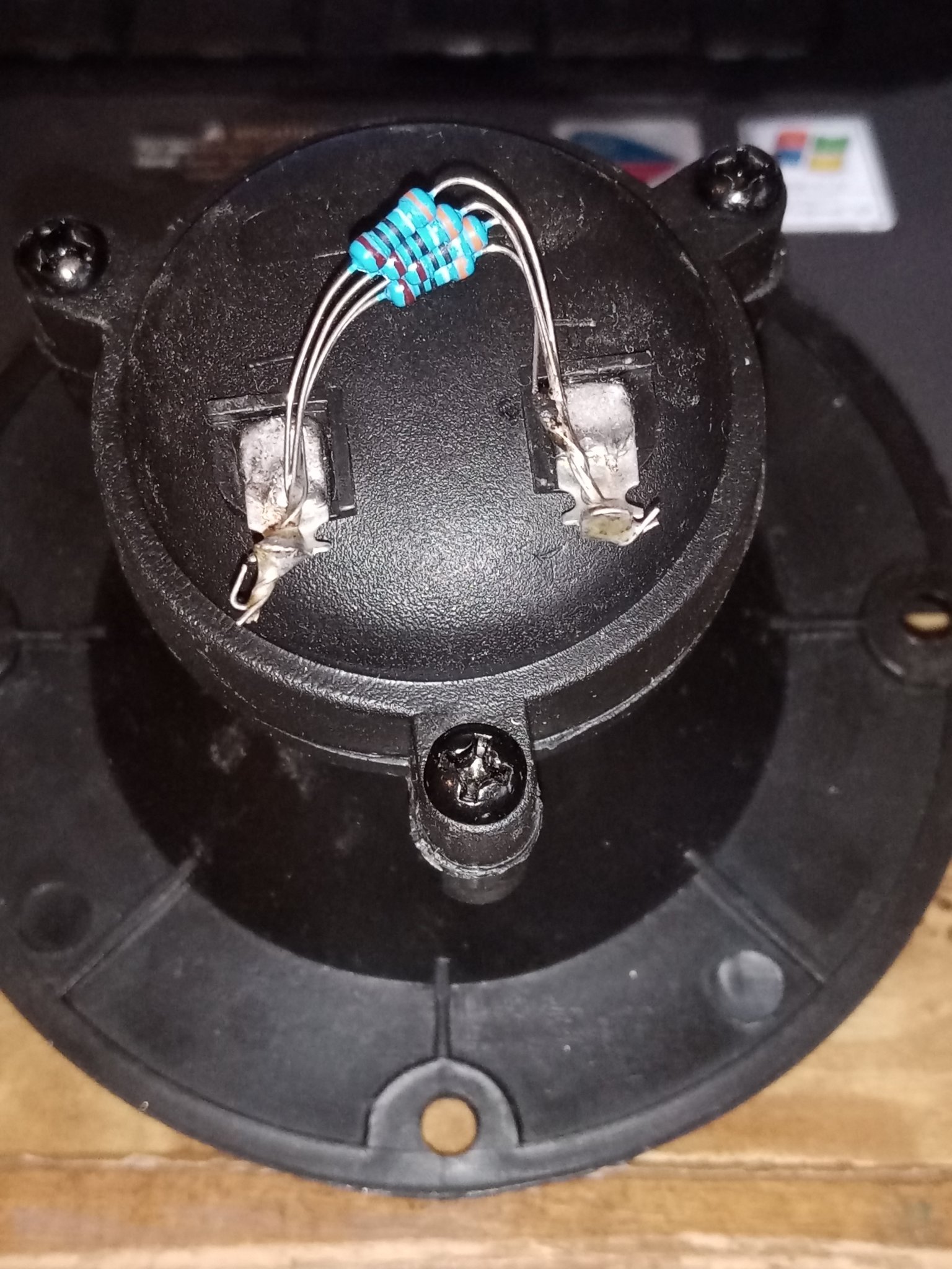

Added 100 ohms from plus to minus and tried 0.26uF and 0.039uF in line.
Raw driver no crossover

It looks like your pair resonates higher than mine, 5k rather than 3. I wonder, is it a property of the diaphragm? The piezo element? The rear chamber? The horn? I suggest a bit of poly fluff around the back of the diaphragm, see my posts 2 and 4 in this thread. Cheap piezos seem to me like fertile ground for these sorts of mods, inexpensive to try lots of iterations and learn what is actually helpful, and I think maybe the very cost sensitive construction leaves performance on the table for DIY greedy boyz to snatch up.I am preparing a pair for indirect sound so frequency response is not critical.

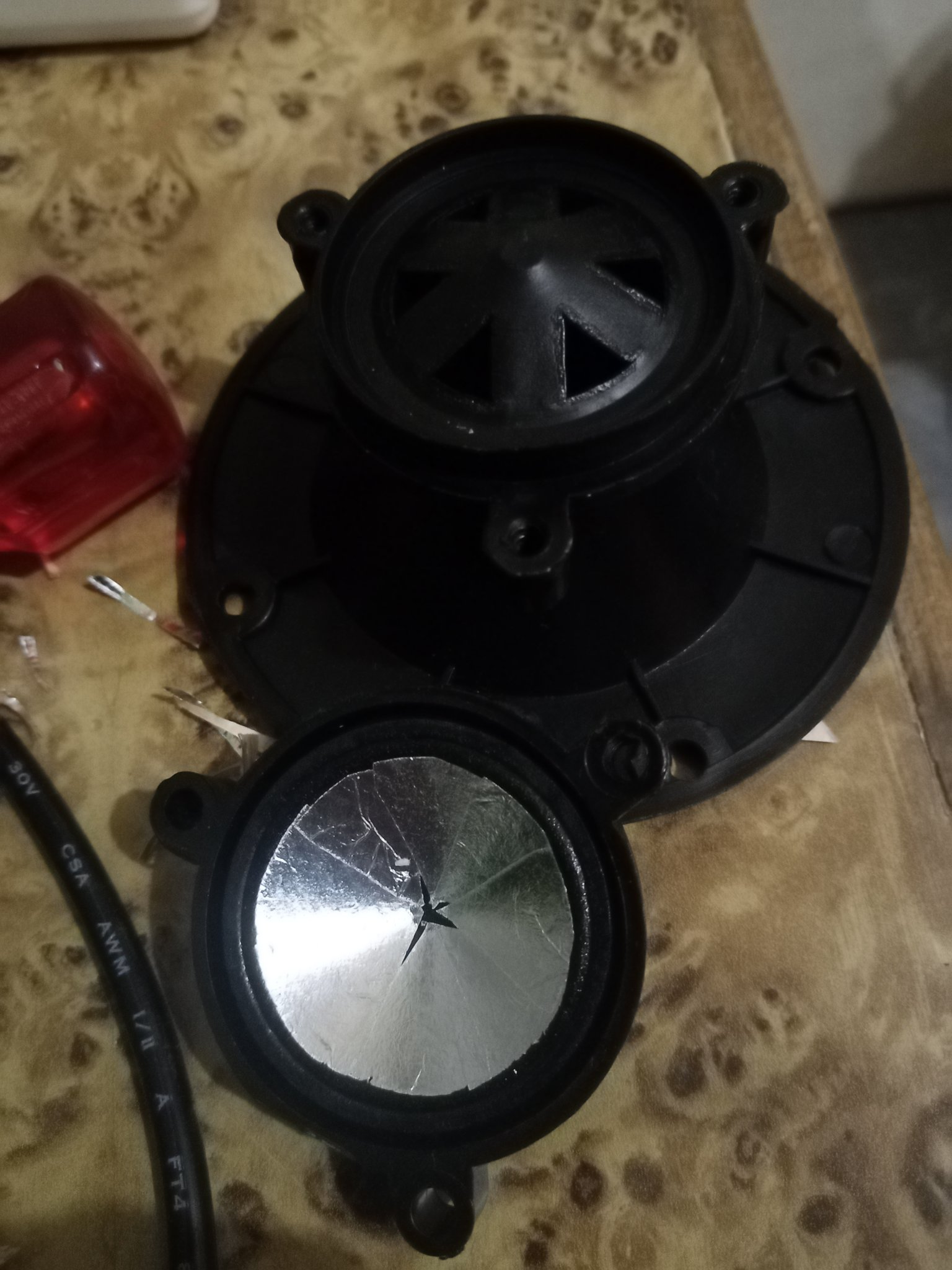

In former times I used to dampen the back side and even putting a second layer of alu foil on the backside.
You have to unsolder the wiring for that gently putting the paper cone up/out without deforming it.
Today I do not proceed this time investment which certainly would help the sound.
Maybe drilling holes into the back chamber for accessing it for damping is an easier process.
