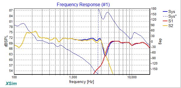

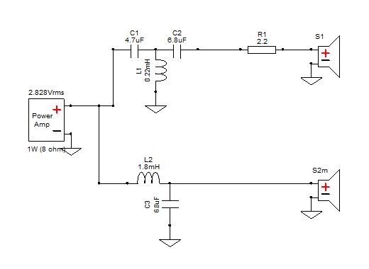

Try replacing the 6.8uF in the bass circuit with 4.7uF or 3.3uF. Might fill the hole and take the crossover higher. Still not convinced by that tweeter frequency response. Just looks wrong.

If you will bear with me in regards to this crossover, my new tweeter shud be here either today or tomorrow, im going to take new measurements using that and see if its easier to work with, ill post my first attempt on here for critique, ill also take off axis measurements too, just to really see whats going on. Could be thursday or friday when i upload the results though.
Can you just advice me as to why the inductor needs to be larger on the tweeter than i originally had? Will it burn out being that small or something?

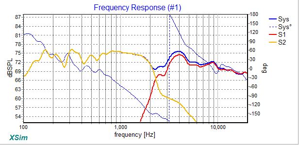

My tweeter is only coming tomorrow, but i just have a quick question, when i do the measurements on it should i use the bass removed sine sweep? I havent used that in the past because i need to test both the woofers and the tweeter playing together in which case ill have to play the normal sweep during that test. But for the tweeters alone frd file should i be using bass removed? Im wondering if that could be the cause of the tweeter response acting a bit wierd in the simulations? I dont use a cap on it as i was told 90db wont hurt the tweeter, im just curious about the method ive been using
So ive taken loads of measurements tonight with my new tweeter, on axis and one on 15,30,45,60,75,and 90 degrees, it actually has a flat response off axis when just running the pc83 drivers, which surprised me. But after taking those measurements ive had a quick attempt on xsim as i was curious how the new tweeter would react. Please tell me this attempt is better than my last, im at my witts end with it now.
The tweeter is a nd25fb-4

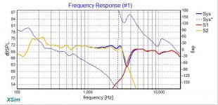

... Please tell me this attempt is better than my last, im at my witts end with it now...

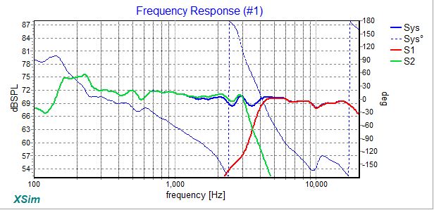

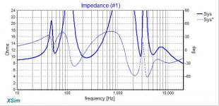

i dont know how to tell by using the phase lines
It's fairly easy to assess phase from the phase plots. Why don't you try it once, for a change?

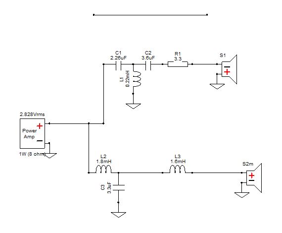

I think you are pretty much done here:
All looks OK to me, though you might need a bit more tweeter attenuation in reality, since the fullrangers are only around 85dB. Phase must be OK with a 6dB gain at crossover. That second coil on the bass filter is usually bypassed with about 8 ohms. In practice you use preferred values like 2.2uF and 3.3uF. Cheaper.
I think you have learned a lot and have arrived at a nice workable crossover. You like how it sounds and it measures well. A lot of folks who have deep crossover knowledge and experience could have come up with something very similar much quicker. An expert could also probably tweak it it be flatter or perhaps use fewer or more "optimum" parts. I personally have designed only a couple of speakers that have as nice a reverse null as your design. I'm, at best, fair at crossover design and sitll have a lot to learn, but to be able to design and build a nice, if not great, sounding speaker is quite an accomplishment, IMHO.

I don't think you'll go far wrong.
I've been doing crossovers and filters for audio and radio for 45 years, so have a vague hold on what we try to do:
Your effort looks OK:
My own hobby efforts get to the same place:
But until you plug them in, all is uncertain.
