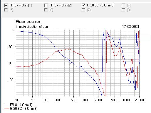

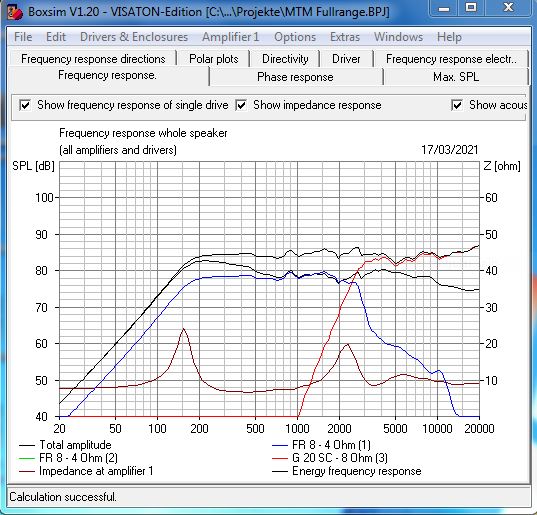

I use this Visaton simulator:
Software | Visaton
It is very intuitive and phase and acoustic centre is easy to understand.
Restoring Monitor Audio R300 bookshelf speakers.
You can also import existing designs into the projekte folder in two minutes flat.
2 Wege – Boxsim Projektdatenbank
You can also import other manufacturers FRD and ZMA files with some effort, but its often hard to know how they were measured. As it is I just muddle along with Visaton's range of drivers, which aren't much different from everbody elses. And Visaton have already done the measuring for you.

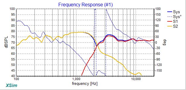

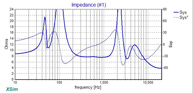

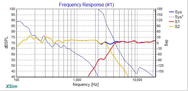

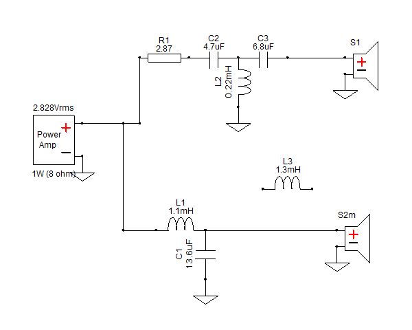

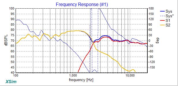

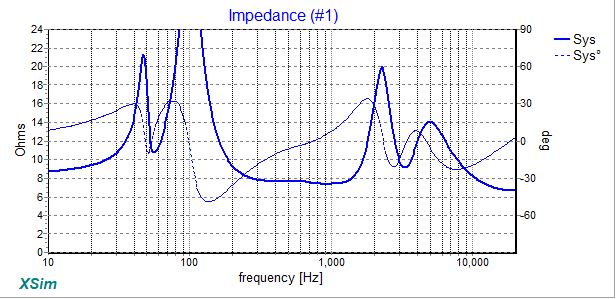

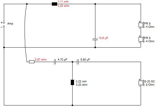

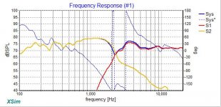

My crossover parts came today, i set everything up and took some measurements, quite happy with the results, also played some music and i cant believe the difference now from the pc83 drivers playing alone, its like someone turned on the light, the amount of detail you can see in the songs now is exactly what i was after. the impedance ended up at just under 10ohms, which is making me think i should have done this build with the woofers in parallel instead, id have got almost the same spl as the tweeter too so overall it would have been a better choice for volume i think, but then again my av receiver could have struggled if i hadnt managed to get the systems impedance up to 6ohms. But oh well, live and learn i guess. I swapped out the 4ohm resistor on the tweeter for an 8ohm as the first test came out around 6db higher on the treble end, @system7 was right about the tweeter still being slightly higher than the woofers, (not sure how you could have known that 😕) but anyways heres the graph of the simulated response in blue, the actual measurement of the finished speaker with the higher resistor value is in red

This is unreadable. If you want to start using proper punctuation and capitalization I might be interested in hearing about what you are doing and have to say.
But without that I won't waste my time trying to understand it. Others may put up with it, but you've lost any interest I may have had.
