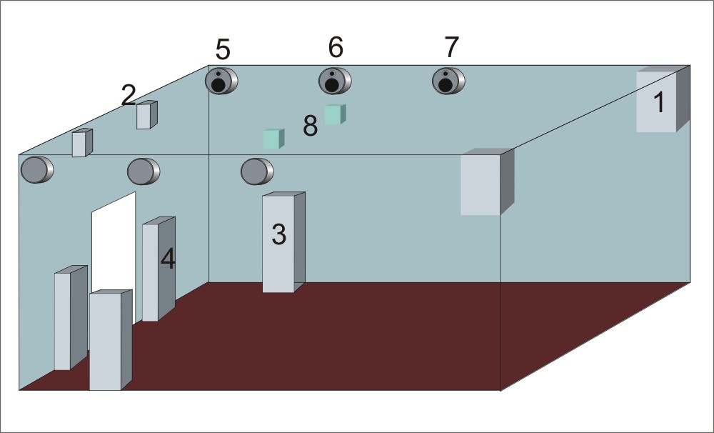

I carpeted the floor and walls of our media room.
http://www.diyaudio.com/forums/attachment.php?s=&postid=1421820&stamp=1202345103
I may add a 6 foot wide band of sound absorbing pannels above and moslty in front of the mains. But the room is very dead as is.
At present I am using the Carver C9 for ICC cancellation. It is working very well considering the TV. It will be replaced next year with one that can be placed against the wall and some time this year the Mrs. has agreed to removing the TV so I can play with Ambiophonics
And I'm in the process of adding ambience channels as shown below. Pairs 1 and 2 are in place and get signal from a Yamaha DSP-100U. Pairs 3 and 4 are fed from a Rotel RSP-1066. It has a good number of music settings that feed the surrounds. All of them degrade clarity and imaging when the level are set so that they work for 5.1. One is usable if I reduce the volume of the surrounds—has to be done manually. I have the drivers for pairs 5, 6, and 7 and am about to build the cabinets for those. Overhead and slightly ahead of the sweet spot there will be at least two channels, 8
I plan to feed the ambience and probably surround speakers from a collection of midi controlled reverb processors. The DSP-100U will likely be retained as is. The positions of pairs 1 and 2 are fixed the others are flexible. I’m sure I will be looking for help when I start working out the settings for the ‘verbs. The DSP-100U has 4 settings that are usable with the kind of music I listen to so I will need four “matching” sets of parameters for the verbs. At present I’d be grateful for y’alls reflections on the position of the ambience channels.

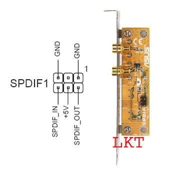

Could you point me to an spdif receiver and transceiver that I could buy for this application? I don´t know what these things are.
Do i need two independent 5v power supplies (for analog and digital), or one for both?
Common PS does it, you don't need clean power for the on-chip dac, but as far as i remember even if you don't use it, you need the analog PS.poldus said:fcserei,
Could you point me to an spdif receiver and transceiver that I could buy for this application? I don´t know what these things are.![]()
I was thinking about cs8404/cs8414 or similar transceivers.

I already ordered a pair of receiver boards, not expensive at all with the current dollar, so I won´t necesarily be pulling my hair in anger if things don´t work out as expected.
Here is a layout. How do I connect these to the yss901? 😕 http://www.twistedpearaudio.com/images/opus2/wm8804_layout.jpg
