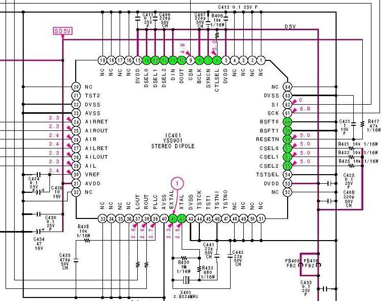

searc for SDM-N50 schematics on google and the first one is a free russian site.
Attached the relevant part. Marked the legs with green dots which might need attention:
DSEL - to set the digital input format. You gave to lift leg12 and ground it for connecting to the pana. leave 13 and 14. DSEL2 selects the digital input mode, DSEL0 and 1 the format.
DIN - input data from the panasonic
DOUT - output data to the pana - needs one BCLK delay
BCLK - tied together with EXTAL: SCLK from the pana
SYNCN - LRCK from the pana, needs deley, I'll check it later
CTSEL - don't lift it, just ground it
BSFT - necessary bitshift depends on the angle you select with CSEL. For experiments lift it and put it on 2 switches to be able to select 0V and 5V individually.
RESET - you can leave it, or tie it to the pana reset
CSEL - to set the dipole angle. They are on a pull up resistor, so just connect the proper leg to GND for configuring.
EXTAL - lift the leg and connect to the SCLK from the pana
XTAL - lift the leg, and leave empty

facserei: I need to resort to your expertise and guidance once more in order to get rid of my physical xtc barrier.
I finally took the plunge and bought (well, I´m currently bidding on one on ebay) a sony mediabox to use its yss901 as a crosstalk canceller.
I have been revisiting your past posts on this endeavour, and downloaded the sony mediabox circuit esquematics as well as a yss901 esquematic from yamaha.
I would like to use the digital input and output on the chip. The center channel mixdown issue is not a problem since I will use it only on cd´s, not multichannel material.
You described how to hook it up inside a panasonic receiver but, can it be used as an external box between the cd player and the yamaha ax1, I mean, without accesing the inside of the ax1?
If the answer is negative I could maybe try and hook it inside my jvc xpa, which I believe you have already done.
