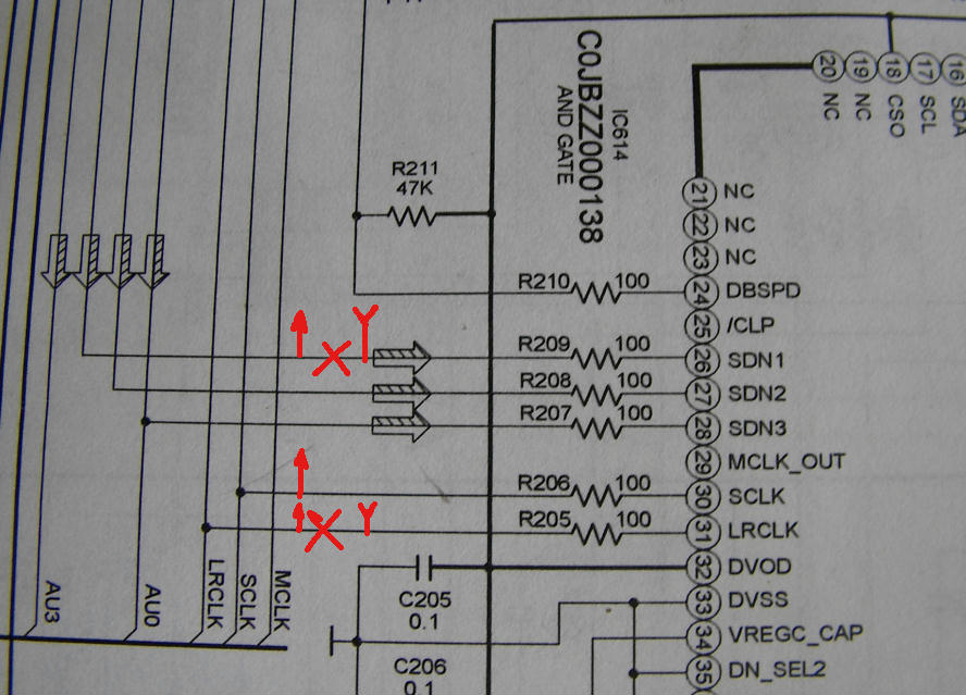

Some details:
First the panasonic xr-25/45. The big chip on the right is the 6 channel TI equibit modulator on the main amp board. You will ned to cut the traces at the red X, and the necessary signals and the flow is marked with an arrow:
Also the +5V, Gnd and reset signals are coming from this board.

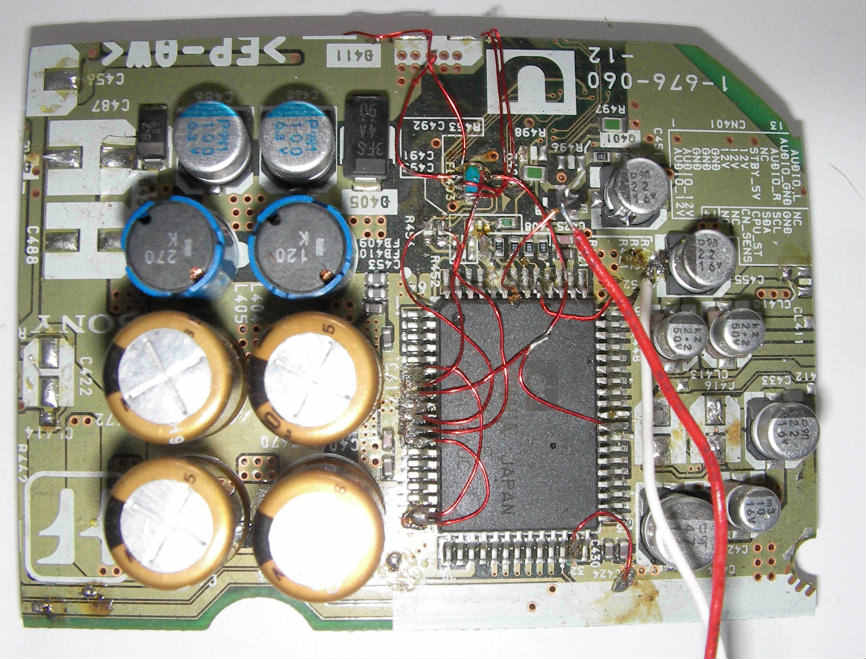

The 901 board preparation:
I found it best to cut the board small to include only the necessary part. If you leave the board as it is, you have to remove the PS parts, because they are very noisy.
On this board you will have to lift a couple of legs of the 901 chip, because the trace is inaccessible in any other way. To connect to the panasonic, I've used the original CN402 connector. It has all the power connections, and enough free legs to accommodate the necessary signals.

I think I'm in way over my head. I'm not even sure what questions to ask. I guess the first would be: have you chosen to connect to legs in some places and traces in others just for convenience? Is it possible to make a sketch of your circuit including which legs and traces are used so I know what goes where?
One thing that´s keeping me from attempting this route right now (other than the technical difficulty) is the fact that sacd would suffer a/d-d/a conversion. Fcserei could explain wether the convenience of ditching the physical barrier offsets the potential loss in sound quality when using analog inputs. If it does then I might consider it. Also, using the creative 2000 board might be easier to implement for the non digital-savvy?
These are the leg numbers on the chip showing the connections that I think are clear in the picture and the ones that are not. Please confirm or correct whatever is wrong.
6----12----19 (or 18 or both 18 & 19?)
7----out
8-----41----out
10---out
11----(out?)
31---out
56---out
(59?)----out
