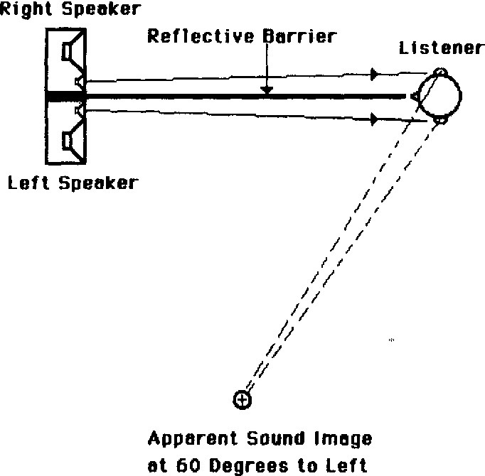

I've done it various ways, and a plain ol' barrier works pretty darn well. I've done two different setups using a barrier, over the past year or so, and my current set up uses a barrier. I'm just using a sheet of plywood that's covered in Bubos Acoustic Panels.

The barrier separates a pair of JBL center channel speakers. The JBL speakers are particularly directional on the horizontal axis
I covered the barrier in Bubos sound absorbers (I still need to buy more.)
On my previous setup I had the barrier go nearly all the way down to my desk. You'd think it would be distracting, but surprisingly it's not, especially if you sit exactly equidistant.
It's interesting how the sound stage gets better and better as it gets closer to your face; a gap of even two or three inches is audibly worse than having it come all the way to my face.

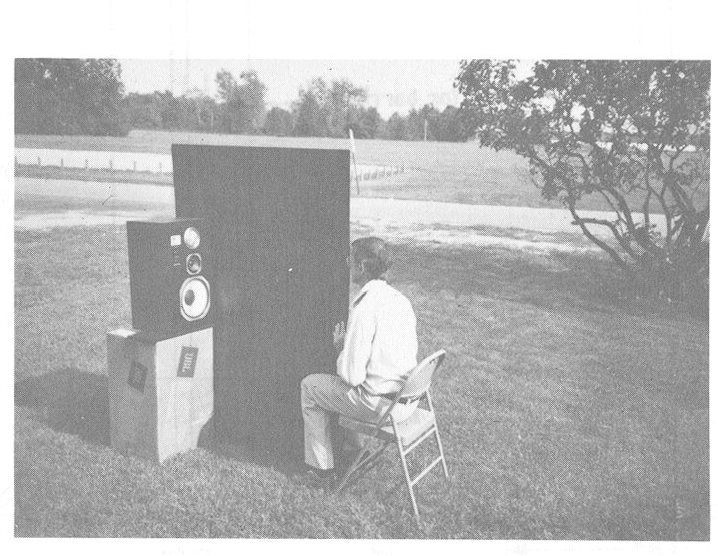

the picture below is an old one, barrier, no software.
When I did a big long barrier, down the middle of the room, the voices were locked and solid in the middle 10' away.
Knock down the barrier, the center image seemed 6db down 3' wide hazy hazy blob.
But, obviously, the giant barrier was an utter pita, and forget watching movies also..............

What intrigues me is I found the graphs roughly backing up what I heard.
With baffle 10' away, the image size (with the barrier), voices were as point source as someone talking.
But good luck with the barrier, no juke-box awesome sound everywhere, no flopping on the couch, and no having tunes while playing vids or poking around the internet on your tablet...................

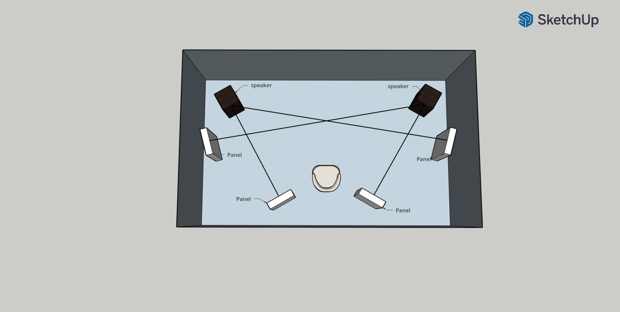

Over the last few days I did an experiment in my room where I used 2' x 4' panels placed on the walls at angles to redirect the early reflection sound away from me and back toward the speaker of origin, including across the room reflections that go across the head from the wrong direction. I was surprised at how much this added to the stereo effect, coming close to what I hear with a physical barrier up to the face, or digital XTC.
My concern was mostly with the cross room reflections, which add to inter-aural crosstalk. How much effect do these reflections have on our stereo perception compared to the direct sound from the speakers? It seems quite a lot. So even if you don't run a barrier right up to your face, just keeping reflections from the left and right speaker mostly coming from their corresponding side of the room seems to have a significant effect with helping your brain to sort out the initial crosstalk. A big physical barrier goes a long ways to keeping the left and right sound mostly on the correct side of the room, so that may be one big reason I've preferred it so far over other methods.
Could you add a drawing please? How are the speakers toed-in and placed relative to walls corners etc.? I've confirmed that a center-line barrier helped a lot in a very tight space, and that speakers could be fired directly toward walls or reflector boards for stereo.

Here's a basic render. The speakers are actually toed-in about 45 degrees and in the corners. They're big corner horns so pretty directional so I'm not treating for the reflections directly adjacent to the speakers. Those panels that are close to each speaker are actually for the opposite speaker's first reflection on the side wall. The panels flanking my chair are most important.
I just set it back up and discovered that it's important to get the panels positioned accurately to make sure the paths from the first reflection points on the walls are actually getting blocked and redirected. Somehow on this 2nd setup I'm not seeming to get as strong an effect. Maybe it's just my ears tonight but some of the sound wrapping around me doesn't seem to be happening this time to quite such an extent.
Edit: I just discovered the secret sauce I forgot about - got to catch the ceiling reflection too! There's one straight back to the wall, but also one that goes up to the ceiliing, back down to the wall, and then back down to my head, which means it bypasses the panels sitting on the floor.
