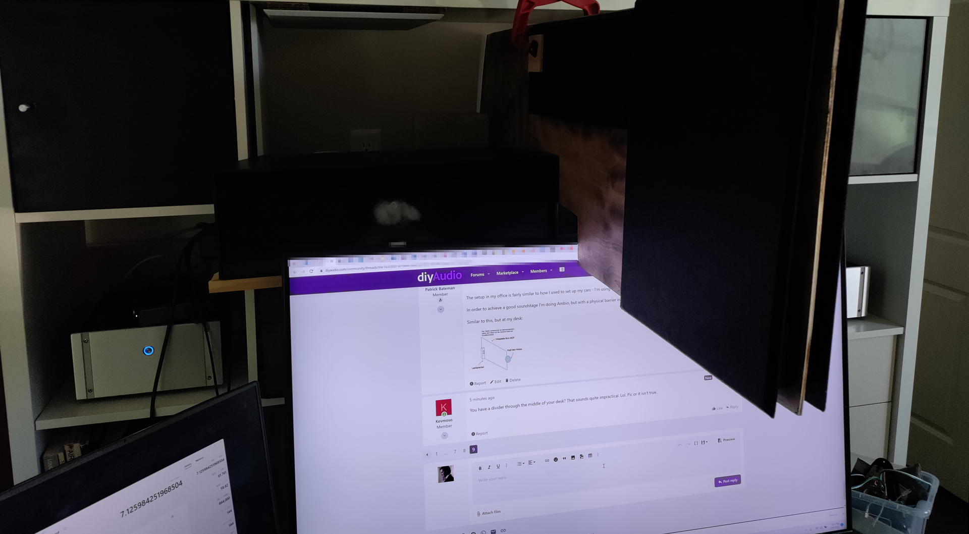

here's my ambio setup
The barrier separates a pair of JBL center channel speakers. The JBL speakers are particularly directional on the horizontal axis
I covered the barrier in Bubos sound absorbers (I still need to buy more.)
On my previous setup I had the barrier go nearly all the way down to my desk. You'd think it would be distracting, but surprisingly it's not, especially if you sit exactly equidistant.
It's interesting how the sound stage gets better and better as it gets closer to your face; a gap of even two or three inches is audibly worse than having it come all the way to my face.
