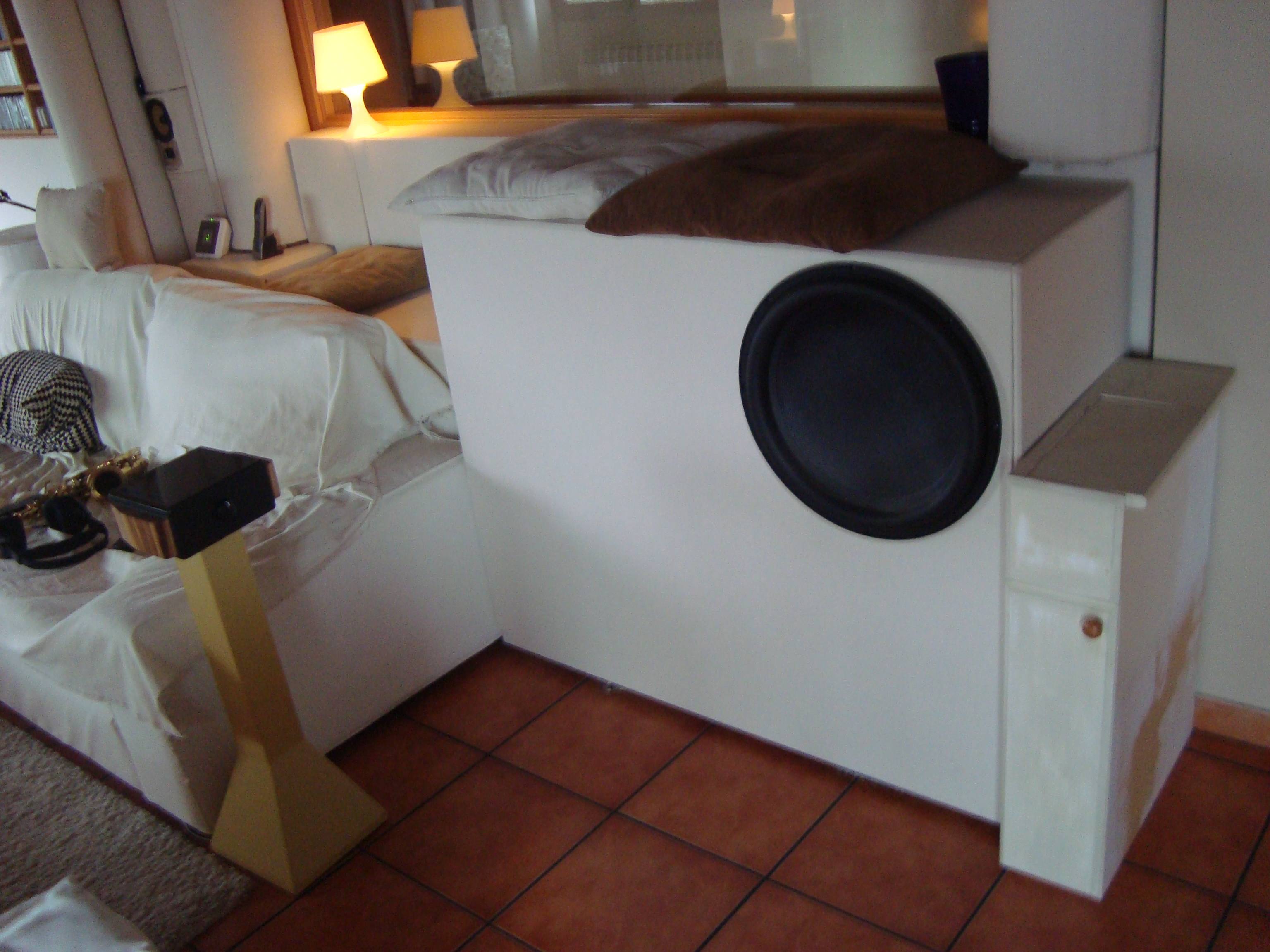

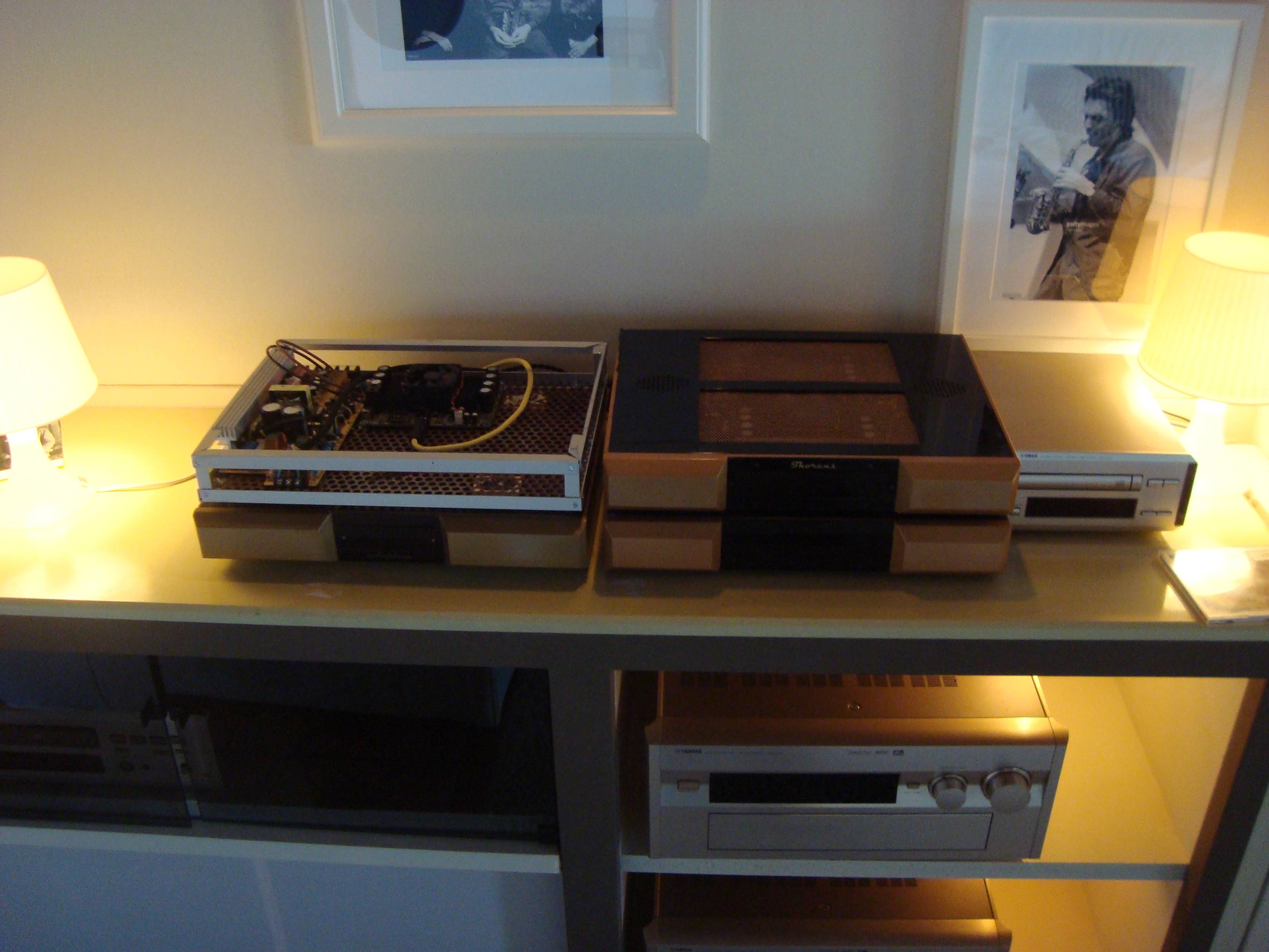

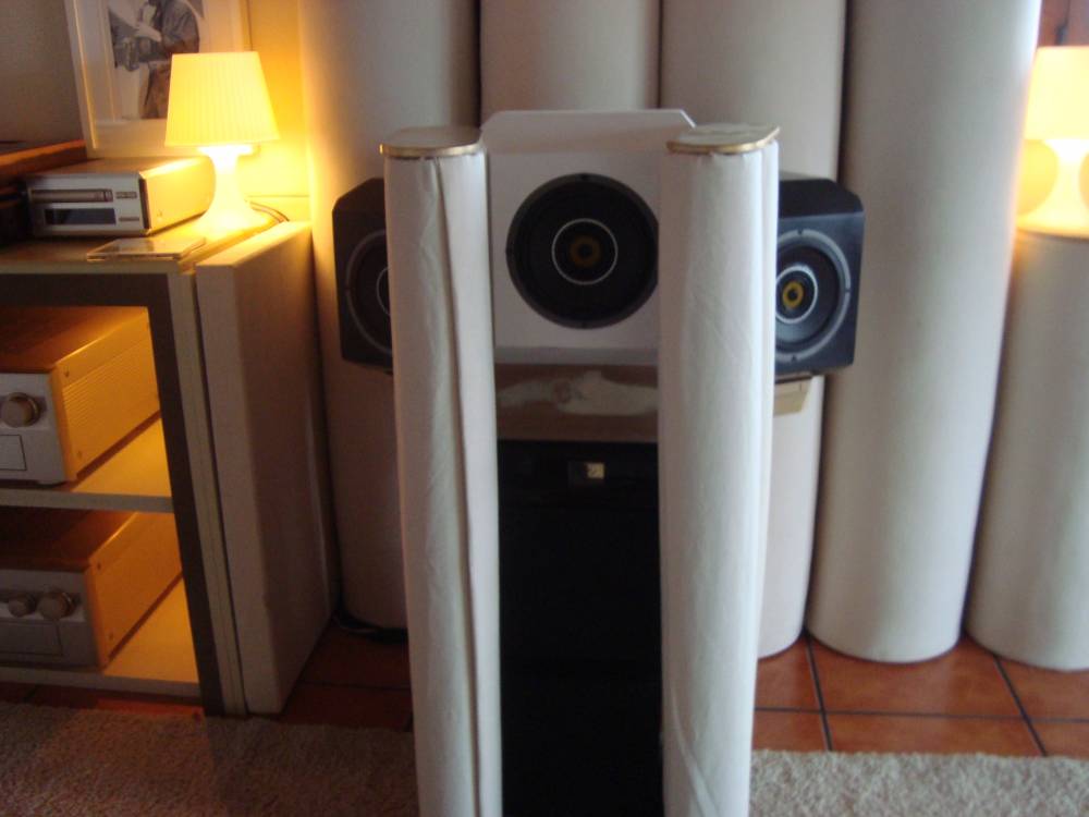

David asked me about my current system and I could not attach the photos in the pm, so here they go:

The center speaker is only used for movies as a dialogue center channel. The side speakers go through a miniambio with recursion level on the soft side.
The point source speakers and the extended lows from the subwoofer help to the overall effect.

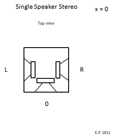

graaf: are you still using this SSS? How is (or was) the wiring in the box done and how the whole setup from source to SSS looks like?
...same question to Poldus
IIRC the SSS wiring is explained in Elias Pekonen's threads and on his website: http://elias.altervista.org/html/SingleSpeakerStereo.html
for my part I had used only pure bipolar L-R, no center channel, eventually toed-out 90 degrees to the sides and no barrier, and no ambio algorithms - those were mainly pre-computer audio days, at least for me
I don' use it anymore - it was physically incompatible with a TV setup for watching movies - one needs two speakers symmetrically to the TV set, not one in front of it
