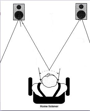

without barrier and speakers facing the listener 0º or close , with more distance between the speaker L and R , wont you get similar resaults without changing the original sound ?
Sorry, I don't understand exactly what speaker-listener position you are refferring to. The picture you posted shows a standard triangle.

the picture is the std triangle but with speakers facing you and not tilted 60º like everyone does , also the idea is to have the speakers more separated to improve stereo perception

So you are talking about using electronic cancellation with those speaker
positions, or no cancellation?
With cancellation the speakers are too far apart for it to work, at least for my ears. Without, well it is nothing but one among the miriad minimal tweaks one can possibly make to a standard stereo triangle. I cannot comment because I have not listened to one in eight years or so.

Iduarte1973, turning the speakers outwards does increase xtc, but not nearly enough with "normal" loudspeakers.
Sound engineers in recording studios mix for conventional stereophonics because most people do there listening in cars or on there tv's, I hope that one day they just make binaural recordings as more and more people use headphones and watch content on there tablets. Could you imagine a horror flick done binaurally?
In the position that you suggest, you would need very tightly controlled polar response. Something like very long horns for the high's "living voice" flagship speaker, coupled with a second order gradient system for the mids and lows.
The problem with this configuration is that there will be such a strong beam of sound coming off the back wall, it will ruin imaging anyway. I suppose you could use it outside, where there is no back wall.
All said and done, this system will still be unsatisfying compared to ambiophonics.
