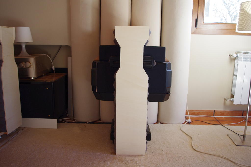

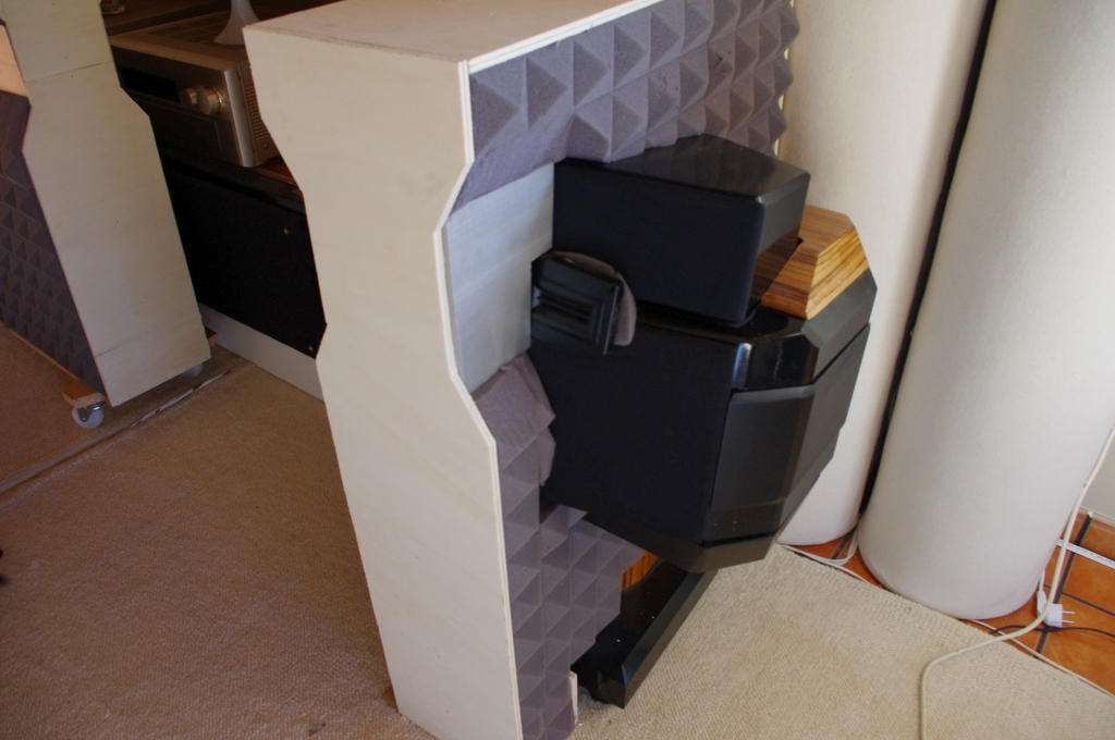

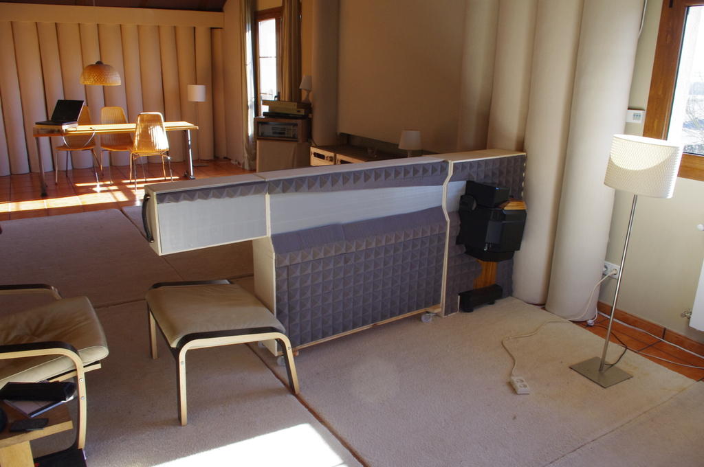

I am no longer using electronic xtalk cancellation. Back to the good old barrier. This one on wheels and offering as good a size/performance ratio as I could come up with. I add some foam panels on top for music but not for movies ( it would block the screen and besides it is not really necessary).
A more detailed view. The flat portion by the tweeter is styrofoam. It lets the higher frequencies reach the ear.Any really absorbing material (such as the pyramid foam used elsewhere in this barrier) was placed in the path from tweeter to ear the highs would be gone.
Direct sound at higher freq.s.. is that necessarily a good thing (depending on the freq.)? 😉

For freq.s above 3.5 kHz I'm starting to think that *non* direct sound is preferable - where you can't "lock onto" the increasing pressure gradient of the tweeter. This suggests a physical barrier between tweeter and the listener. Still, doing that will lower the spl at those freq.s when compared to the average (for the listener) - so it's likely that the tweeter will need some added gain to compensate. Perhaps the loss in pressure is why poldus still finds that direct sound from the tweeters provides the best overall experience?
As for a barrier..
While it can provide for increased separation at higher freq.s (depending on absorption) - it's not going to do much for most of the midrange.
To me the barrier format is every bit as flawed (both conceptually and in practice) as the standard radiation pattern of most loudspeakers. (i.e. directive higher in freq. and non-directive at lower freq.s).
It's true barrier loses its effectiveness with increasing wavelength. However it does work in the dominant freq range of spatial hearing, which is the key and the reason why it works at all. High freqs appears to overrule low freqs in directional perception. Even if contradicting cues of high and low freqs are present, high freqs win and determine the perceived image. This is my experience.

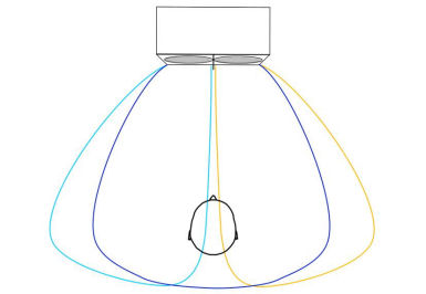

As I understand the two most characteristic features of Ambiophonics are:
1) Centrally in front located sound sources (speakers)
2) Cross talk cancelling
Everyone by now knows it sounds good 😉 so how do these two features help in it ?
1) For most of the available recordings the major portion of the sounds are mixed or recorded by a mic in the central front location. Then it makes sense to put a speakers there where most sound should be coming from and by doing so it creates least of spatial error.
2) By removing the cross talk there will be no comb filtering interference field in the listening position, which in conventional stereo triangle destroys the stereo illusion if head is moved or turned. Ambiophonics do not suffer from this to the same extent.

Still, the sofa pillow is too large (though it should make the overall spl more uniform as a result). It's size is covering a MUCH lower bandwidth than strictly above 3.5 kHz. 😉
I think perhaps a better method for above 3.5 kHz is a return to the acoustic lens. 😉
The L/R barrier doesn't work effectively at low enough freq.s.. It should ideally work all the way down to DC, but even as a "compromise" should extend to 200 Hz or so. Most barriers are working no lower than the average head-shading range.
Hi poldus,
Did you also try the barrier method with the speakers at ±30° like in a conventional stereo setup?
It only produces a small soundstage at frequencies that pinna localization is dominate. This is why I'm convinced that the speakers should be placed at +-15 degrees, an average of conventional and mono. If they are placed too close together, treble comes from the middle and all other frequencies come from the sides. If they are spread too far apart, there are no pinna cues from straight forward. ( I only set R.A.C.E. For a 90 degree spread. ) I think this is where R.A.C.E. is superior to a barrier, where as you can control the amount of spread.
Markus: yes, I did. But it did not sound good.Did you also try the barrier method with the speakers at ±30° like in a conventional stereo setup?
MeloTheory: Ambiop. sounds best to me with speakers as close together as phyisically possible. In my experience so far, a barrier succeeds in moving the highs to the sides, while electronic cancellation does not pull the trick convincingly enough.If they are placed too close together, treble comes from the middle and all other frequencies come from the sides.
What was the difference?
