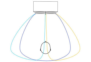

Here again the conceptual nearfield radiation pattern.
Basically it's a MS (mid side) stereo loudspeaker, but cross talk is cancelled at the near field center line.
In the pic the signals are:
Dark blue = L + R
Light blue = L - R
Yellow = R - L
When these sum at the listening position, left ear gets L and right ear gets R stereo signals, thus cross talk is cancelled.
