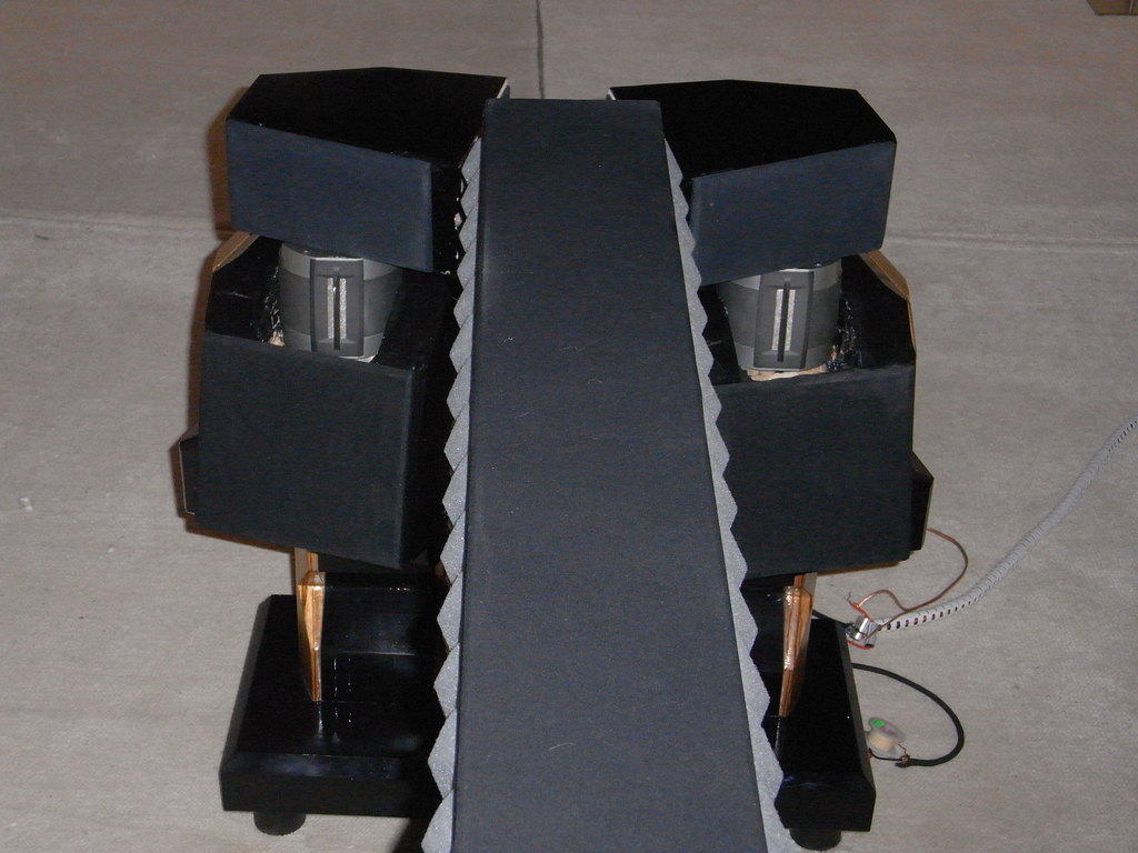

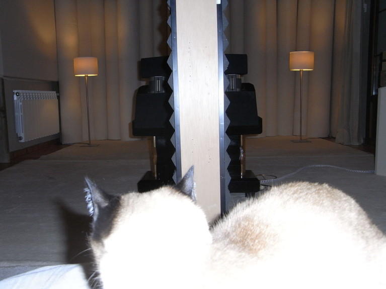

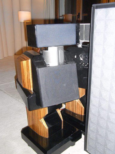

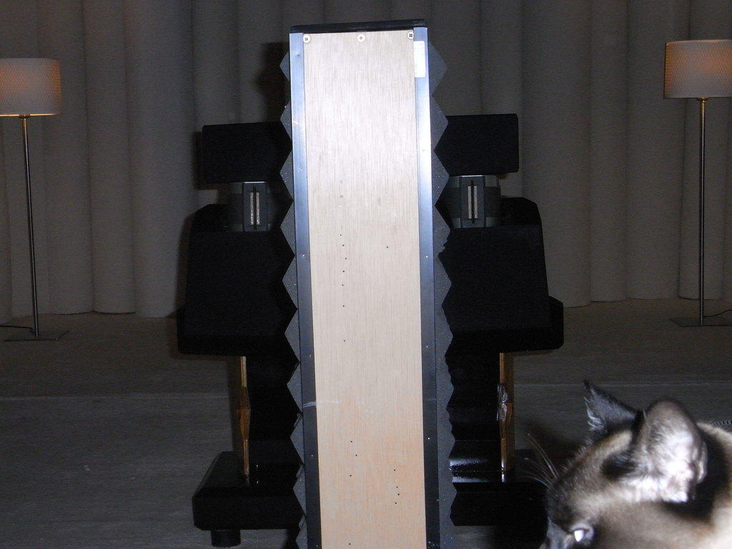

I stripped the barrier to a bare minimum and it works really well. It´s got my cat´s golden ears´ approval. Settings are 20 us delay and no recursion whatsoever. Speakers toed out except for the tweeters (or supertweeters since they`re crossed very high)
One more impressed guy here.
Combinating the mechanical and software cancellations is a great idea, and finally it's not that intrusive. How long is your barrier ?

The barrier is merely 1 meter long.Combinating the mechanical and software cancellations is a great idea, and finally it's not that intrusive. How long is your barrier
