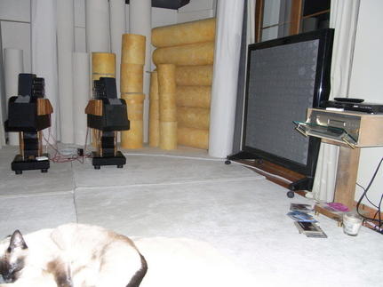

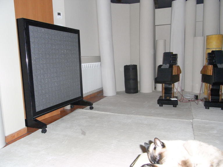

Interestingly, I have come to experience the importance of dispersion since I moved to a house with a much bigger listening room which I treated with a lot of absorption and bass traps.
While my system had sounded fabulous in my old apartment it was awful now (this is before the crosstalk cancelling software so I was still using a huge physical barrier). To my knowledge the problem would have existed all the same were I listening in standard stereo.
So it happens the characteristics of the new listening space rendered my speaker configuration (diy active 4 way) useless on account of the high frequency dispersion. The problem is now solved after adding tweeters looking in slightly different directions.
It sure has been giving me a bit of a headache until I found the answer, but hey, now I know first hand that a system that sounds excellent in one place is going to sound wrong in a different place.

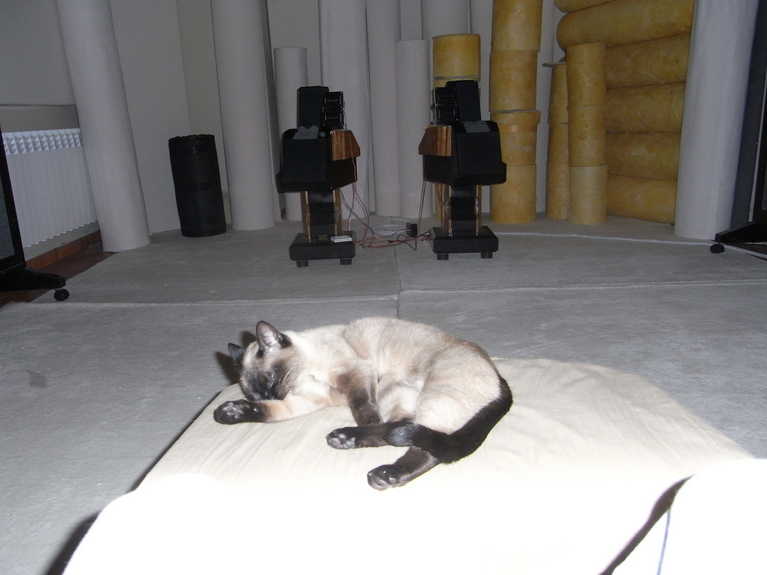

I have been posting on the ambio4you thread but thought that this, the original ambiophonic thread, deserves an update on my latest findings on my ambiophonic search.
I finally have a sound that is very much as the one I remember from my physical barrier times and which I had not been able to replicate so far. Only, this time there is no barrier and no need for a computer either, by virtue of this little Ambio4you device.
A couple years ago I would have taken the idea of this ever happening with a grain of salt.
My speakers are toed out quite a bit and facing some absorptive panels. Without this the sound was not quite there.

Yes, there is a lot of absorption. I´m kind of obssesed with it. The more I use the better it sounds to me. However, I´ve had problems with unsatisfactory sound until toeing the speakers out a lot. Maybe on account of the different frequency content in direct as compared to reflected sound witch the toeing out evened out.
what I 'like' about half of your absorption is that it is (still) raw f/glass....just like mine haha. I'm lazy you see, and it was just an experiment at the time.
It worked so well they are still hanging raw on the walls a few years later.
You mostly using pipe insulation?? Dunno about your neck of the woods, but that is soooo expensive here.
What are the flat 'electrostat looking' things at the first reflection points?? And it looks like a temporary arrangement, carpet looks like it is just 'sitting' on the floor for example.
I use a deqx (and a very crappy dvd as a transport) which takes digital in of course. So my desire for digital input is more based on avoiding what I suspect would be a poor analog out from the cheap dvd player, back to digital for the deqx stuff, then another analog out....rather than using it with mini dsp as such. same sort of deal tho.
Terry, pipe insulation is very expensive in Europe as well. I have been waiting till I got close to a satisfactory sound before aiming for nice decor and an acceptable finish on all those absorptive materials. I sure don´t want to see raw insulation before me as I enjoy music.
There is lots of standard flat fiberglass lining on the walls and ceiling only you don´t see it in the photos since they´re upholstered with beige fabric same color as the paint I used on the walls.
I have been moving the speakers and stuff around endlessly for two years now. The ESL looking panels are just absorptive panels on wheels as used in studios. They´re diy.
