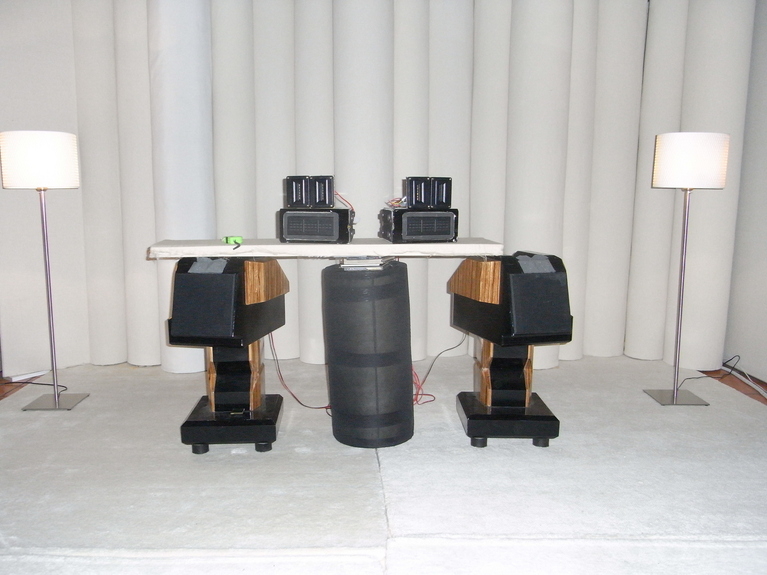

I used a huge physical barrier with specific dimensions plus room treatment and speaker equalization that were the result of a lot of experimentation over the years. It is also true that the first time I put my spekers next to each other and extended some absorbing material between them and my listening chair I realized I would not return to regular stereo.

In the mechanical ways of obtaining XTC, the physical barrier remains the easiest solution. But (for sure it has been said before, just I feel lazy to read all the thread), many experimenters do the mistake of putting the barrier only between the speakers : it has to be between the ears first. Can say that it's real duty is to change the HRTF by improving the shadowing effect of the head, then isolating one ear from the controlateral speaker beam.
Keele (again...) has been drawing something nice: a kind of rooster crest to put on the head. Very easy to do, I've tried it and it works, but it's hard to live with.
Yeah, that'd be the major problem 🙁
I've read the papers you gave me. When I saw the drawings, I thought to myself, OMG, is there anyone really doing this ?!
So you must be crazy enough 😀

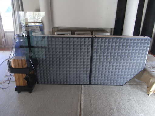

A combination of both software cancellation plus physical barrier is what I am currently using. I´ll explain:
Current software cannot seem to safactorily cancell the higher frequencies. On the other hand, a physical barrier cannot cancel the lower range (around 400hz or so) as effectively as software can.
So you set up your software for mild cancellation (it is effective down the range and keeps the higher frequencies clear and pure, no artifacts to be heard) and put together a barrier. Result: you still have a barrier in your room but you have by far the best sound you have ever heard in a playback system.
The pics show the lower part of the barrier. The top will be removable. Total height will be 160cms or so.
