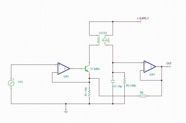

Attached is a block schematic of a simple CFB amp.
The input VCCS supplies a current (10mA/V in this case) to a current mirror.
The current mirror is loaded by a network that defines the OL performance (x1000 at dc, rolling off because of the capacitor). The voltage across this network is buffered to drive the output.
An external NFB network defines the CL performance.
This is what I think of as CFB these days.

Yes it is!!Ouroboros said:Attached is a block schematic of a simple CFB amp.
Here we have a current feedback voltage amplifier.
But if you put a resistor say 1 Ohms for a 8 Ohms load in series with the load...and you take the feedback point from the resistor ...now we have a current feedback current amplifier!!
The schematic you post is very similar to the Pionneer Wide Range Linear Circuit in the essencial!

you can set the gain and bandwidth independently of each other
for a CFB amp and that it is Rf alone that sets the bandwidth.
As is stressed in the Intersil app. note, this claim assumes that
the output impedance is much lower than the value of Rg, which
is also clear from the equations.
CFB amps are very interesting, but also more difficult to analyze
than VFB ones, I think.

Don't agree. There is a clear way to differentiate between the two. If you disconnect your load, and the feedback signal goes to zero, that's current feedback (load current > zero, feedback > zero). If, on the other hand, you short the load, and the feedback goes to zero, that's voltage feedback (load voltage > zero, feedback > zero). You are right that I and V are related, but they ARE different. Otherwise we could do with just one word like vurrent (or coltage).
Janneman,
We may be at cross purposes. I think you are talking about WHAT information is being fed back rather than HOW it is fed back. As such I agree.
But there is no need to create new terminology:
voltage -> voltage = voltage amp
voltage -> current = transconductance amp
current -> voltage = transimpedance amp
current -> current = current amp
I think the previous comments concerned whether the differentiator is fed a representation of the output as a voltage or as a current. IMO it is irrelevent, the difference is really about the impedance.
Peranders, I think that most people in this forum miss the point that a "normal" amp has voltage in, current out.I think most people here miss the fact that a "normal" amp has voltage in, voltage out
The new definition is more loose: low impedance node. What is low impedance node? Two connected emitter would be OK I guess? What if the two emitter currents are very low, impedance could go up to a k or so. What about amp_man's diagram with the 120 Ohms resistors? That still low impedance, or is it already drifting to VF? Again a lot of scope for discussions.
Well exactly. All practical amp's feedback signal(s) consists of BOTH voltage and current. It is the proportion of each that the misnomer "current feedback" is attempting to encapsulate. But the porportion of each is more accurately defined as the impedance.
And the impedance can be whatever you like. There aren't zero impedance differentiators or infinite impedance differentiators, except in the minds of our esteemed academic paper writers. You can easily make an inbetween amp circuit. And what would you call that!
IT IS THE INFORMATION CONTENT of the feedback that matters.
IMO this thread began as a discussion of the merrits of a high Z differentiator vs a low Z differentiator. Looking at the choice in this manner may lead to a more practical thread.
- True Current Feedback N-channel Mosfet Amp
