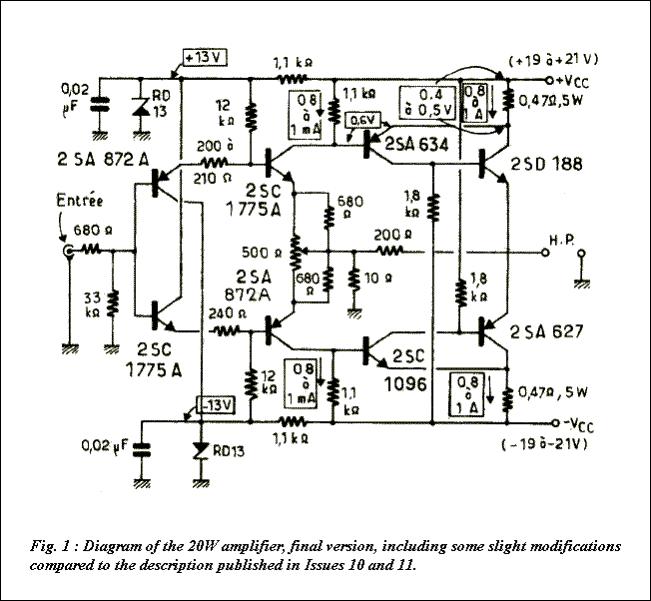

So, the definitions are confusing. Is it that if we put feedback to emitors, it automaticly "Current Feedback"
So, now Mr. Jean Hiraga is actually building a current feedback amp?

I see clear evidence that the feedback regime operates with the load disconnected. Gain is invariant whether load is connected or not. Ergo, it's voltage feedback, and furthermore there appears no combination of the two feedback modes.
I don't like the lack of a thermal compensation, and I'm fed up with animated bloody gifs.

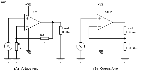

The Hiraga amp is as far as I can see current feedback in
the modern sense. The two schematics, a and b, that you
posted next illustrate voltage and current feedback in the
old sense.
As other examples, amp_mans amplifier is current feedback in
the modern sense. AKSAs recent post used current feedback
in the old sense.
I am not claiming either definition is right or wrong. They are
both logical in a sense. The old definition is current feedback
in the sense that the feedback is proportional to the load
current (and then we can feed back either an error voltage
or an error current). The modern definition is current feedback
in the sense that the output voltage is proportional to the
error current flowing in to/out from the negative input, ie. the
feedback input, (and then this current may be proportional
to either the voltage over the load or the load current). It is
unfortunate to have this clash of terminologies, but diyAudio
is hardly a standardizing organisation and I don't think we
would even be able to enforce our own forum standard on
terminology. I have personally decided to go along with the
modern terminology since that is how most people seem
to use it and is also consistent with how op amp manufacturers
use it. The question then is what to call voltage/current feedback
in the old sense. Voltage/current drive or voltage/current sense
seem appropriate, with a personal preference for the first of
these.
It should also be noted that while op amps are characterized
as voltage or current feedback in the modern sense, they
could not be classified as either in the old sense, since the
old definition relies on the feedback network arrangement
which is exterior to the op amp. A complete audio amplifier
on the other hand could be classified according to both
terminologies.

Christer,
It confuses me too. So, like you said, what will the "modern terminology" call the B schematic?
From its terminology, the feedback current is injected to the transistor (via emitors in this case). What if we use single differential pairs, not N+P transistor. How do you inject feedback to perform such as called "Current Feedback Amplifier"? Wouldn't it make us conclude to a funny conclusion, that it is "impossible" to make Current Feedback Amp with single differential?
lumanauw said:
Christer,
I don't if there is an agreed upon name for the B schematic.
According to the book Pjacobi referred to earlier it should
obviously be called current control. I have also seen people
refer to it as current drive, especially in the loudspeaker
forum.
As for the second question, differential pairs are used only
in VFB amps as far as I know. Maybe you could do some trick
to use it also in a CFB amp, but you would probably miss the
point of CFB then. The fundamental difference between VFB
and CFB lies in the very different types of input stage. A VFB
amp has two high-impedance inputs and outputs a voltage
proportional to the voltage difference between the inputs.
This is typically achieved by using a differential pair. A CFB
amp has a high-impedance positive input and a low-impedance
negative input (this is very important). As I explained earlier
in the thread (and this is very confusing when first encountering
this concept) the negative input is actually an output!! The
input stage is a buffer connected s.t. the positive input is
a high impedance input going into a unity gain buffer and
the negative input of the amplifier is the output of this buffer,
which has a low output impedance. This means that the input
stage tries to keep the negative input at the same voltage as
the positive input. Since the buffer does not have zero impedance,
it will not be able to keep exactly the same voltage so a current
will flow in or out through the negative input (ie. the buffer
output). The output voltage of the amplifier is proportional to
this current!!

The old current feedback = the feedback of the sensed current of the load.
Purpose could be to make sure that the current through the load will be proportional to the input voltage of the amp.
This is the case when the load is not purely resistive for instance.
Like in one of that schematics posted here, where a small resistor is connected between load and ground.
I learned that from Nelson 🙂 when I built my first dynamic current source, and I had to sense the load current and not the output voltage of the amp.
Christer,
We can certainly make so called CFB according to fig. B (old terminology) with single differential. But cannot make CFB according to (modern terminology) by using single differential. So if people ask you "Can you make CFB audio power amp with single differential?" what will be the answer?
