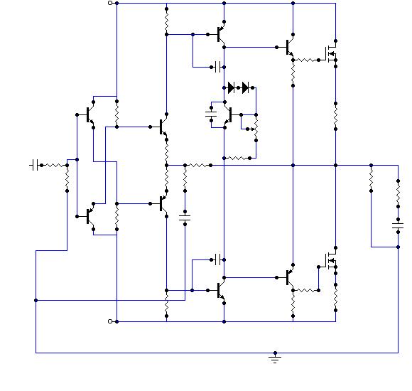

CFBamp REVISITED
This the updated version of CFBamp
Full detail will be posted until the final prototyping will completed!
NOTE:Some Diyers here, donot understand the concept of Current Feedback, therefore I request them to please update their knowledge.

Re: CFBamp REVISITED
I think you have trouble reading the posts of Christer and others, or maybe you didn't take the trouble to read them.
It is not the "some DIY don't understand etc". It seems you have the disadvantage of being new to this. CF is a term being used for many 10's of years, and means a feedback which is a measure of the (load) current. This was clear until some opamp manufacturers made opamps where the feedback is returned to a low-impedance node. Pressed by their marketing department, they used the term "current feedback"for this. Apparently, you are using this also, you may never have heard it in the original meaning.
That is all understandable, but I would hope you would refrain from telling other people that they don't understand things. As Christer said, yhere is a lot in this world that many of us, including you, are not even aware of. Some modesty goes a long way.
Jan Didden
Some comments on your amp: has this been built or only simulated, or only drawn? Why the large emitter resistors in the input stage? They make the feedback less effective and the performance worse. Why the low 5.6k at the input? Makes it harder for the preamp to give a good quality signal to the poweramp.
amp_man_1 said::NOTE:Some Diyers here, donot understand the concept of Current Feedback, therefore I request them to please update their knowledge.
Jan Didden

Hey jannemann u were wrong with the assumption that I neglect or doesnot pay attention to CHRISTER's posts. INFACT I think Christer understand my amplifier in much a better way from all of u.
Secondly,I have updated the amp and the portotype is completed in MATERIALISTIC REALITY , NOT IN VIRTUAL REALITY.
THe regret is only that I have no digital camera to take the photos and post them to show u.
THIRDLY, THE company named ACCUPHASE Labs has also used this type of current feedback topology in their amps such as PX-600E and take a look at their manual also.

MR. P-e-r-a-n-d-e-r-s SIR I have check ur schematic .
I think u wanna say that my amp is not a current feedback amp
CFB AMP REVISITED BY HEADPHONE AMP MANIAC
Re: Reply
I did not say you DID negelect to read Christers post, I said you either did not understand it or you did not read it. Since you now say you read it, the conclusion is clear.
Now you say you built the amp, but you already posted detailed specs (power, slew rate, THD) at your 2nd post. Since the diagrams you posted in posts 1, 2, 23, 45 have such a glaring stupid error that it would never work, I wonder maybe those specs only exist in your head? (If you haven't spotted it yet, let me know and I will explain it to you). In other words, I think you just lied.
Secondly, you irritate many of us and waste our bandwith with your neurotic use of smileys.
Thirdly, you accuse many of us of being too stupid to understand CF.
Are you planning more contributions to this forum?
Jan Didden
amp_man_1 said:Hey jannemann u were wrong with the assumption that I neglect or doesnot pay attention to CHRISTER's posts. INFACT I think Christer understand my amplifier in much a better way from all of u.
Jan Didden
Mr amp_man, you aren't so good in understanding, no? I said in my post that your amp is like mine which is a current feedback => Your amp is also a current feedback.
Mister, your amp is current feedback (of classical design also!) BUT some values of your parts aren't optimal.
1 You input feeds buzz from the supply voltage directly to the input
2 The emitter resistors of the input transistors have a strong influence of speed and stability(?). Should be as low as possible.
3 The feedback cap of 22 pF is a dead sin according to theory. Creates an unwanted peak.
Why don't you fool around with my simulation files and test!
Re: Reply
THIS WILL NOT WORK! Get serious man!
Jan Didden
amp_man_1 said:AS i HAVE already stated that i have updated the circuit take a look at this!
IF u think mine is Current Feedback amp then why all other diyers states that this is not a current feedback amp!
Jan Didden

performance of resistor vs simple current source vs
cascaded current source?
You can take my simulation and play!
- True Current Feedback N-channel Mosfet Amp
