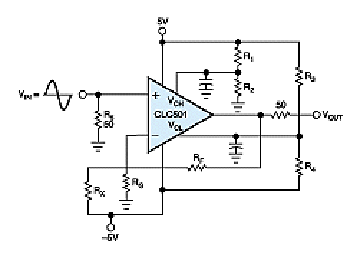

cf amp
hello professors
since current feedback amp ist the theme, could look and ponder on the attachted circuit a bit?
thanks
wennsblitzt

Ouroboros said:
No. Just because the feedback node is low-Z is not enough. In the case above, even though the node is low-Z, it is still a VOLTAGE difference that is being used inside the feedback loop as the error signal. A CFB amp (modern usage!) derives the error (current) signal as the difference between an input current and the feedback current.
Regarding the sound, I really can't say, but it is worth noting that because the way the error signal is derived, CFB amps have very poor control of the output DC offset and usually require a separate servo-controlled dc feedback loop.
Well, it's all fine with me, since I think a CF amp is something entirely different anyway, but I noted that on this post many are of the opinion that there never is an input current, because the signal input is high impedance. They say that CF is input voltage and feedback current.
Your second comment, again, I don't understand why these jumps from one opinion to the other. Yes, DC offset is generally worse, and yes, that may mean you need a servo. But why on earth would that mean worse sound???
Jan Didden
