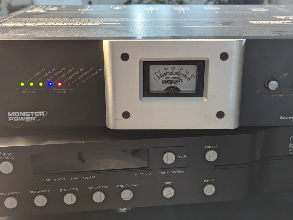

Replaced HA17339 and all is well! (well, almost - the hum / buzz is still there).
The ON / OFF switches now operate as designed and the time delay works! Unless I'm missing something, this unit now works as it did when it left the factory. I left it on for a while, then checked for overheating components but couldn't find any.
As far as the buzzing noise - it comes out of inductors F2 and F3. They have some old shellac or varnish-like material on them that's completely dried out. Also, the buzzing only happens when the switched outlets are on. When they're off, it's silent. At this point part of me says good enough, time to put the unit back together.
Unless anyone thinks the buzzing could indicate a larger issue?

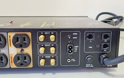

I think there's one more thing to check to see if everything is working properly: the "remote" functionality.

I believe RLY3 is for remote ON/OFF.- RLY1 and RLY2 control the switched outlets, but I don't understand what RLY3 does?

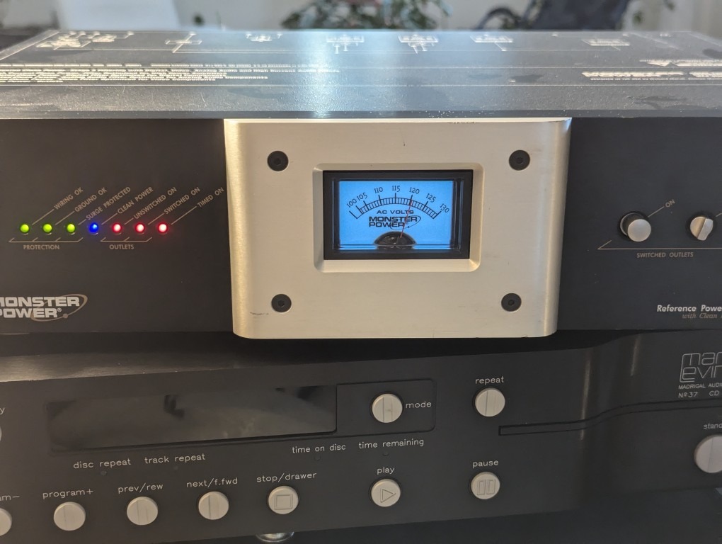

Here is a summary of the unit's behavior:
1. Unit is plugged into AC:
2. ON switch is depressed:
Switched outlets turn ON - "SWITCHED ON" LED turns ON
Switched & Timed outlets are OFF - "TIMED ON" LED is OFF
Voltmeter backlight turns ON
3. After ~7 seconds delay:
Switched outlets are ON - "SWITCHED ON" LED is ON
Switched & Timed outlets turn ON - "TIMED ON" LED turns ON
When OFF switch is depressed, sequence unfolds in reverse order, except that Switched & Timed outlets turn off first, then Switched outlets turn off after 7 seconds.

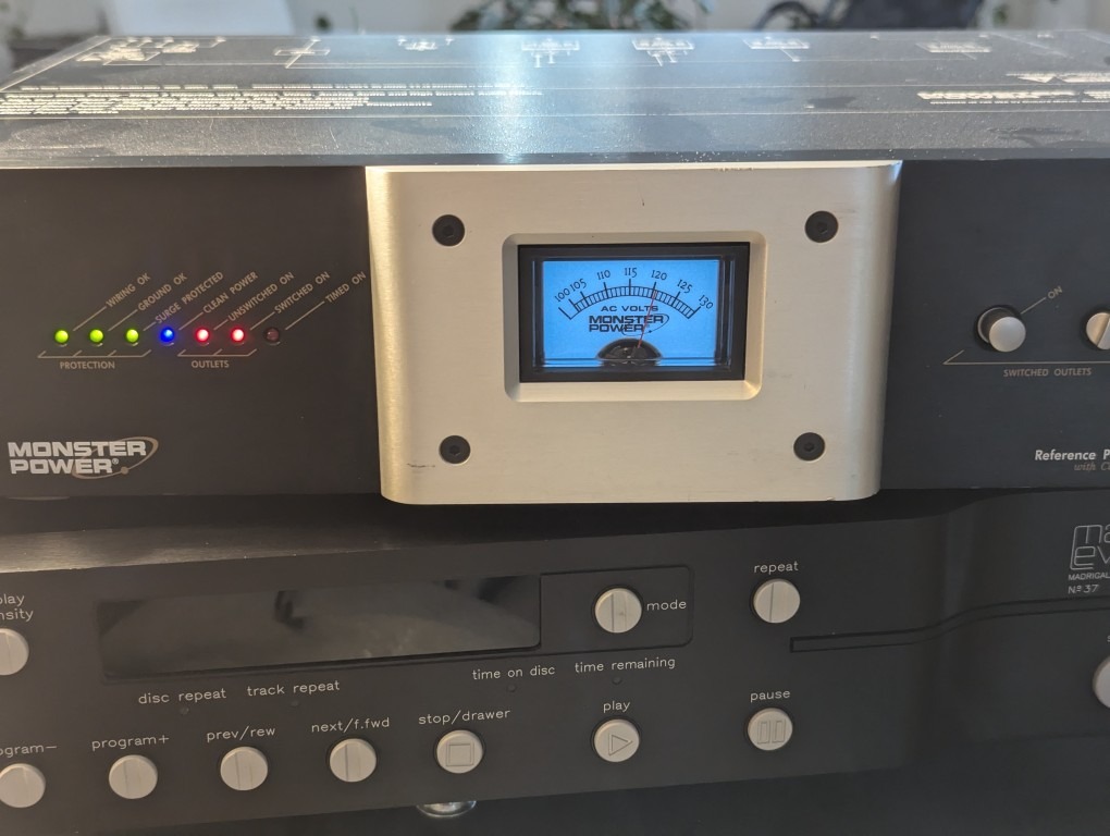

- Switched outlets are OFF - "SWITCHED ON" LED at left is OFF
- Switched & Timed outlets are OFF - "TIMED ON" LED is OFF
- Voltmeter shows AC voltage - dial backlight is OFF
I think you are correct. I tested the remote functionality with a 120V AC cable and it worked fine.I believe RLY3 is for remote ON/OFF.
