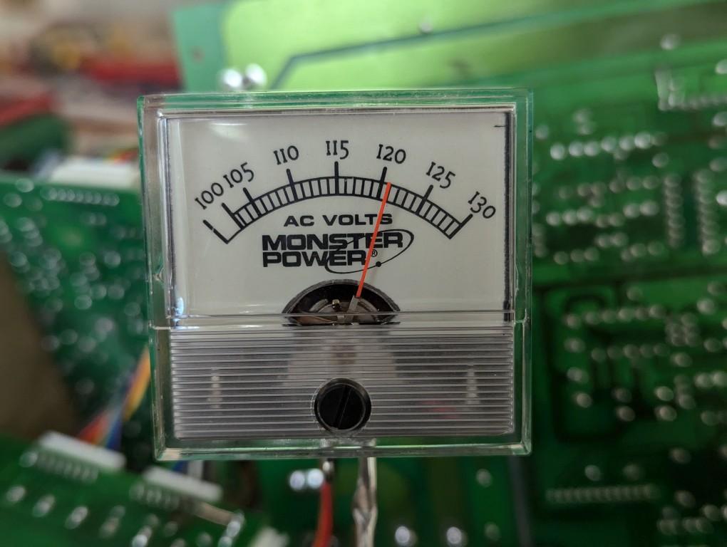

I connected the meter to the PCB, powered on the unit, and the meter works! Reading pretty much right on the money too, my house mains are 121.7V
Again, there were no signs of overheating while under power. Components read at or close to room temperature.
This supports the theory that the traces did not necessarily burn because of a fault in the meter or its circuitry, but because of some other factor that does not appear to be present at this moment but needs to be understood.

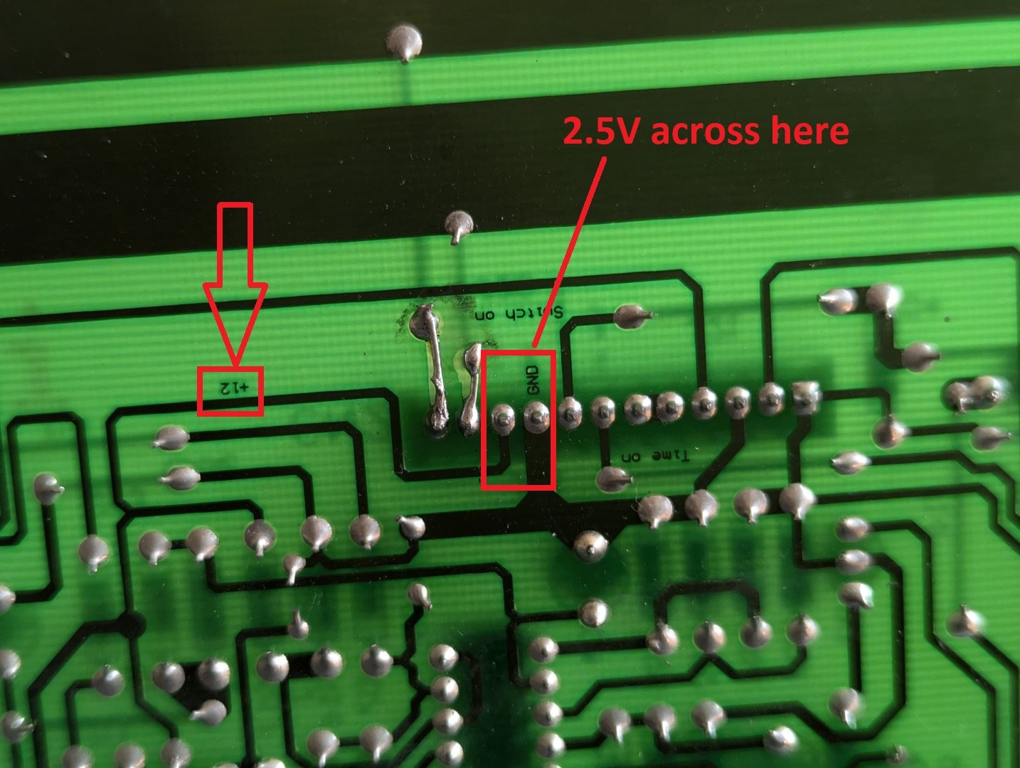

I have been finding inadequate DC voltages all over the main board. There is one HA17339 IC that should get 12V and three relays with 12V coils that all get only 2.5V. The traces on the pic below marked "12V" and "GND" also read 2.5V across.
Bringing the DC voltage to spec will probably help with a lot of things. Also, the 2.5V is not stable; I've read as low as 1.9V and as high as 3.6V at different times.

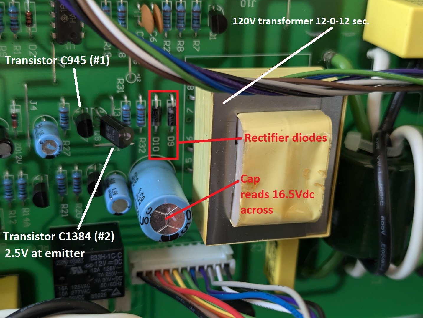

The power supply consists of:
  • Transformer with 120V primary and 12-0-12 secondaries (actual 12.75V)
  • Center-tap rectifier with 2 diodes and a cap (reads 16.5Vdc across the cap)
  • So far so good
  • Next are two transistors (C945 and C1384) connected in a Darlington pair. And there is a problem, only 2.5V at the emitter of C1384 (which is essentially the emitter for the pair), instead of the 12V I'm pretty sure should be there. The pair of transistors is intended to control the amount of current that flows, and therefore the output voltage, correct?
This is the point where I could use a little nudge in the right direction, guys... Does the low voltage mean the transistor(s) are bad, or could it be that the transistors are good but a faulty component or some other condition is causing them to misbehave?
The transistors can't be tested in the PCB, and I wish I could have a better understanding of the situation before I start de-soldering, testing, and re-soldering components (and risk damaging them in the process).

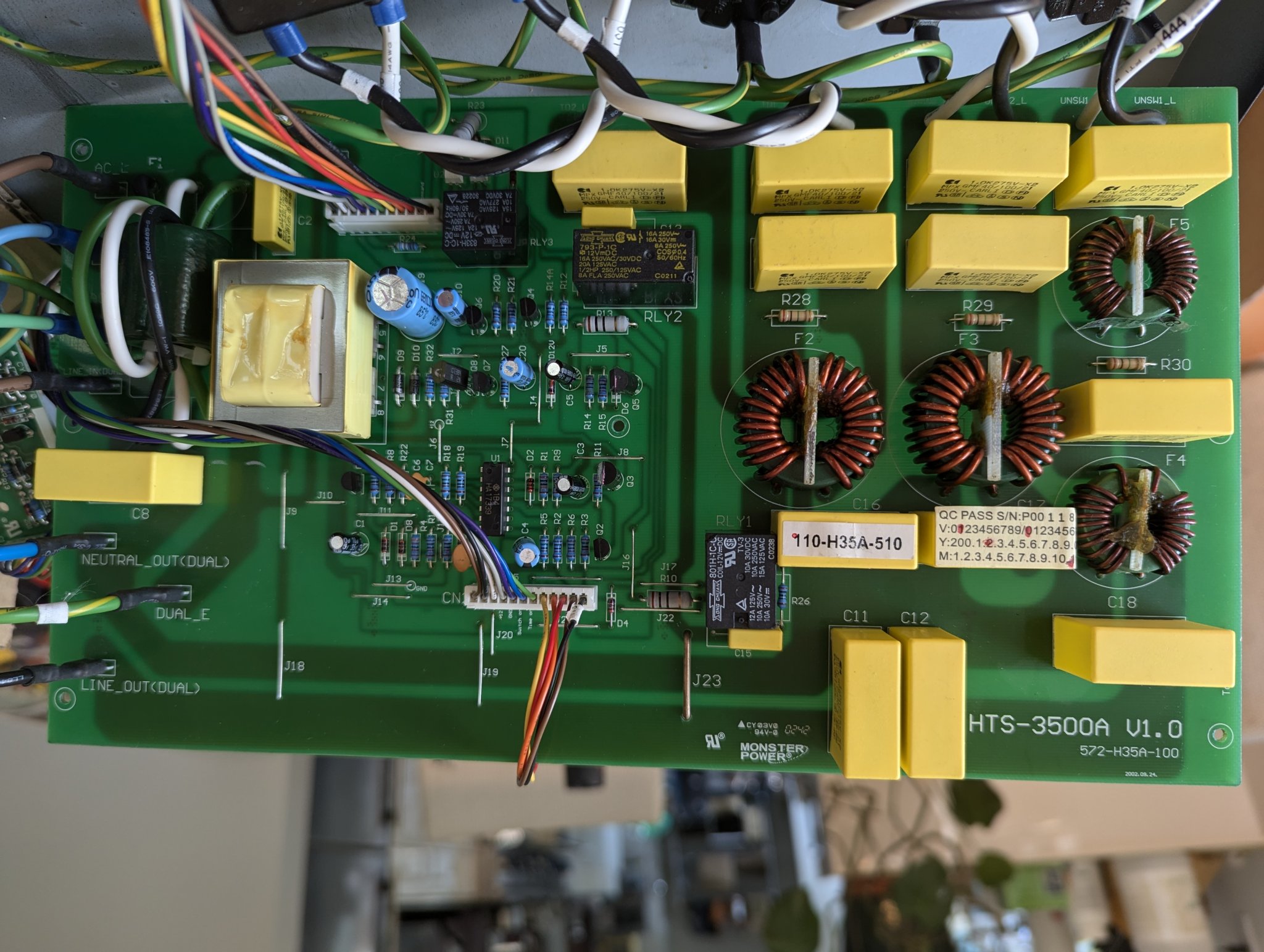

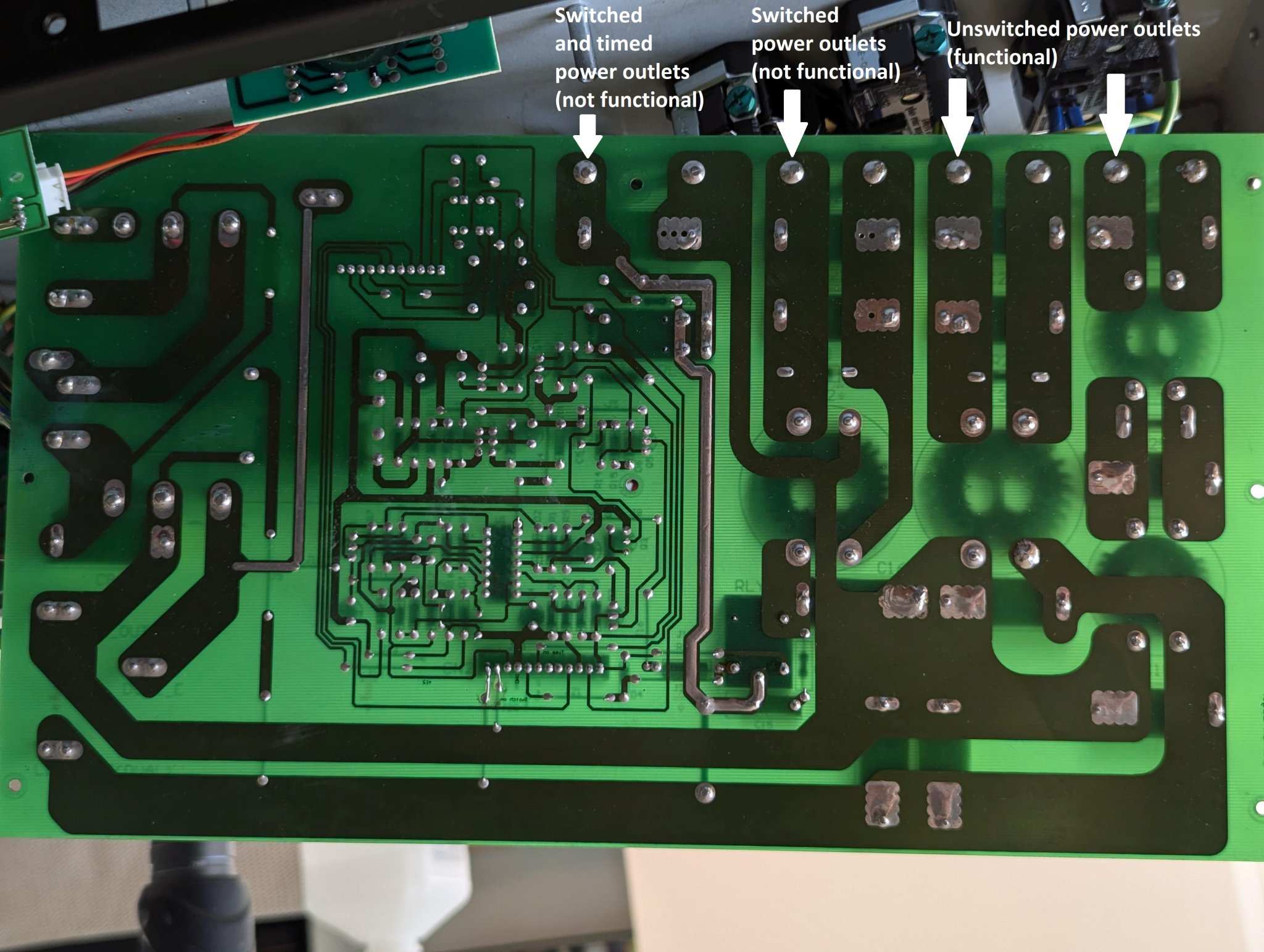

Here is the main board, top and bottom. Thanks in advance!
Designed by Maradonna but chinese contract work as expected. Which are the wires/PCB tracks that burned? If it are short PCB tracks to the brown and black wire the suspicion is a short somewhere. Did you check the wires, their routing and their insulation? Do they measure continuity to either L, N or chassis (without the meter circuit connected)? Putting mains voltage on 2.54 mm pitched PCB connector pads is probably UL listed creepage/clearance blah blah but would not be seen as normal design practice here. The next PCB pad carries 12V DC....just 2.54 mm. There is not much needed for catastrophic failure so to speak.

*2.5V at the emitter of C1384 and 16.5V at it collector? What about the 12V Zener diode there?
Assumption/hearsay/gossip: that circuit likely had mains voltage on it somehow. It would not surprise then that many semis are shot.
