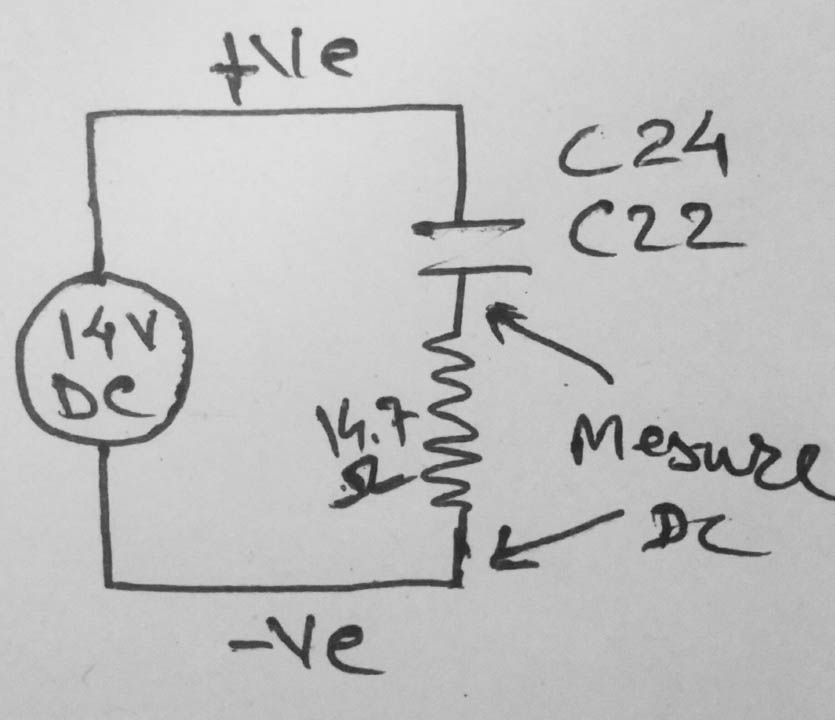

I have put back original C22. C24 also tested by taking it out. It measures 6pf. (Original value 10pf). Leakage also checked there is 0vDC at 200mA and 2mA. C24 also put back in again.

tested DC leakage of C22, C24 as pic attached

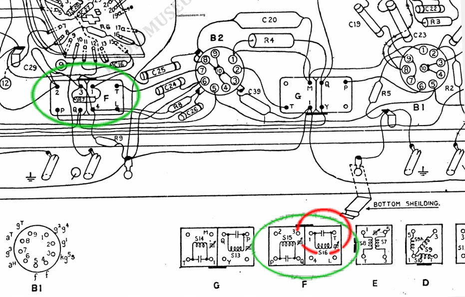

Which one is Second IM transformer ? Is it S 15/S 16 shown in the schematic ?

That's correct Hiten. See attachment .
The ends of the two internal coils are coming out at the bottom side at the following terminals:
Primary coil: P and Q
Secondary coil: L and T

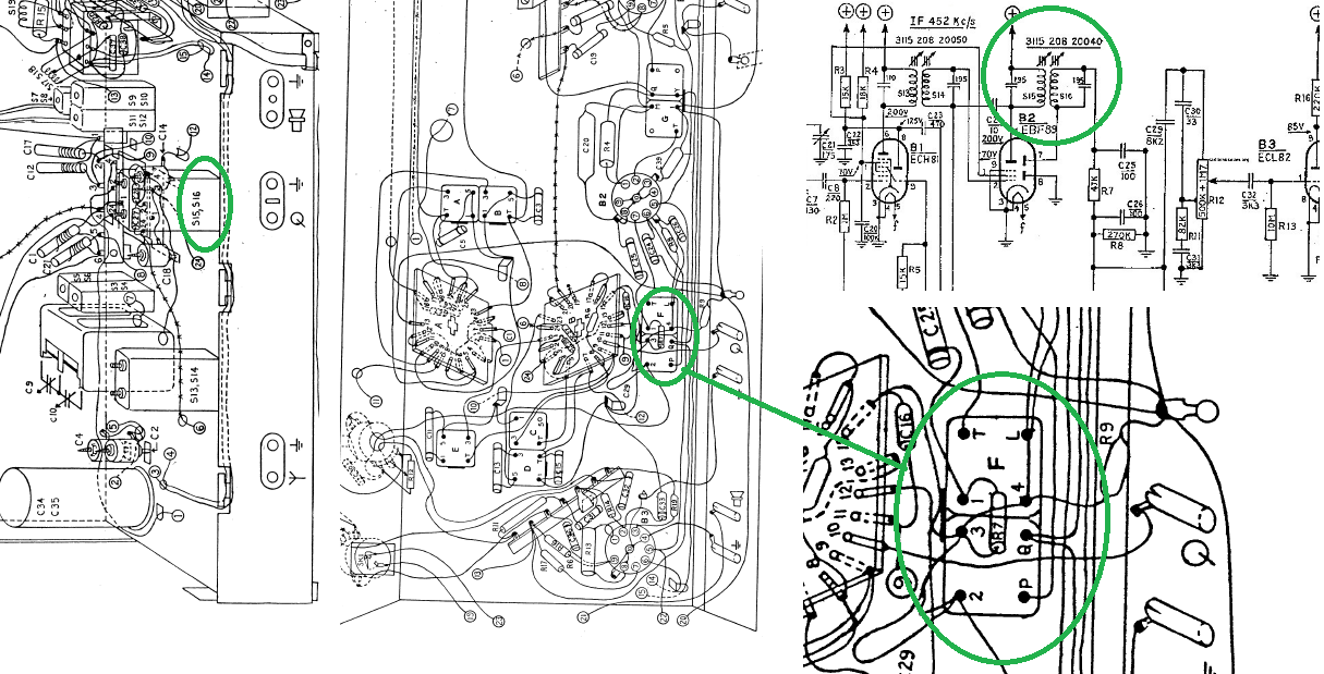

I looked at wiring diagram in the manual. See attched pic. The transformer is shown in green circle on left. At bottom the same transformer 'F' is showing where coils are.
The bottom (green circle) transformer inards shows coils as P-Q and 1-T. So I measured 1-T it shows around 7/8 ohms.
