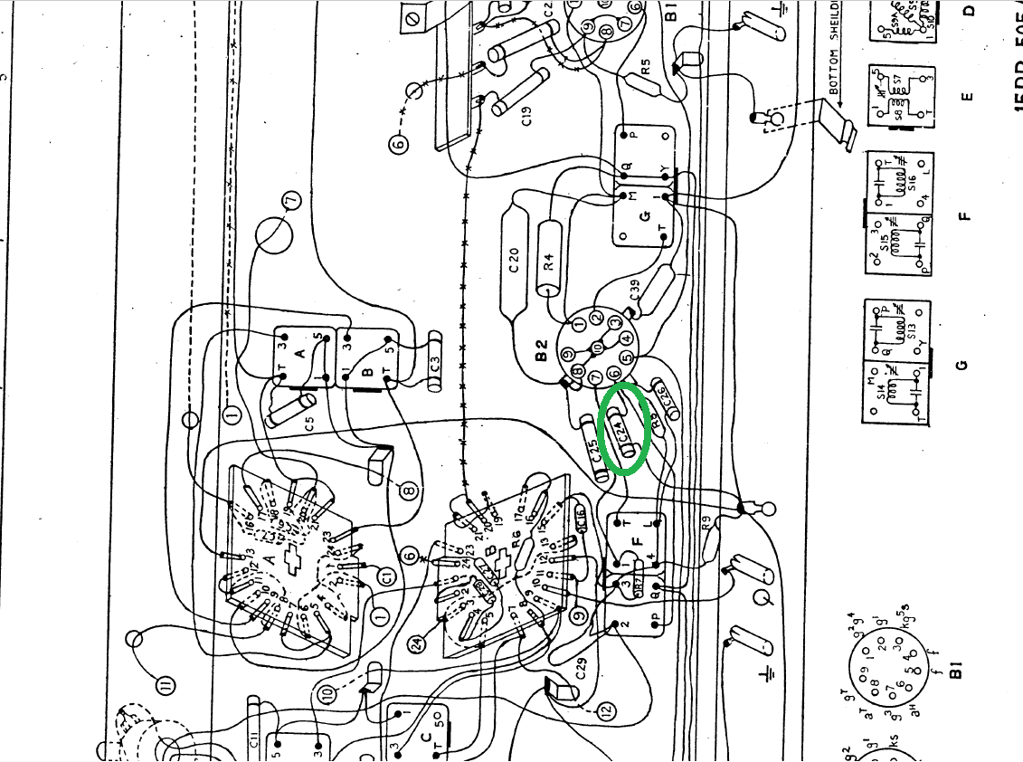

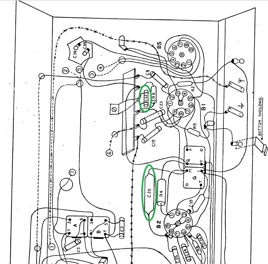

Discharge C20 C22 (see first attachment). Then measure them, not so much for exact capacitance but to confirm that they are not shorted . If they are shorted you have to replace them. If they are OK, then do the following:

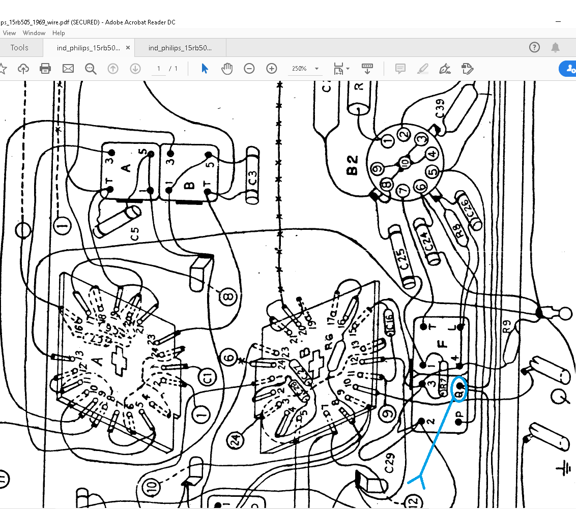

See 2nd attachment and disconnect the wire loop from the Q tab of the second IM freq transformer.
Install ECH81Next switch on radio.
Reconnect the wire that you had disconnected from the standoff of R16.

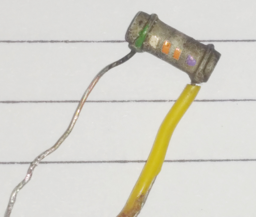

I disconnected one end of lead of capacitors C20 and C22. The C20 measures 92 nanofarads in my multimeter. Which translates to 92K pf. The schematics papers say 100K pf so i think this is ok.
But pardon my ignorance. The C22 reads 0.014 nanofarads which is 14 pf. The schmatics says 3E3 pf. Which I dont understand. What is E between 3s ? I also checked resistance for short. The C22 shows open even at 2000Meg on my multimeter. So I have stopped moving further. Kindly guide.

3E3 is 30nF. Measurement is way of. Chances are this capacitor is almost a short.
Remove it from circuit.
Check it for leakage. See schematic of post 18.
DC voltage value does not matter now, use what you have, even a 9V battery is OK.
Use only one resistor, any value you have above 10kOhm will do.
Measure DC voltage across the source and across resistor. Report values.

I think that neither C20 nor C22 can be the cause for a smoking R15. Look, they're both behind resistors of substantial values.
Of course they can be the reason for a non working frequency converter.
I've been thinking that one of the IF transformers might show a short to ground. But this can be excluded as the smoke reportedly stops when the RF tubes are out.

Some updates :
for capacitors that were hard to remove I used to desolder/disconnect one lead of capacitor and with little short wires (3 inches approx) used to test capacitance in MM. By this method this C22 capacitor used to show very negligible capacitance. Now I have removed it totally and measuring with 200nf and 20nf setting. It is showing no capacitance.
I have a DC adapter which shows 14v DC. A 14.7K measuring resistor is what I found to test. So C22 and 14.7k resistor in series other remaining capacitor lead to positive DC supply and remaing resistor lead to -ve supply I measured dc across the resistor it is showing 0 DC in All 20V, 2V, 200mV range. What does this mean ? I do have new 0.033uf non polar 250V capacitor with PPC code written on it. pl. find pic attached of old cap.

OVdc reading means the capacitor is not leaking.
Nevertheless, since you have a new 33nF at hand put this new capacitor as C22 in the radio circuit. Reconnect C20 as well and continue as per post 48.

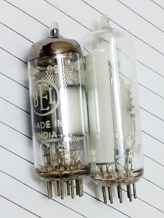

While taking valves which were kept aside the two valves (Dont know how I didn't noticed earlier) the remaining EBF89 has big dark silver band in mid region. Is it normal or is valve burnt ? The Magic Eye EM84 the top coating is clear. Probably gone ? kindly see pic. I do have extra EBF89. I guess we can carryon even without magic eye EM84. right ?
Replaced old C22 with New cap. Reconnected wire R16 wire. Disconnected wire on 2nd IM transformer point Q. Installed valve ECH81. Tested with series bulb tester. speaker attached. volume low, Band selected SW1.
The bulb didn't lit. All three valves EZ80, ECL82 and ECH81 glow. Minor Hum when ear placed near speaker. There is no radio interferance sound like in shortwave radio. The R15 does not get hot even after more than one min. Probably kept on for one and half min. The R15 is cold or normal.
The EBF89 doesn't look abnormal, just like a Philips made one. About the EM84 I'm not sure, but you'll see after you've put it back again.

EM 84 I think has a cracked glass envelope. It seems milky (air inside), probably dead. It’s not important for the function of the radio. Do not plug it back in.

Your C22 is ok with only a few picofarad capacitance. If I see it correctly in the schematic it sits at the anode of the triode in theECH81. If you change it to 30 nF, the oscilator triode in the ECH81 will not work anymore! This capacitor is a ceramic tube type and these have been very popular RF capacitors in tuners and IF stages. There have never been such capacitors of small size that had significantly more than a few nF, mostly < 1 nF.
Yes, Andreas thank you. You are most probably correct.
I looked at many schematics of radios with the ECH81.
Not many use a cap to ground there but the few that do, have this capacitor from 500pF to max 5nF.
So Hiten, as the original C22 was not leaking (*), please place it back in place.
