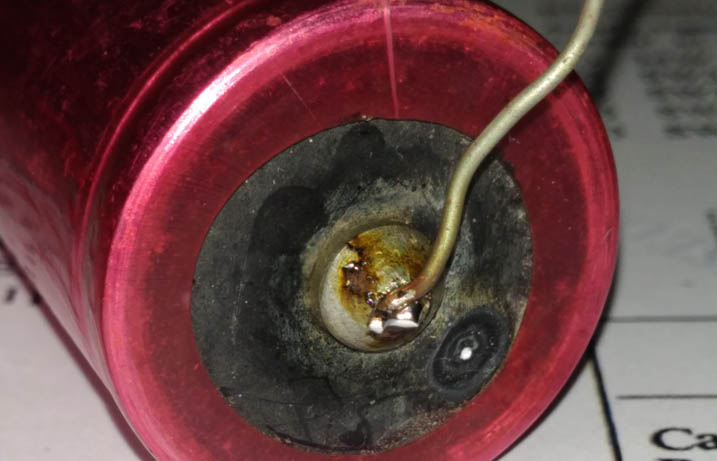

Hiten,
I'd desolder the positive terminal of C34 and leave the rest connected. If the magic smoke doesn't appear again when powering on, C34 is the culprit - and most probably it is indeed.

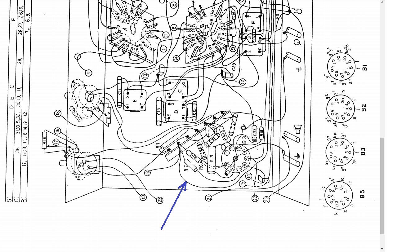

Thanks Hiten.
I would like to ask you to do one more action.
With the radio unplugged from the main’s and after discharging the electrolytic capacitors C34, C35.
Please desolder the wire I point to at the attachment and remove it from the standoff where it connects with R16, R17. This way you stop the flow of High Voltage to the rest of the circuit. Cover it’s end with an isolation tape.
With only ECL82 and EZ80 installed, switch on the radio.
Does R15 get very hot again?
Does R17 get hot?
George

gpapag,
disconnected the wire you mentioned. Turned on the radio with series bulb tester. Tester Bulb does not lit up. Light glow in both EZ80 and ECL82 tube. Kept it on for around 30 seconds. R15 and R17 does Not get hot.
OK. will do so. Common of Multimeter to chassis and voltage on each pin of ECC82. correct ?Very good.
Now in that configuration, measure voltages at all pins of ECL82
George
kay
removed +ve of C34. R15 gets hot.
Will rearrange things as gpapag said and measure voltages at ecl82 pins.
oops. a little mishap. Broke the lead of C34 from joint. Will see if it can be soldered back. Will update soon. Extremely sorry.
edit :
OK. Have joined the lead. But solder joint is just 0.5mm. Measured it and it is working. But very delicate joint. will see if I can glue it. pl. give time.
thanks and regards.
edit :
thanks and regards.
