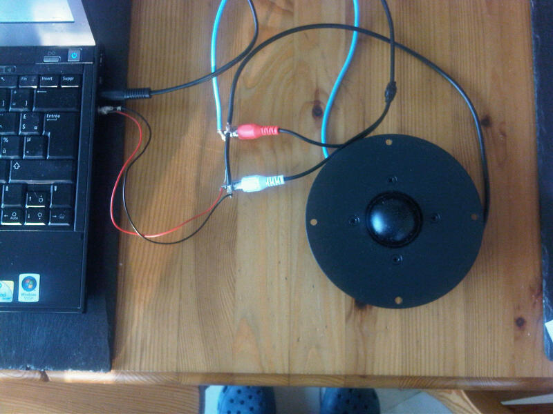

On your impedance measuring jig, is the red and black wires connected to your computer's headphone out? And is the mini plug to rca connected to the microphone in? Also, is each rca lead connected to both the positive and neg lead or is one connected to the positive only and the other to the negative only. It's hard to tell what's connected to what in the pic because all the connections overlay each other.

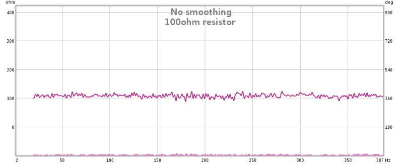

Hi, I am having trouble using the REW impedance measuring device. I believe I have it hooked up correctly, I have calibrated the system for the resistor, my levels are ok. When I measure I don't get anything at all on the graph. The only tab that displays anything on the graph is the "GD" tab and it is a horn shape starting small at 25hz (start) and gradually expanding towards 20,000hz (end). Any thoughts.
Ok, I have gotten the input level to not give an error message and have gotten the impedance graph to display an image, but I don't believe it's correct. I get a very large peak around 50hz and then it drops pretty sharply back to 4 ohms or so and stays flat all the way to 20k.

It seems impossible. None of my measurements look anything like the graphs that I have seen showing impedance and phase. They look more like bad frequency response graphs. My guess is that it is not set up right. Everything that I am reading is too damn complicated, REW's help pages and what people have to say on home-theater-shack assume that you have a postdoc in electrical engineering. I was hoping for some help from Pascal since he was the one that recommended I set this thing up.
I had trouble setting up what I imagine is the same type of jig for LIMP. The problem turned out to be a wiring error where I'd forgotten that a jack was TRS balanced, but that's probably not your problem. It works right when you connect a resistor instead of a speaker? Can you post what you're getting for a speaker?

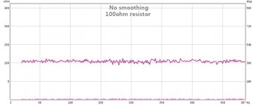

I'll post a pic I have to remeasure because I haven't saved any.
A balanced TRS jack is something you'd find on pro gear, I'm sure it's not an issue with your soundcard unless it's a pro-ish external type. Make sure your grounds are connected, including the negative speaker terminal, as done by the black wire in this pic of Pascal's hookup:
