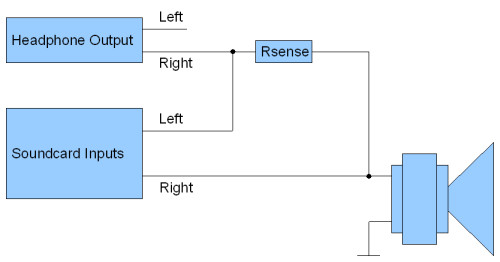

Yes, it has headphone out. What are the soundcard right and left inputs in the diagram and what does the neg speaker input connect to?
Usually you can find right and left inputs on the line|microphone input on a sound card. On my laptop its on a minijack connector and you choose the level when you plug the jack via a popup windows on the system.
The negative speaker is connected to the negative pin of the headphone out.

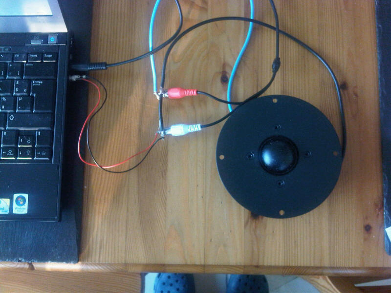

I've made a small jig using two female RCA connectors where I connect a standard RCA/minijack connector for line input.
See attachment.
Do you have one channel of the microphone connected to the positive speaker terminal/headphone + and one channel connected to the neg speaker terminal/headphone -?
The connections in you're photo are obscured so it's hard to till what's connected to what.
I think the schema show everything :
Headphone Output right -> Rsense
Mic input left -> Rsense
Mic input right -> + speaker
Connect :
- ground Headphone output
- ground Mic input
- speaker negative pin
All together
Yes you need Rsense, a 100 ohms resistor 1/4 W 1%, as shown in the schema.

Got it. Thanks. I just have a hard time reading electrical schematics. It shows speaker ground to ground; I didn't know that means to connect it to the headphone and mic ground.
