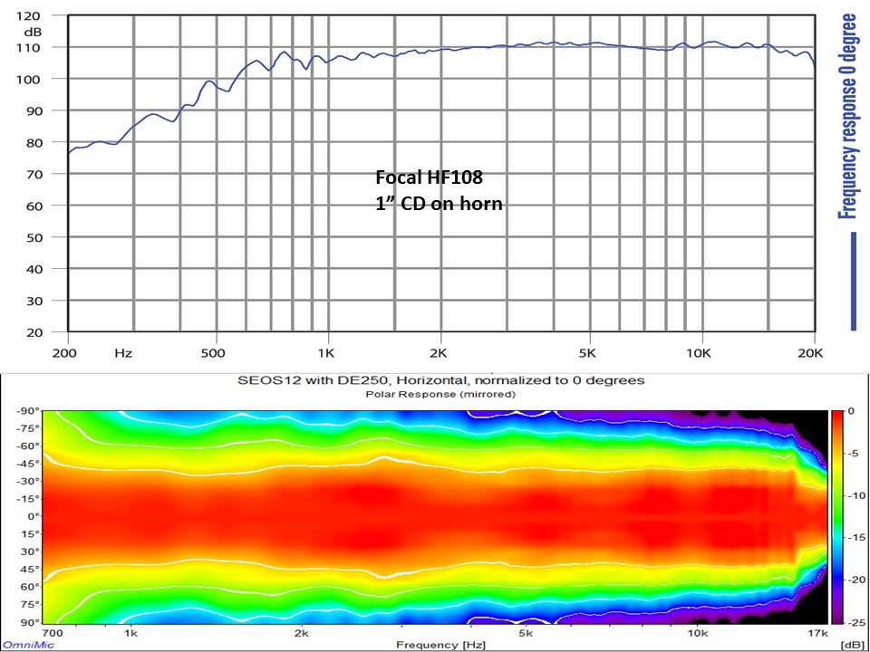

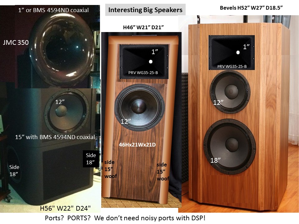

Instead of cloning a 4-way JBL 4345 monitor, do you have any forward thinking big-dream speaker design ideas?
-Using DSP with multiple amps dramatically changes both the design and design process from beginning to end. `
-For home, ports no longer seem necessary. Monster 18" BMS 18N862 woofer with sealed box room equalization down to 20Hz are simple with modest cost DSP/plate amps.
-4-way not mandatory. Latest Tech 12" midbass and 1" compression drivers have excellent frequency and directivity performance from 1,200Hz - 20,000Hz
-90H*40V polar pattern best fits HT and family couch, but large circular JMLC horns(Lynn Olson thread) get top praise for solo critical listening.
-Cabinet shape still important. DSP cannot correct edge diffraction distortion. Sexy still sells!
