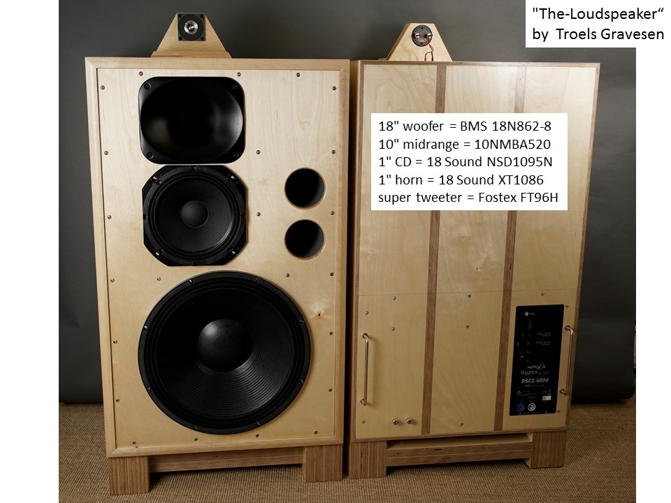

The-Loudspeaker
Troels also designed a JBL 4345 type 4-way speaker which he named "The-Loudspeaker"
18" woofer = BMS 18N862-8
10" midrange = 10NMBA520
1" compression driver = 18 Sound NSD1095N
1" horn = 18 Sound XT1086
super tweeter = Fostex FT96H
Basics:
-Four-way floor-stander from 18" +10" + 1" comp. driver + horn-loaded tweeter.
-Finished speaker weight: 85 kgs/ea.
-Sensitivity: 95 dB/2.8V/1 meter.
-Impedances: MTT section: 4-8 Ohms, minimum 4.3 Ohms @ 600 Hz. Bass section 8 Ohm, minimum 6.5 Ohms @ 25 Hz. If run fully passive from one amplifier, minimum impedance will be 3.0 Ohms @ 120 Hz.
-Points of crossover: 200, 1300 and 9000 Hz.
-Bi-amping is highly recommended if no Hypex module is used (passive version).
-Cabinet dimensions: 65 x 45 x 105 cm (WxDxH), 307 litres gross volume.
-Power requirement: 30+ watts for mid-tweeters section. 200+ watts for bass.

I wish my neighbors will be very understanding...
When someone did more than 100 speaker designs, and after all this year's then he chooses PA drivers, does it bigger than normal, and is that satisfied that he just calls it "The Loudspeaker", then to all reading his homepage should be clear, that this is in his eyes a speaker, which does so much aspects right, that he an just enjoy music!
When I first flew over the article, I liked that he now has a classic design with PA chassis. Reading it concentrated, I realized that the maybe bass 10" is actually a 18"!
Now we have a big living room, perfect for this speakers, but what will the next look like?
