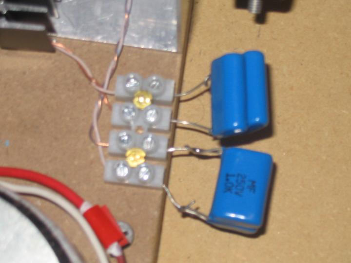

Re: Question for Davet
First, I would think the Bennics may sound better than the Radio Shacks. I have a TA-10.1, but I did not remove the caps from my TA=10.1 to test.
To remove the cap, place your soldering iron on one lead at the junction of the lead and the printed circuit board (PCB). Then, use pliers or tweezers to pull the lead from the board. I would suggest trying to heat the connection from the capacitor side of the board using pressure on the the iron to try to insure the solder pad on PCB doesn't lift.
The leads may be bent on the underside of the PCB. You may have to straighten this lead in order to remove the cap. Heat the connection and either straighten the lead or lift the cap.
To connect the RS caps in parallel take the two caps with the writing facing up on both. Wrap the lead of one of the caps around the lead of the other. Solder this connection and trim the lead of the soldered cap. Leave the other lead for mounting on the PCB. Repeat for the other lead: wrap, solder, and trim.
Repeat for the other two caps.
Use the non trimmed leads to mount the parallel caps on the TA-10.1 PCB.
The attached photo should help.
