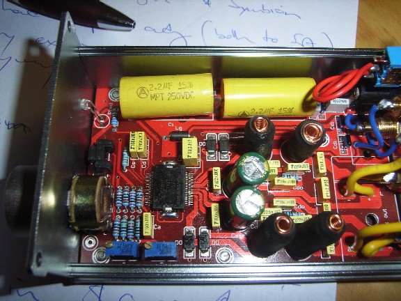

Based on the generally positive comments about the stock Bennic caps in the Trends TA 10.1 I haven't considered any mods.
However, on opening mine up to change the jumper settings to make it a power amp, I discovered it doesn't have Bennics! It was purchased about 2 months ago and is definitely branded as a 10.1 version.
Can anyone identify what these are and how they compare to Bennics.
Thanks.

Just spotted this thread and thought I would throw in my own experience with a Trends TA10.1.
The amp came with yellow caps that don't say Bennic on them but are apparently Bennic XPP unbranded. I have no clue. The amp has performed fantastically but I have always experienced some mid range harshness on some recordings which i attributed to speakers which are new or the NOS DAC also new. To cut a long story short I moved the output coupling caps which are 1 microfarad Vitamin Q from The DAC into the amp to replace the "Bennics". The result was astounding, huge soundstage, greater air and life, much better bass, improved dynamics and zero harshness.
In this process I have removed a cap completely which I am sure has helped a lot but the Sprague vitamin Q in the amp works really well. They are way too big physically but with some work they fit in the amp casing nicely. Cost of these caps was 11.50 Euro each.
I am not sure of the necessity of 2.2 microfarad as my 1 seems ok. Maybe someone can advise as I could always parallel 2 caps as I can only get them up to 1 microfarad.
