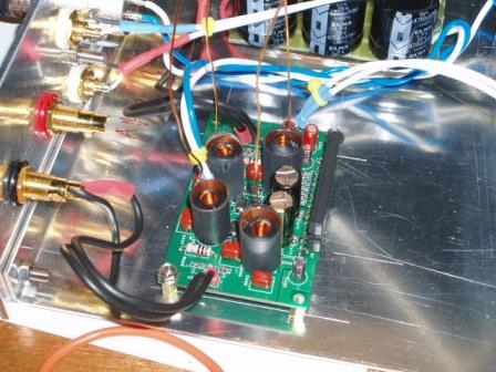

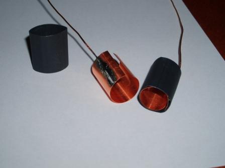

Shielding the cores
Hi, in the photo you can see a simple but effective and save way to shield the air cores of charlize and other amps using air core inductors.
I used 0.15 mm copperfoil. Cut a stip of 2 cm wide and appr. 3 cm long. Bend it around a bar appr. 2 cm in diameter. In every tools box you can find one. Solder a piece of wire on the copper foil. Make it so that the copperfoil circle neetly fits a 19mm insulating and shrinking tube so that there is a little overlap in the copperfoil so that if shrink the tube with a little hot air the copperfoil also shrinks. The tube should be a little bit longer than the copper as not short circuit some connection on the pcb.
Every air core receives its shielding and the wires can be grounded on the board, voila. :smash:

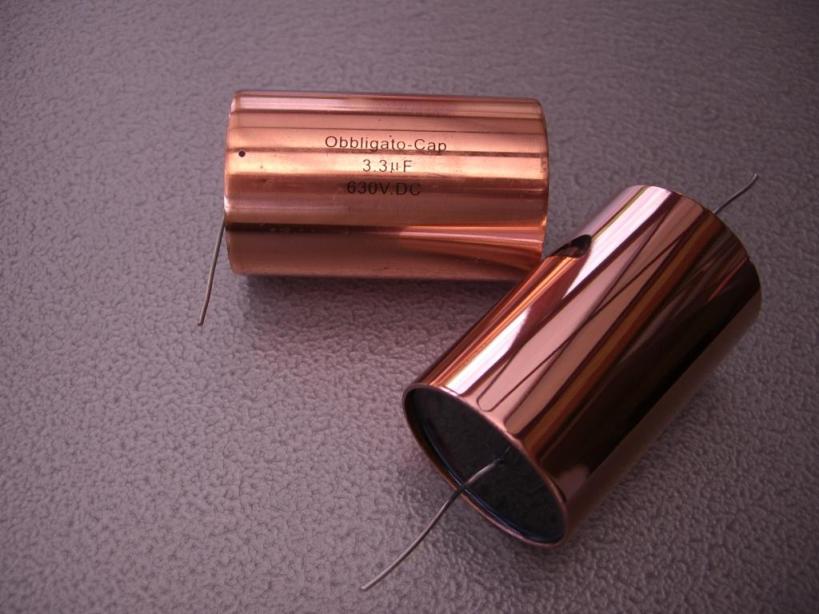

3: replaced the input cap with Obbligato pio's in an outside box

Thanks!! 🙂 I too am currently running PIO Obbs, but found them very, very smooth. I have added a BG NX-HiQ 0.1uF bypass that I had sitting around on my cap rack and that has helped brighten things up a bit. I do have a selection of other bypass caps to try over the next few weeks, and then I want to try the copper Obbs I have here. Couldn't resist a few minutes with the buffing wheel - brings them up a treat!! 😎

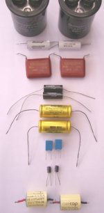

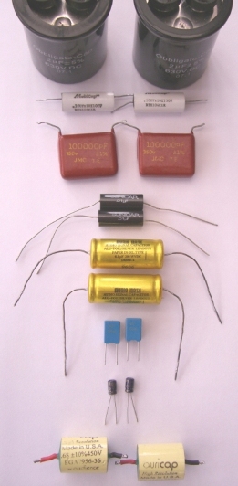

Bypass Caps
OK Folks,
Here is the list of caps I'll be trying out in slow time over the next few weeks. They will be bypassing the 2uF PIO Obbs that are currently installed. I will also be comparing with the copper Obbs (of the same value) as well at a later stage.
Big thanks to t. who has loaned me the majority of the caps for testing here. Appreciate that, mate!
PIO Obbs (spare set - they are installed already - honest!!) 😉
2 x 100nf Multicap RTX
2 x 100nf Mica caps
2 x 100nf Sonicap Platinums
2 x 470nf Jensen PIO's
2 x 100nf Vishay MKP1837
2 x 100nf Black Gate NX-HiQ
2 x 680nf Auricaps
Caps with leads needing lengthening will be extended with 5N silver wire. Caps will be tacked between the PIO leads where they enter the board, for ease of swapping out.
Test music will be Jack Johnson, Annie Lennox, Dire Straits and Dido (as we used these for the Krell shootout).
This will be a longer term test, as caps will need to be reasonably run in the amp. All other caps will be working out on the rack while they wait in line. Caps will not follow any particular running order either. :angel:
More news as it comes...............
Cheers
Jon :smash:
