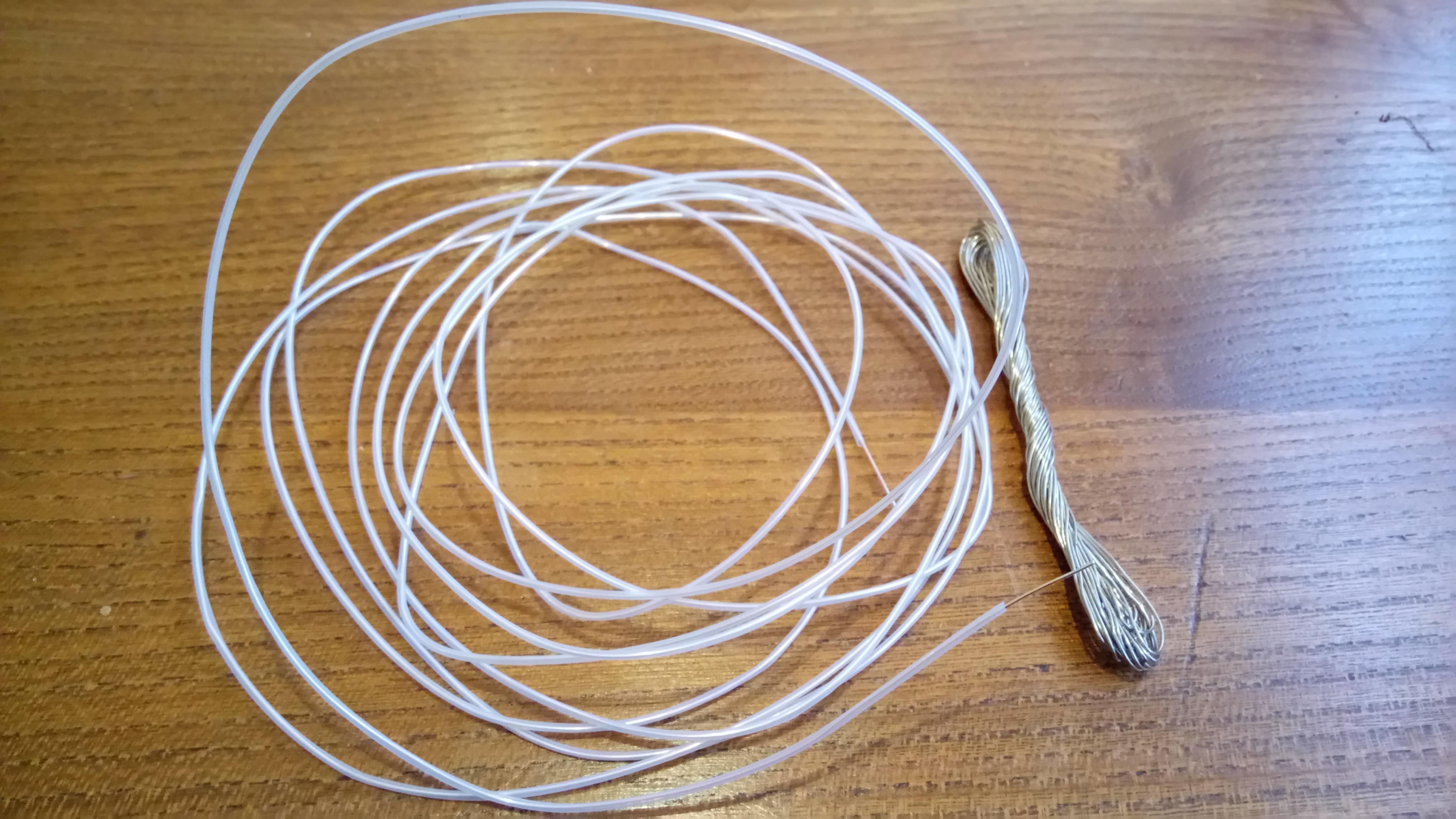

silver wire, silver solder?
Now its all very well buying pure silver wire, can i just use normal electrical solder to solder these to the connectors?
I'd scrounge around for at least something like the old Radio Shack 5% silver bearing solder. My personal favorite is the old Cardas Quad Eutectic - I bought a one pound roll at least 10yrs ago, and have hardly touched it. PM me
With silver you need to use solder with silver in it, the usual receipes have 2-4%.

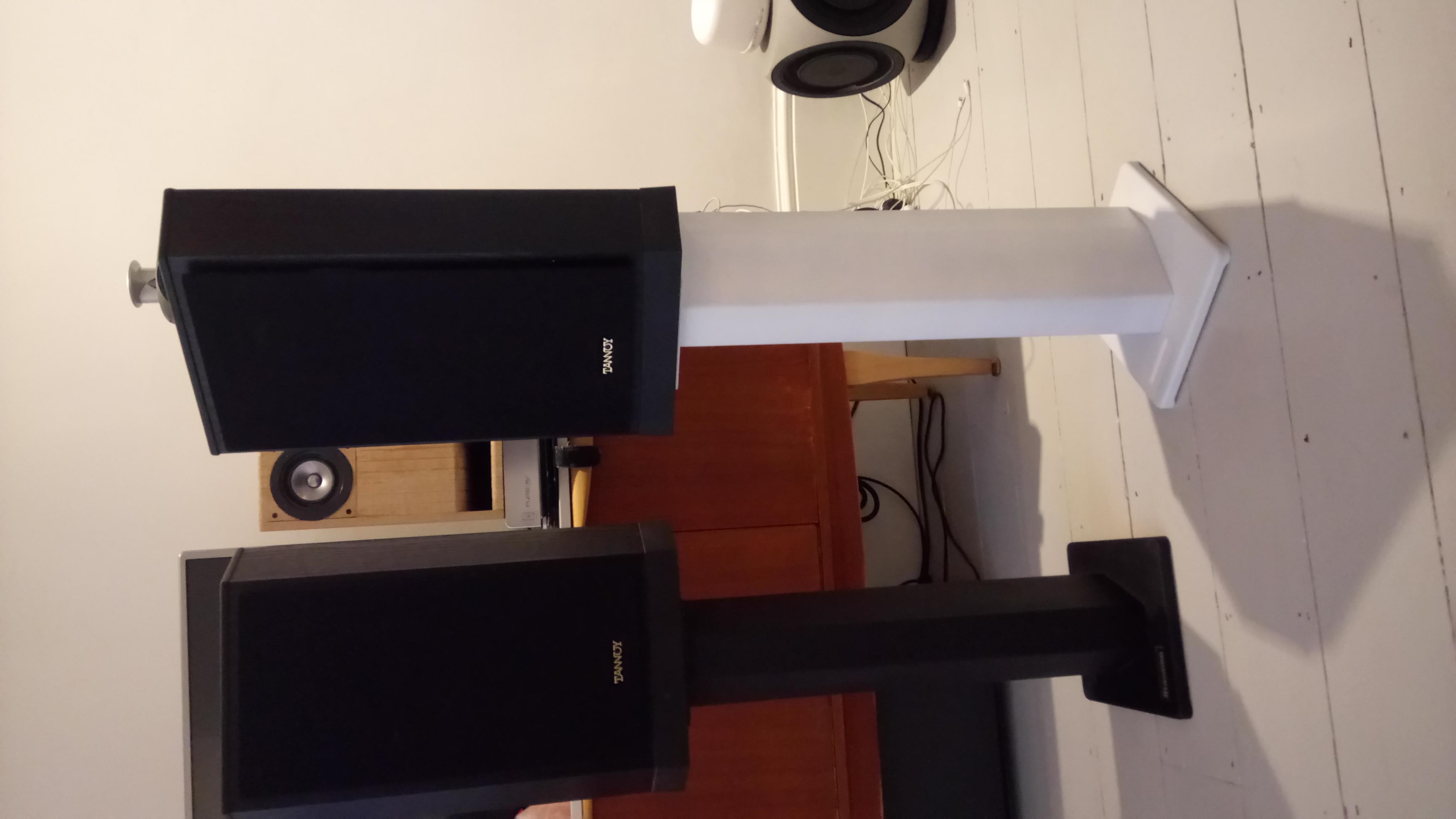

Pure Silver wire, silver solder and Speaker stands.
Bought some second hand speaker stands, bargain at £20. Used some pastikote white matt spray paint to tidy them up, a few more coats will look like new.

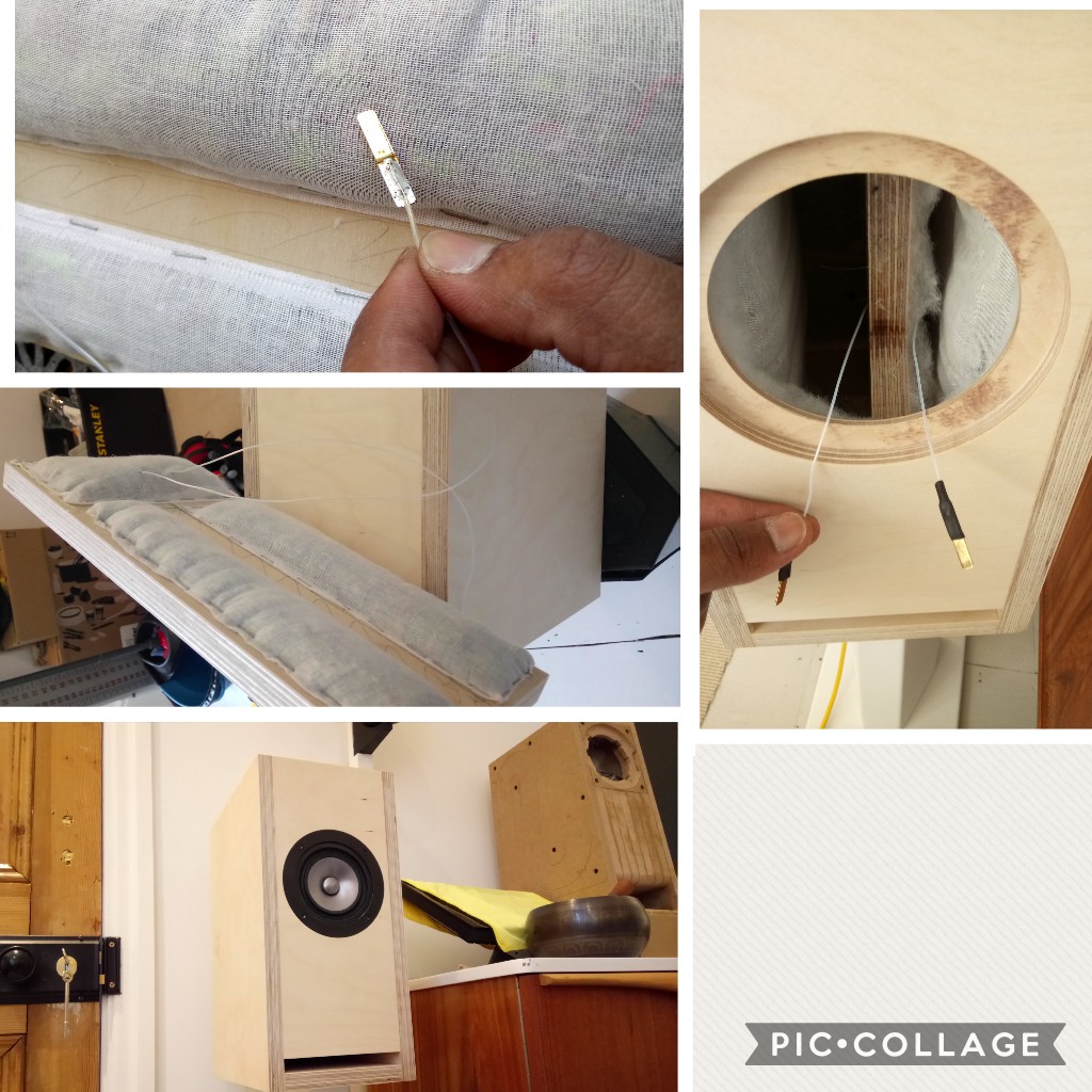

Silver wire and solder arrives ready to be carefully soldered making good clean connections.
dave
Never understood this, what difference does 2% silver make? What happens if you use normal solder? Does it make any difference if it's silver plate? Why is it ok to use normal solder with gold plate?
If the pillar is hollow fill it up with sand or kitty litter or some such.
dave
dave
Thanks Dave it came filled with sand. Fairly weighty!
Slims done, new silver wire soldered and enclosures ready go be glued and finished.
Go, go, go! 🙂
