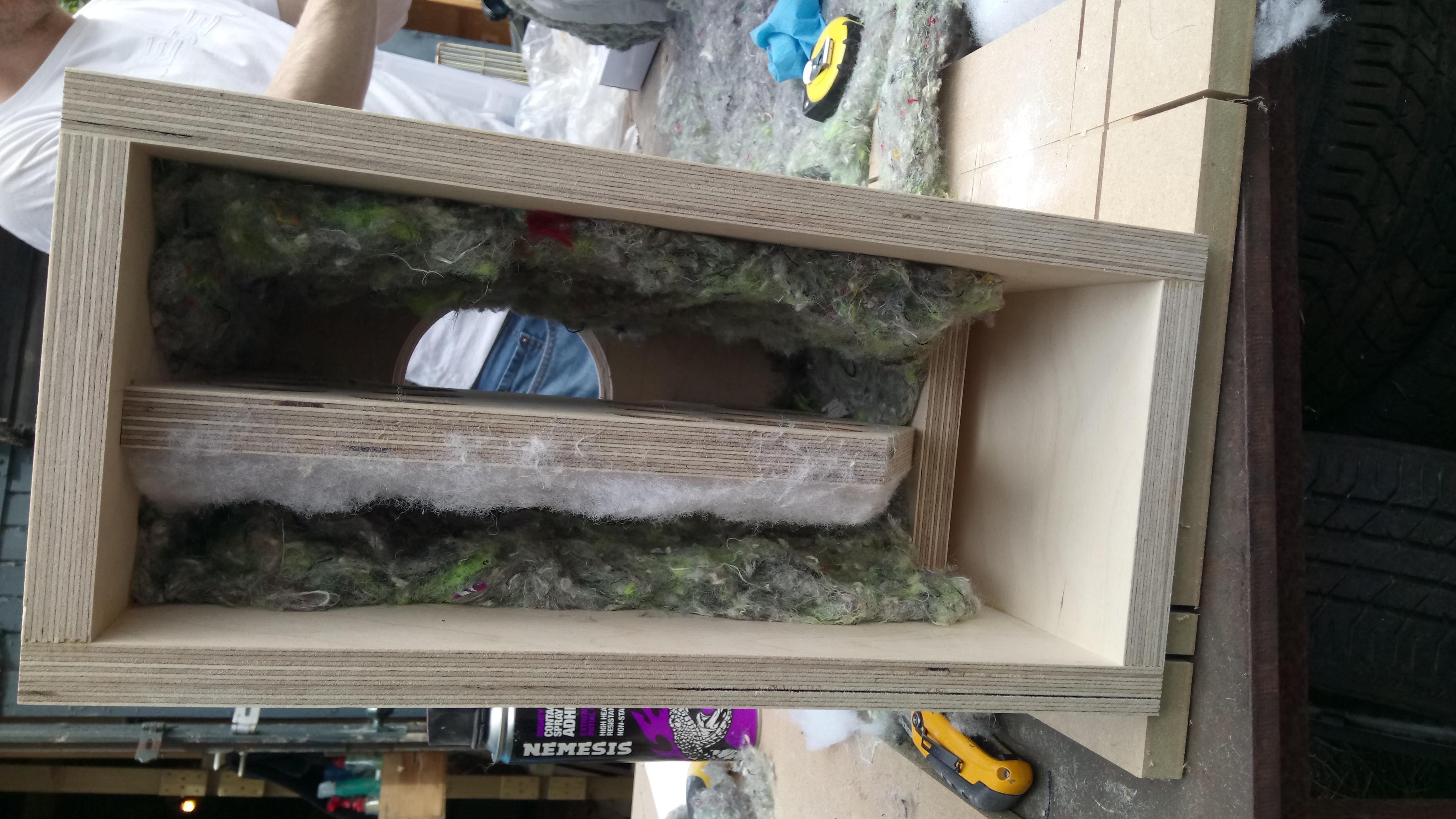

more pics, wadding placement.
Note the chamfered edge

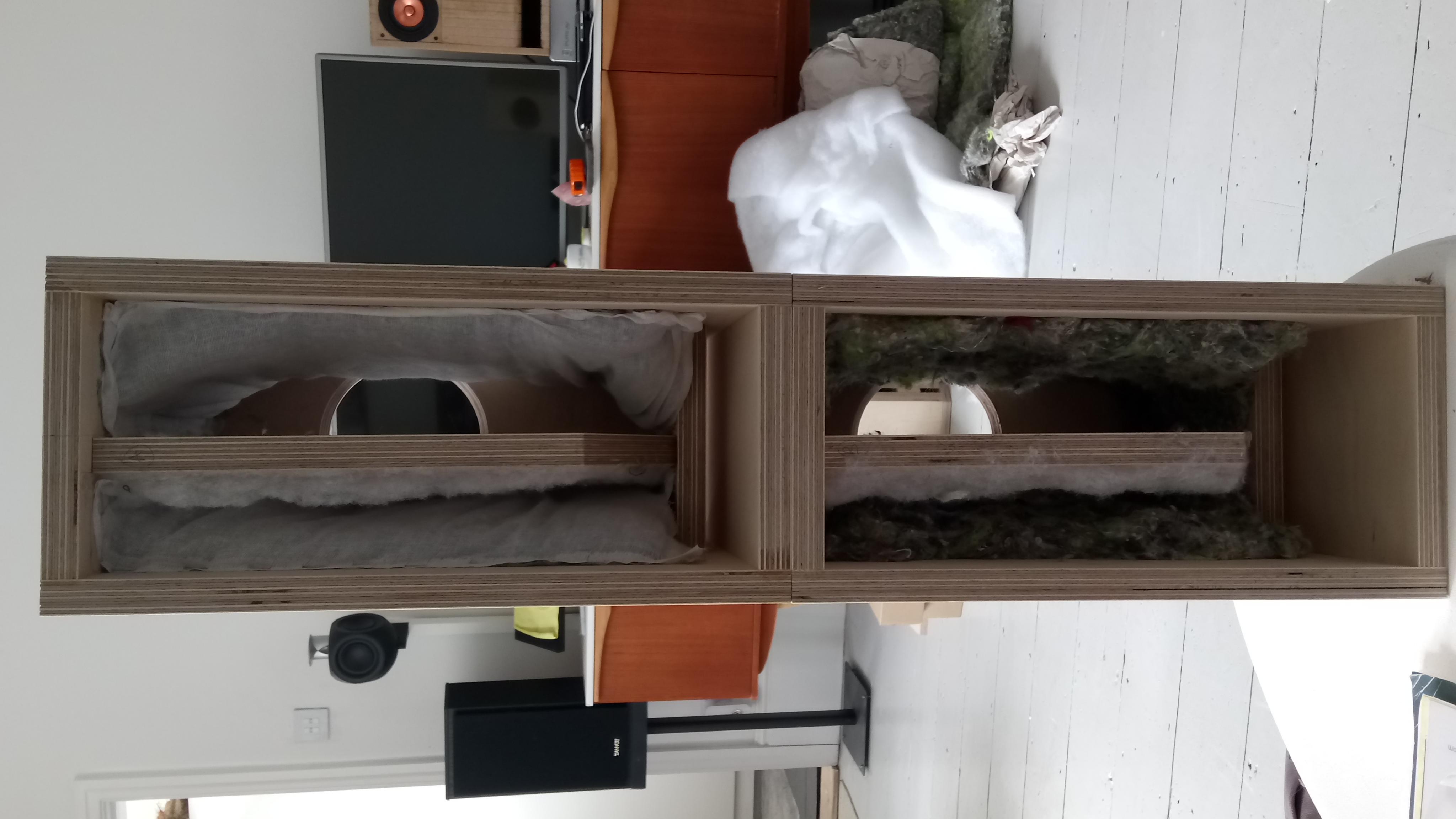

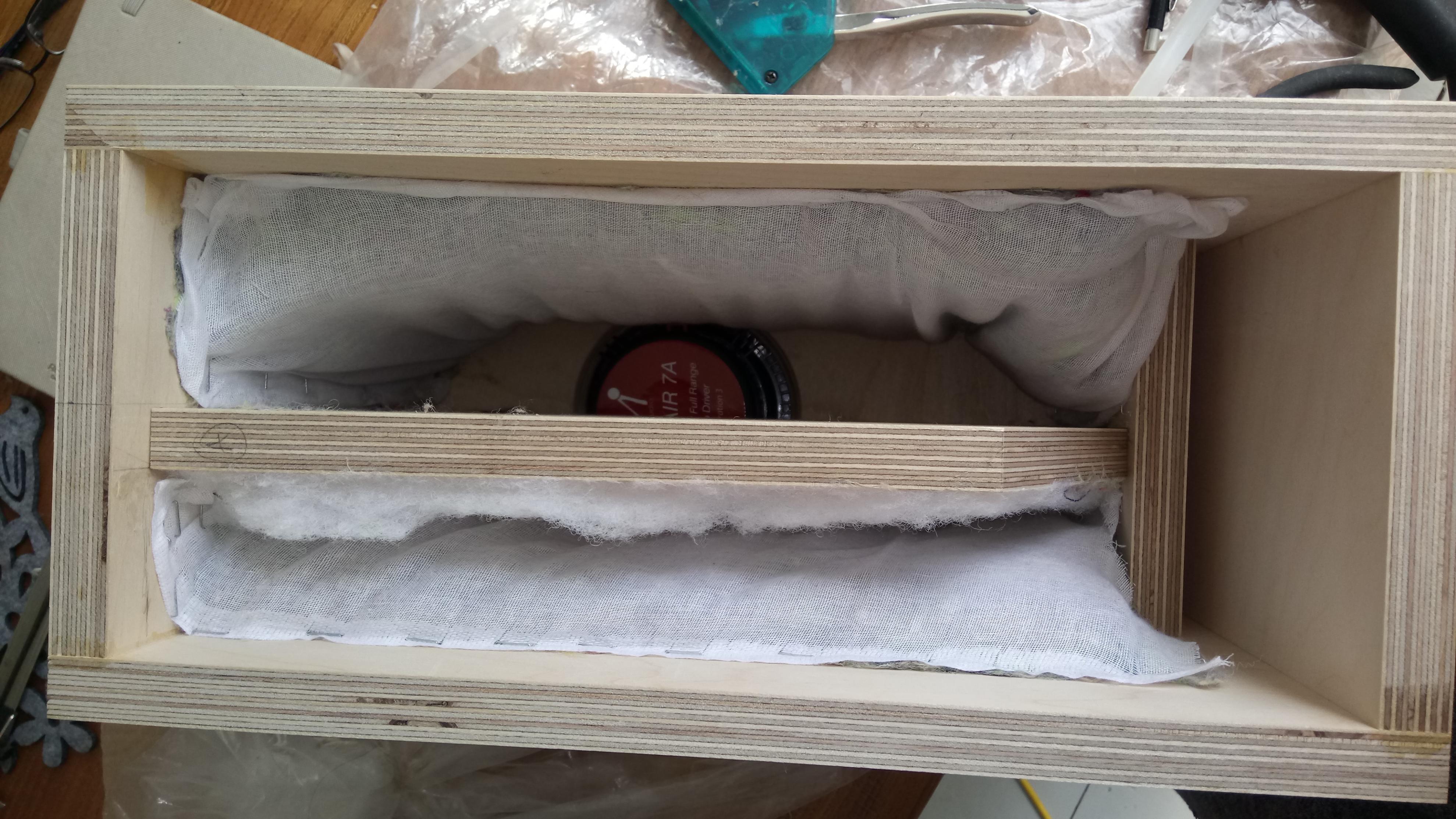

Guys from this picture can you let me know where you place the wadding? I know the slots need clearance but if i wad the rear panel and the sides it will be tight. Also i'm thinking of using the white poly fill on the trapezoids because its a great deal easier to use! That other stuff is a nightmare!
I'll wad the sides here, can i use a thin but on the back panel end to end? or just in the middle? Anyone got pics if the inside of there enclosures?
Where else should i be wadding in this picture? Perhaps the bottom of the front speaker panel and the rear panel. Anywhere else?

Thanks Chris 😀 any notes for me on which panels i should wad? Do i just line every panel making sure not to block ports etc. As you can see in the pics the wool type wadding is thick!
on the trapz should i wad the rear panel and the front speaker panel?

Top, bottom the two inside slot wall panels, front panel notched around driver cut out, and trickiest of all is the narrow section of rear wall either side of vertical divider - most of the others can be friction fit, but those two need some type of adhesive to prevent shifting enough to occlude interior vent openings.
yes. it doesn’t look all that thick & looks lower density than the felt we use so should be thicker.
yes

Initially thick but after glueing and using a few staples it compressed it down, probably why its doesn't look thick.

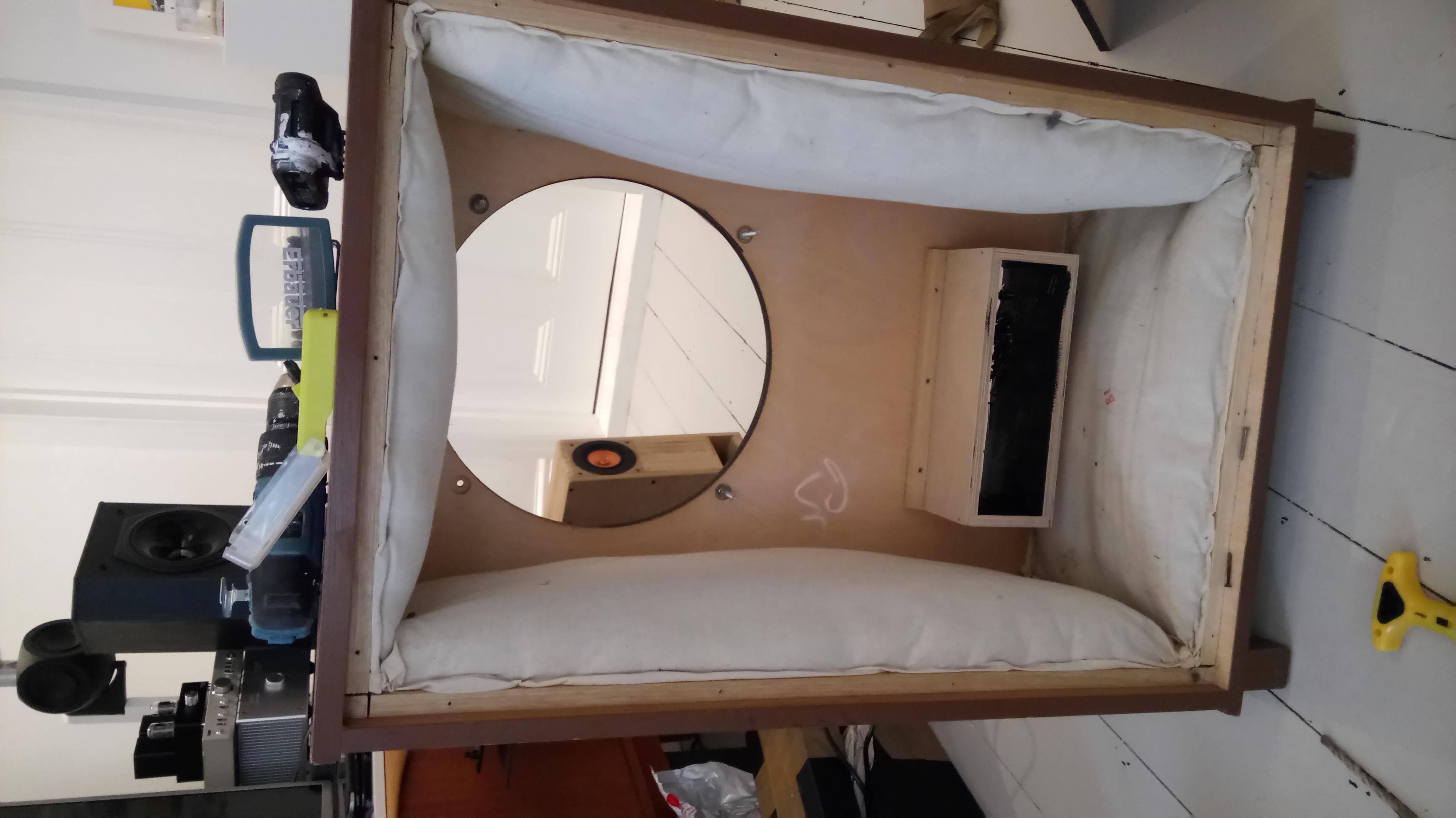

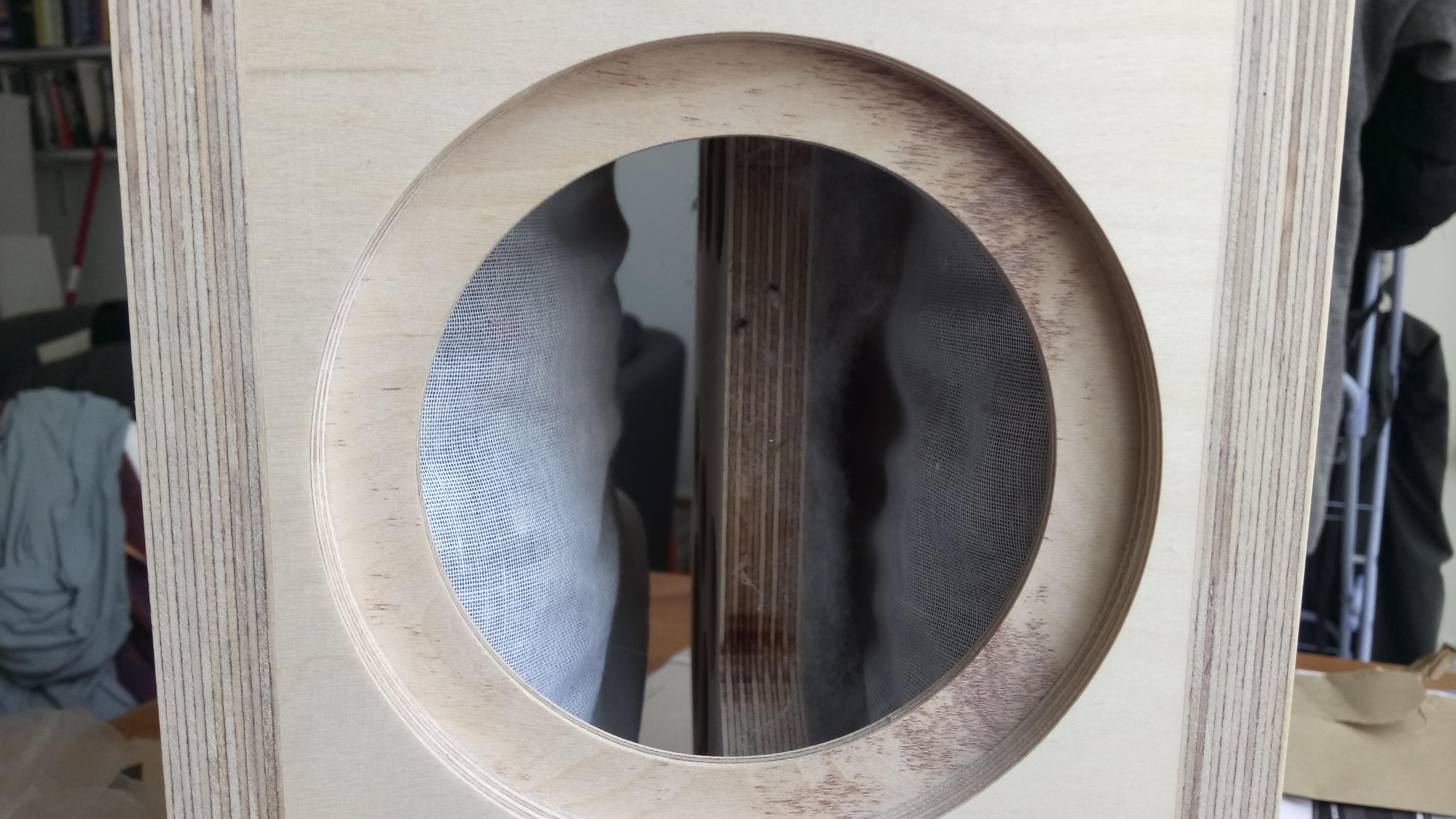

I do love a challenge, ok i am on it Chris! Moving towards my earlier post showing the tannoys wading.

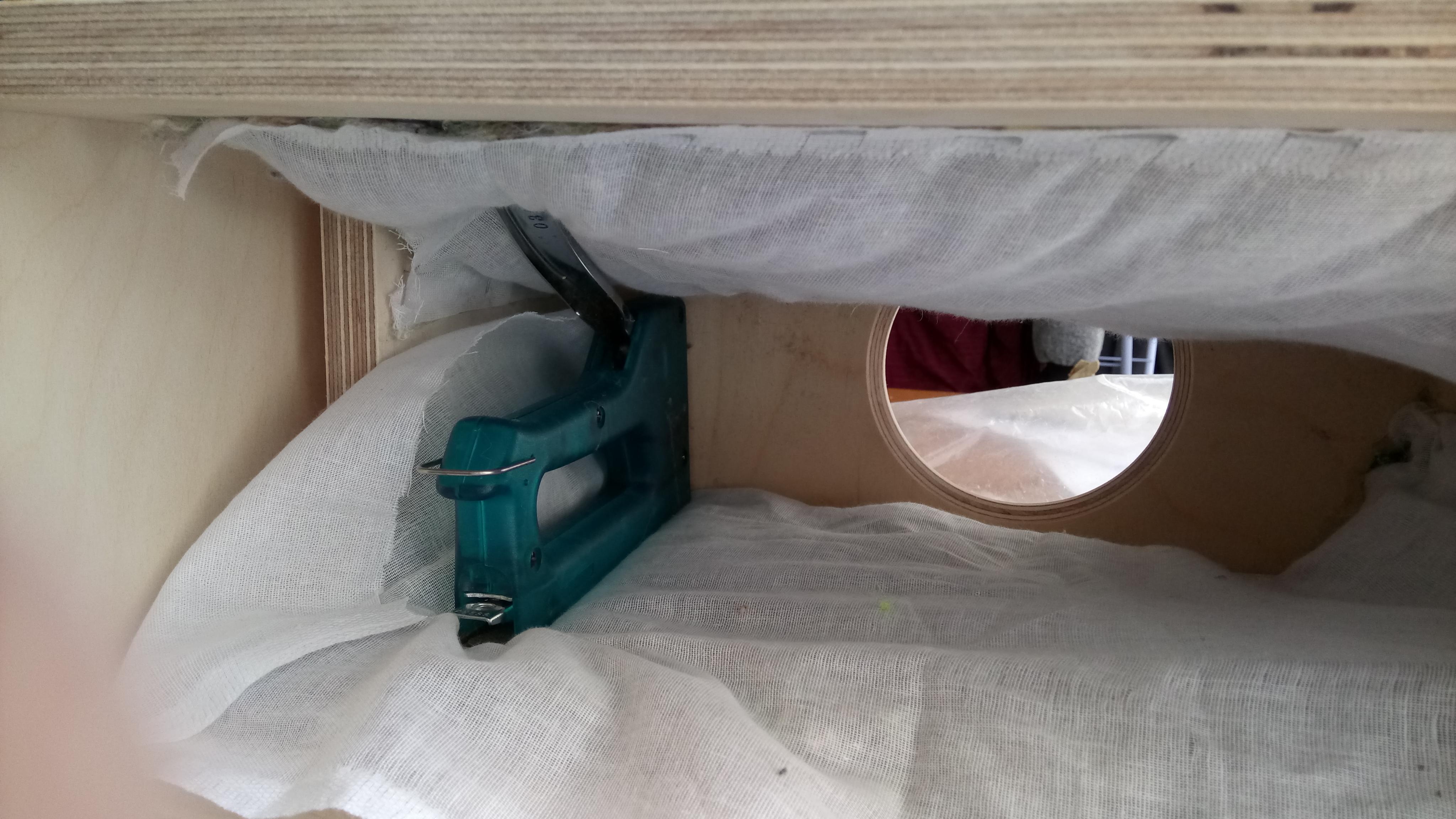

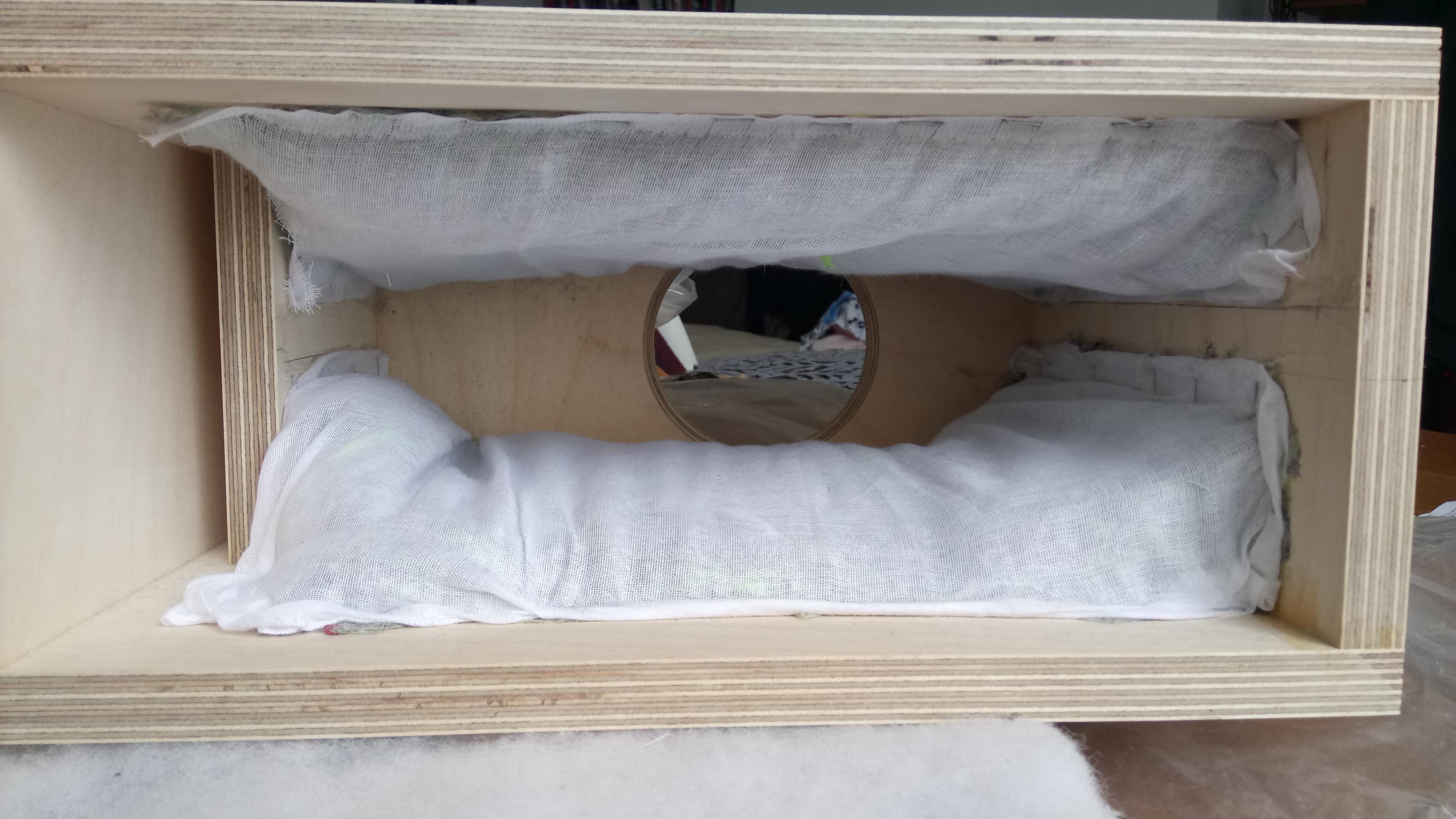

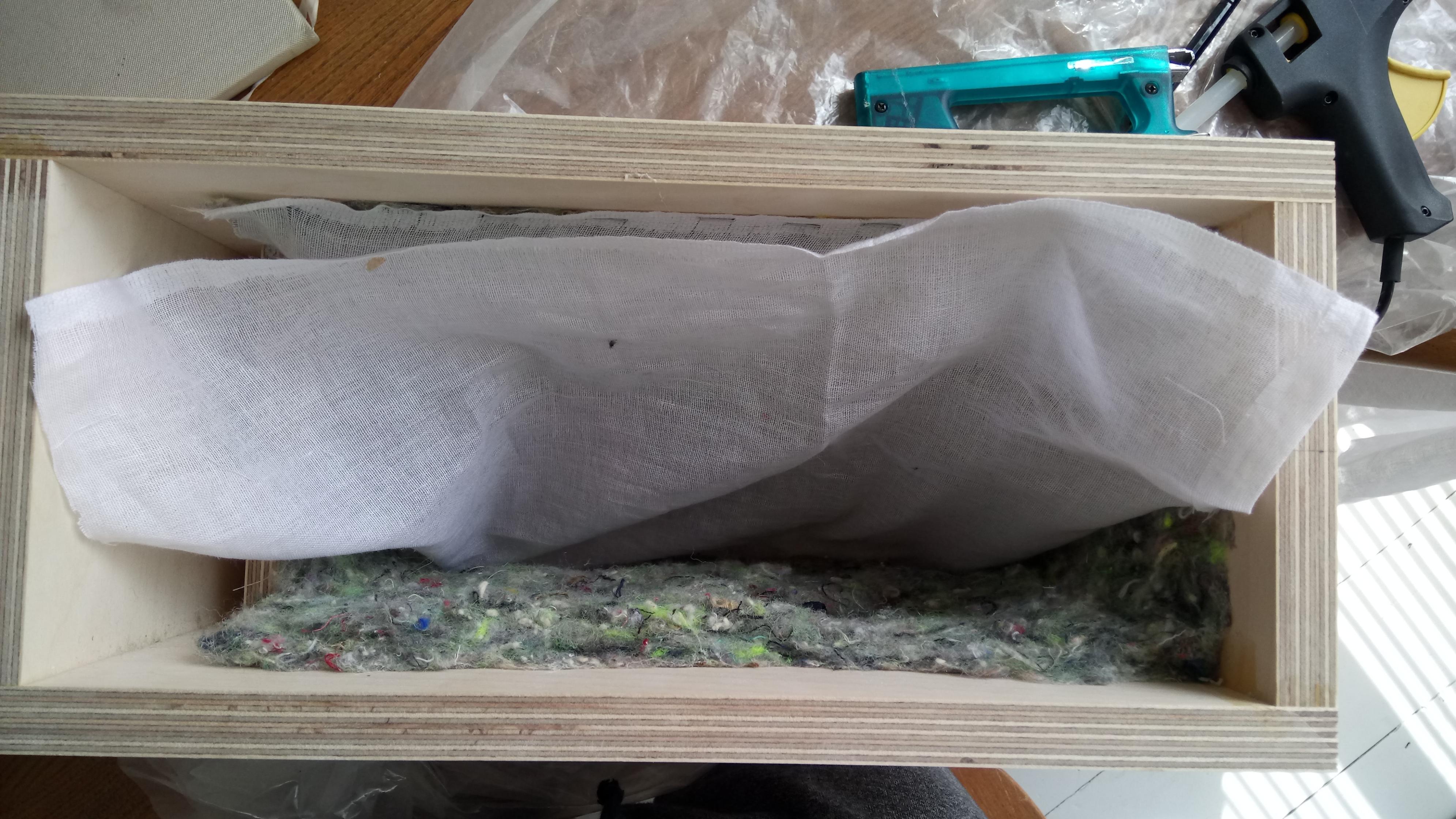

Anyway, here is my update. After finding some time i decided i wasn't happy with the wadding. What made it difficult is my carpenter friend decided to glue up early leaving me with not much space, would've been easier to acoustic wad some of the panels then glue them together.
I wasn't happy with my first attempt and wanted to make it better, ChrisB gave me an idea on using MUSLIN/CHEESE cloth. Eureka moment followed from there, with a bit of inspiration from the Tannoy Lancaster's internal wadding i decided to give it a go. I must say i am pleased with the results, it meant i could place more wadding and keep it all together in a neat and tidy way.

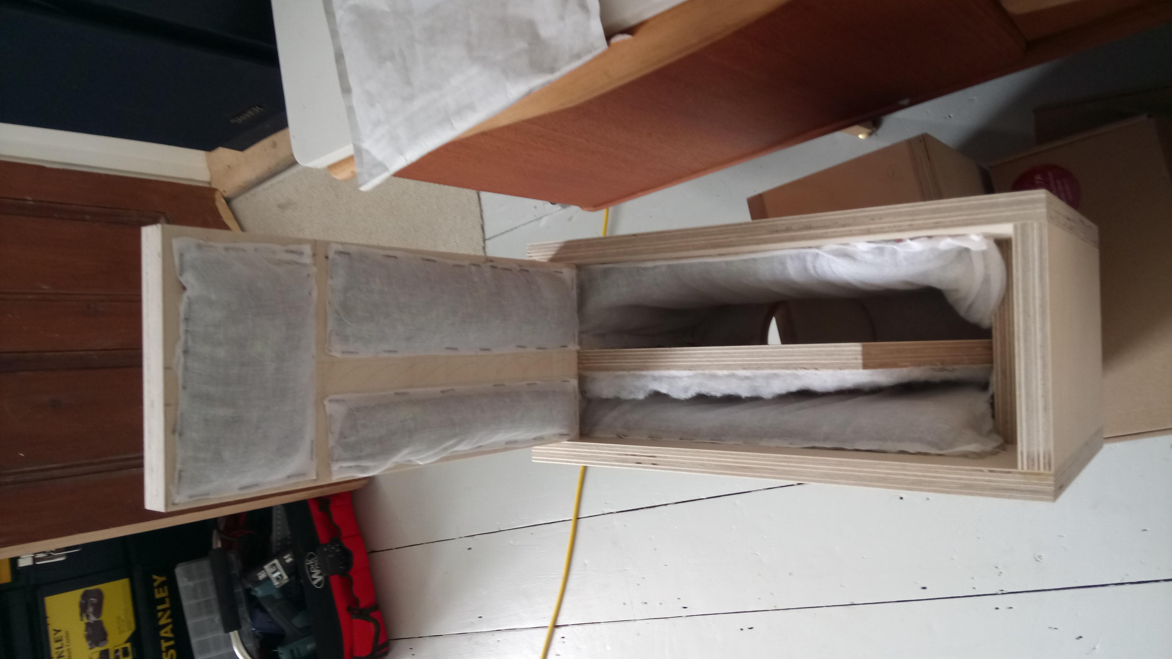

More pics
The upload image on this is being a bore, keeps crashing when i upload more then 2 photos
rear panel
Rear panel wadded.
Before and after picture
Rear panel wadded.
