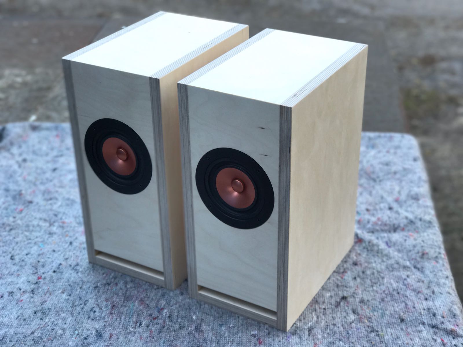

Slims are finished! Lovely to look at and appreciate.

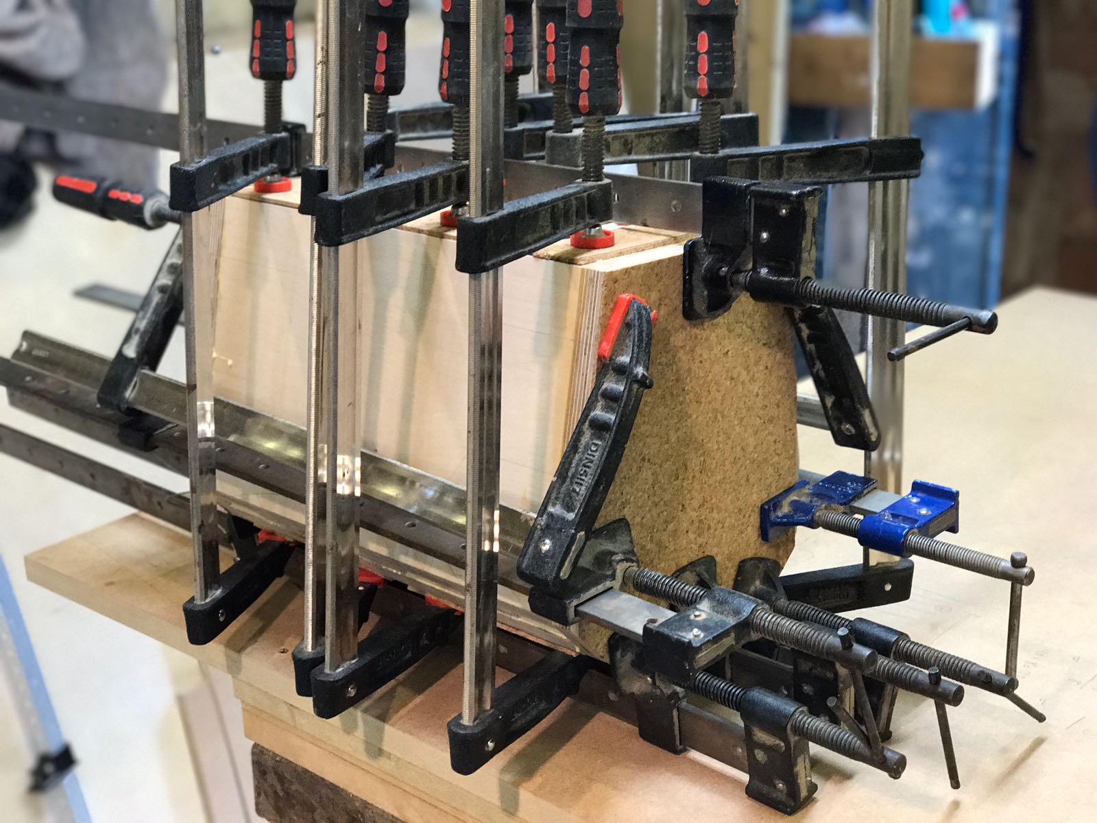

The traps needed this many clamps! Should be dry by tomorrow, then I will be ready to sit back and play some music through them.
I hope you didn't squeeze all the glue out of the joints, it can happen. I don't clamp my joints, just weight them
You make a fair point, enough glue was used and it was squeezed equally all round with until all joints looked sealed and closed, yes a little glue was pushed out but not alot. Made sure of this!

Good, it sounds like you used the clamps wisely to apply equal force all round, glad you were aware of the potential problem. What did you finish them with? I like the colour. Oh, is it just the light, they look a bit blue?
Apologies for being a pest, but I am interested to know....Never understood this, what difference does 2% silver make? What happens if you use normal solder? Does it make any difference if it's silver plate? Why is it ok to use normal solder with gold plate?
The SLIMS have just been nicely sanded and cleaned, think I may just use some form of matt clear finish on them as I like the look.
Right, as I mentioned earlier, I liked the plain BB and didn't want the colour to change, so I used grain filler and wax, that was a few years ago, they still look good
