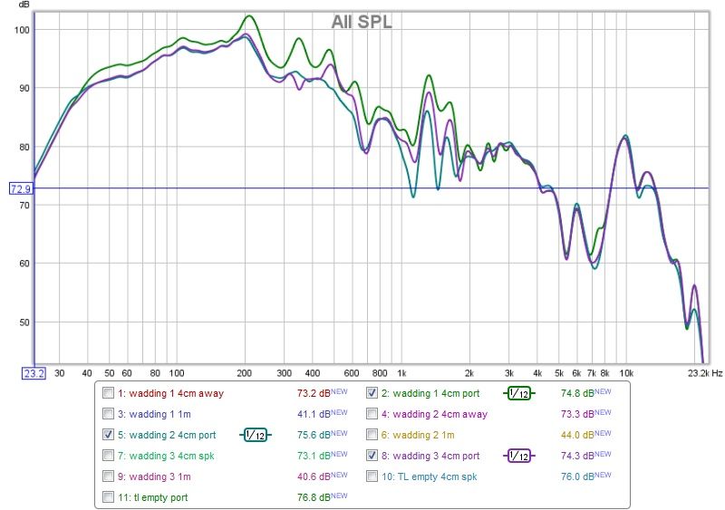

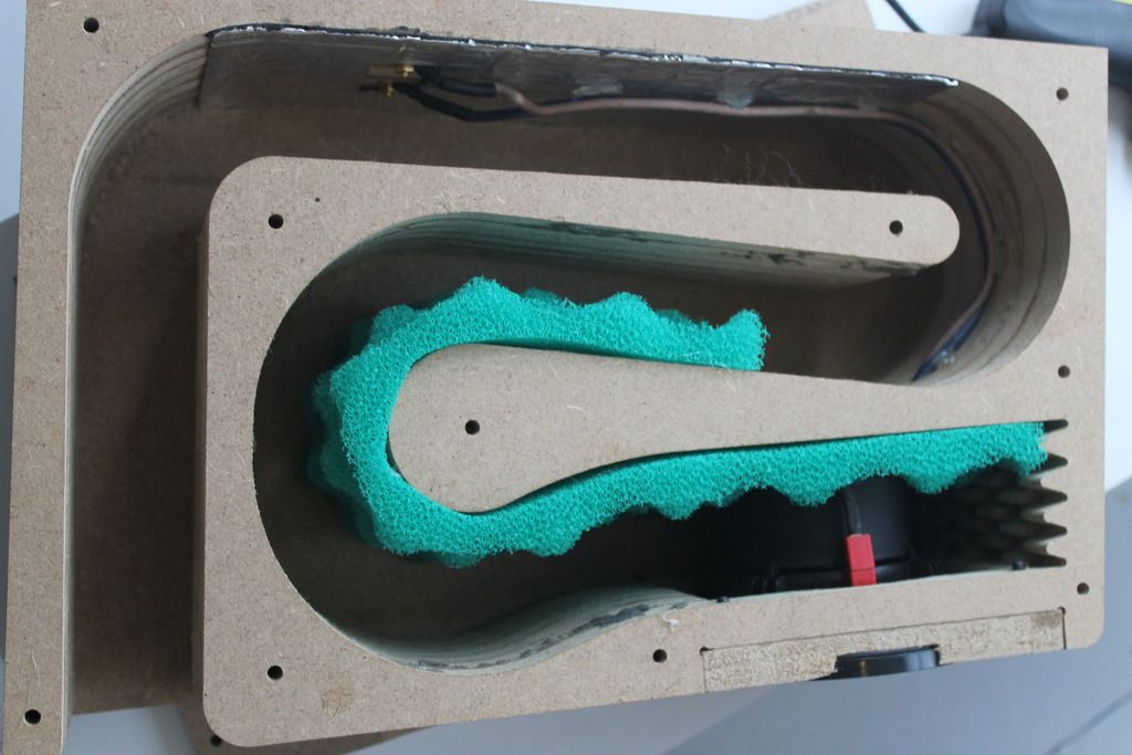

I thought id try different variations and test them both musically (listening playing various types of music) and then of course measuring them on REW.
Acoustic Foam
well not really, its actually a pond filtering kit, still a closed cell construction but the colours have a different porosity. The green being more open and allowing more sound energy to pass through.
I also used general polyfill, for this experiment i'm using the green foam.
This Wadding variation 1
Wadding variation 2
Wadding variation 3
The results!
This is 4cm away from the speaker
This is wadding 1 and 2 vs just an empty TL box 4cm from port
This is wadding 1,2,3 4cm from port

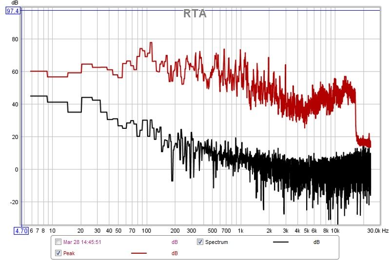

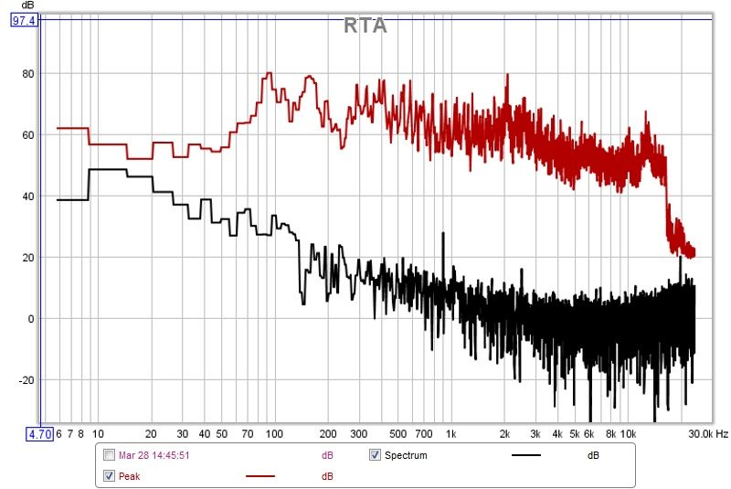

When it came to me i thought why not measure the peaks on the RTA function? I set the mic up to listening height and distance i usually tend to stand in ( generally stand and enjoy the music as opposed to sitting)
Sting played in wadding 2 first 50secs wadding 2
Wadding 3 playing sting
Dire Straights from 1.15 - 2.15mins
Wadding 2
Wadding 3
So guys looking at these which one do you think did best?

Still got a few more variations to do but the results have really been interesting, especially when it comes to listening to the difference.
Think it all comes down to what you perceive and like, theres no doubt in my mind that it certainly changed the way the enclosure sounded and how the music felt.

Notice the overall shape has not changed, but the HF ripple is gone and the curve is smoothed. You should be evaluating at 1m to see the combined effect. There is always a "cost" to damping and it could be overall attenuation (entire curve shifts down 1-2db) or curve looses frequency range. As you say it comes down to our preferences. Nice to be able to tune the system.
You can artificially remove the HF bump at 12Kz if you're source is a PC or something with a S/W equalizer. Usually there's a 8KHz and 16KHz band that you can use to flatten that bump to see if its affecting your perception at listening distance.
Acoustic Foam
You sure? Regardless, closed cell is defined as being >90% closed and open cell > 50% open, so what you want to use.
GM
GM
True, what i meant to say was its the same material just different grades of opening? Does that make sense?
I have four types, one is completely closed then the rest start to be more open.

I can't tell from that type of graph (RTA). I think if you played pink noise, and used the room graphs (RTA) to do your EQ as it indicates where (in general) room absorption is occurring.
lol how did you know i used to hustle? I was only kidding about what you think sounds good.
Still goto learn how to do room graphs and how to determine room acoustics and absorption.

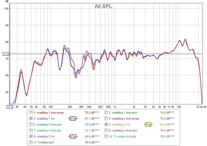

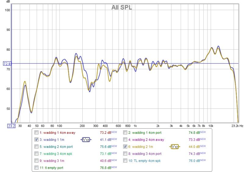

I forgot to put these on!
Shame about the dip at 42, probably the room though
it is a shame maybe i should try a different location or like DonV suggested use stands and go 1m away from the wall.
But then again its not realistic, as thats where my speakers are and will have to stay.
Anyway next on the list is to build some different enclosures and see how they sound and work in the room.
I agree with Scott, those dips (at 45Hz, 125Hz, 250Hz) look like room modes. BTW you cannot remove room modes at the speaker, you treat (adjust) the room, or move your listening position, or live with them.
Have you tried the REW <Room Sim> tab to see what modes are where they should be in your room?
Overall it looks impressive and its a single FR from 55-20Khz ish. Your freq axis looks odd ending at 23KHz
You will always have room modes unless you live in an anachoic chamber or an open field.it is a shame maybe i should try a different location or like DonV suggested use stands and go 1m away from the wall.

Yes, I see you've recently found and itch that needs scratching. I will watch with a voyeuristic interest
Exactly on both counts.They can be very localised, you are not going to be listening at 1m! You can cut, but don't even be tempted to try and boost a dip, it's like a bottomless pit haha!
Some of them don't bother us and we live with them. Mostly we reorient the speakers, or move the listening position, or move some furniture.
