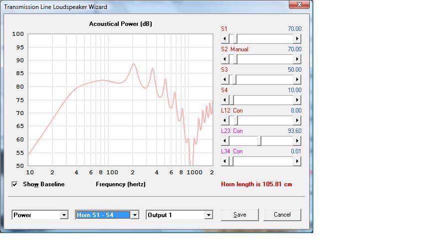

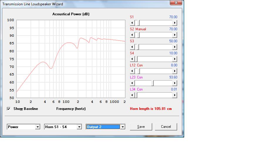

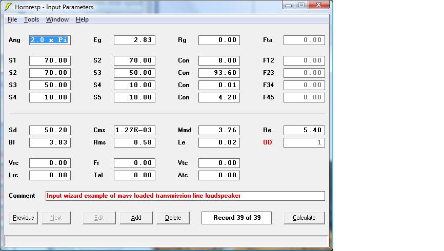

Here's what the ML-TL looks like. Similar with harmonics. Shorter pipe required. Some damping is required.

The pics below show a long BR with the driver output, port output and combined output.
I think this breaks the HornResp model for a BR due to its aspect ratio (boxish vs long tube). As Chris661 correctly points out, the shape is really an ML-TL, so I included that one as well, perf is similar but has harmonics in it which is probably more reality.
