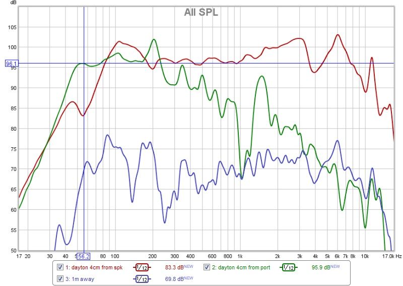

Is the volume the same?
The combined looks like a very similar curve only shifted due to a volume change.
Nothing changed just the adaptor for the ML TL
OK, thats odd usually the mid-high freq should not change unless the distance to the mic has changed or the volume has changed.Nothing changed just the adaptor for the ML TL
The distribution between driver and port will change, that's evident in the graphs. Its very hard to visually add curves that differ significantly and are logarithmic (db) because 80db+65db=approx 80db because a signal at -15db difference is only adding 3.1% so its very little.
I would pick the TL all else equal. Odd still, the driver output levels are very close >200Hz but the combined output shifted?
It'll interesting what you think from listening.
Yes, but they have different frequency axis so its hard to visually compare, and the volume appears to have shifted. The port / driver distribution is different, thats OK, I look at the dominant signal of the two at a given freq when trying to visually combine outputs. The mid and high freq should not be affected by the tuning.Are we looking at the same graphs?!
There's clearly a huge drop in output from the port above 100Hz with the ML-TL adapter in place.
The bass tuning also appears to have gone down half an octave.

The LF extension (1/2 octave) I do not believe. Even 50Hz from this driver is amazing, and with a 1.2M pipe its unlikely to produce 30Hz. Thats from something else in the room.
The combined response graph that has both MLTL and TL is more like I would expect, very similar. Except the volume shift is unexpected.

Dayton ND105-4 test
Think that shift was due to me accidentally putting the volume up!
Anyway thought you would find this interesting, thought id change the driver to one i had laying around.
This is a Dayton nd105-4.
The readings

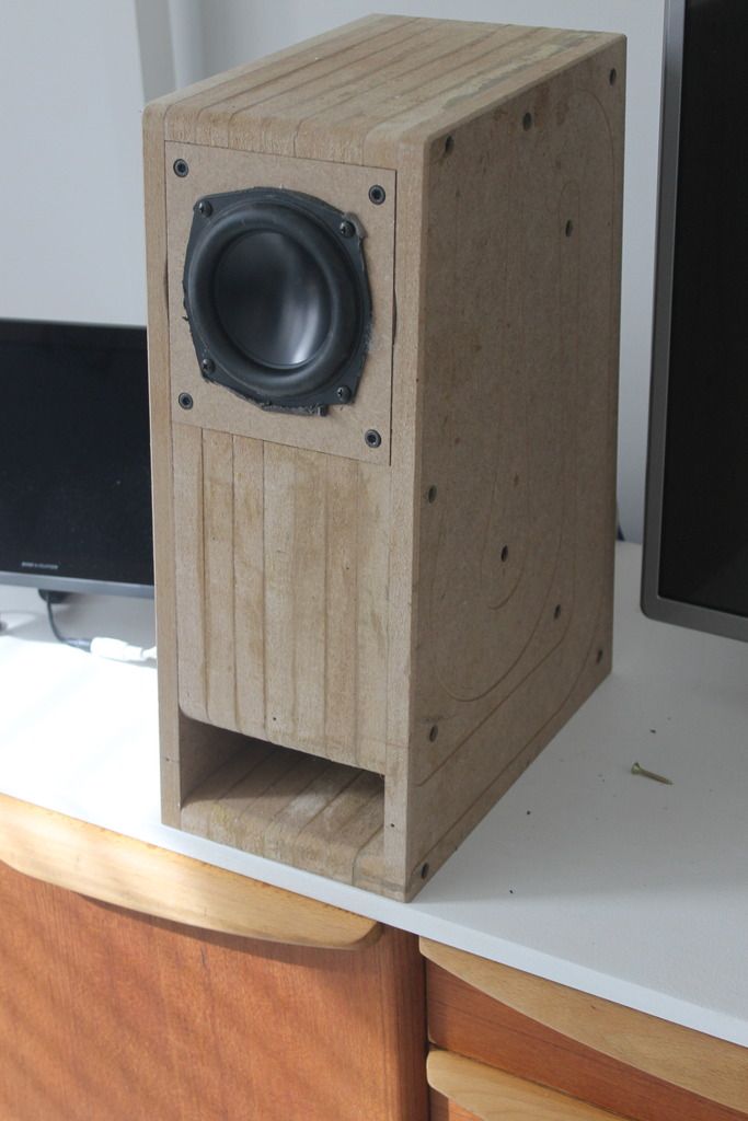

Didn't sound right the MLTL conversion, the music sounded restricted in a way when the volume was pumped up, some songs made it feel like the speaker was under pressure.
Definitely needed to breathe more, the bass and mids sounded muffled, soon as i took off the adaptor plate it sounded soooo much better.
What you're describing might be what some people refer to as "boxy". I've heard its a reason some people to go TLs and horns.Didn't sound right the MLTL conversion, the music sounded restricted in a way when the volume was pumped up, some songs made it feel like the speaker was under pressure.

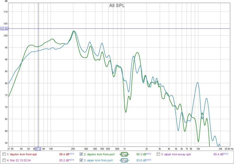

However, its clear from the graphs that the enclosure design and room are dominating the LF performance. Just as it should be. This might be this is as good as it gets with this enclosure design. The HF ripples will go when damping is added.

Vishalk, you are a gold mine of data.
The same enclosure, significantly different driver (Dayton MidBass) and the results are similar for LF. This indicates the enclosure and room are dominating them. The FR Alpair performance beats the specialized Dayton everywhere, that is an amazing driver.
I'm assuming there is a difference volume that caused the shift because both drivers are approx 85db/W.
Even thought the results are "similar" at LF and MF (volume adjusted). How did the sound compare? There is very little music power above 10KHz but the Dayton's ripple in 4-10Khz may be audible.

Chris this all for fun and learning , don't discredit the enclosures just yet, they are doing a great job so far. The Alpairs are amazing and have proved this from all my current testing, and actually they sound really good even in this MDF TL.
But yes i am going to build and try a different enclosure.
My thinking was to build these
Slim Classic GR dMar-Ken7.3 2v03
http://www.frugal-phile.com/boxlib/P10free/CGR-dMar-Ken73-190216.pdf
I will also build a simple bass reflex box
Alpair 7 Gold | Markaudio
Ill do the bass reflex one first as its a simple build.
The main aim is to find which enclosure suits my listening needs and gives me the performance i desire based on listening and using REW for measurements.
