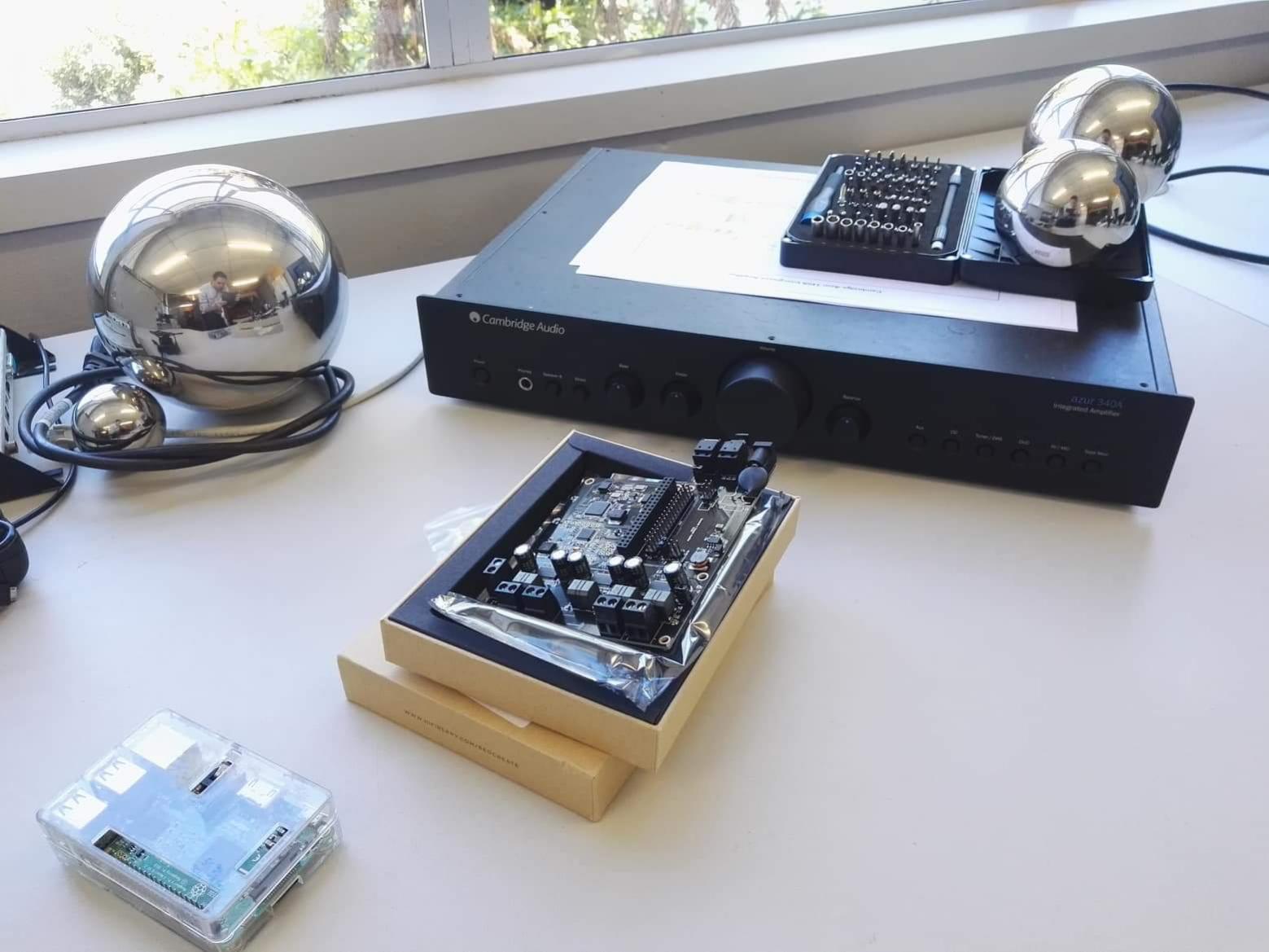

UPDATE! - Sorry for the long delay
Hi All,
Sorry the stuff actually arrived a few weeks ago but totally snowed under with work so wasnt able to get anything.
Everything arrived more or less as expected. The compression driver had a tiny bit of damage but minor.
The spheres were of surprisingly good quality for the price.
away on a business trip for a week soon but will get back into this once ive got the time.
Cheers!

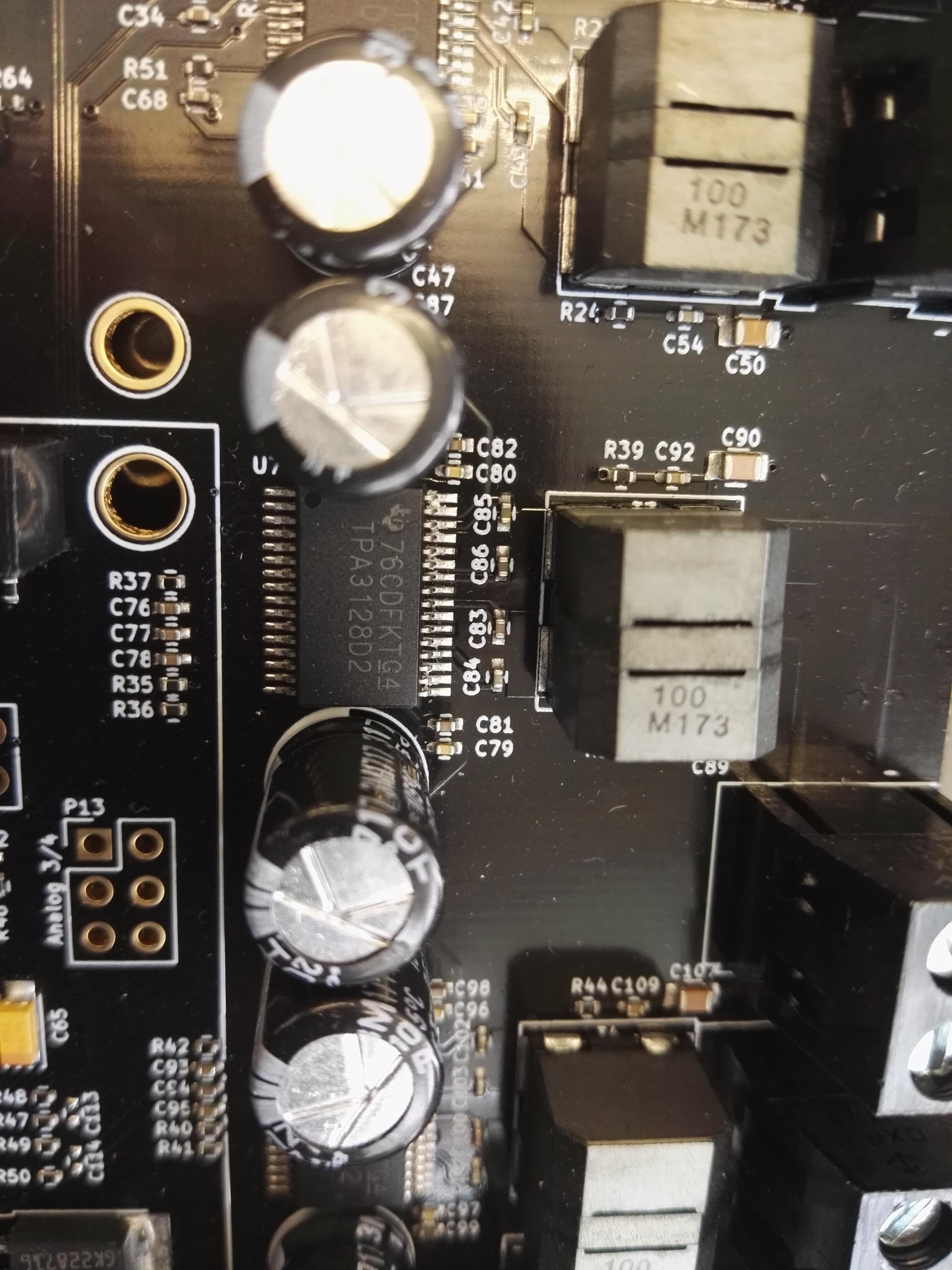

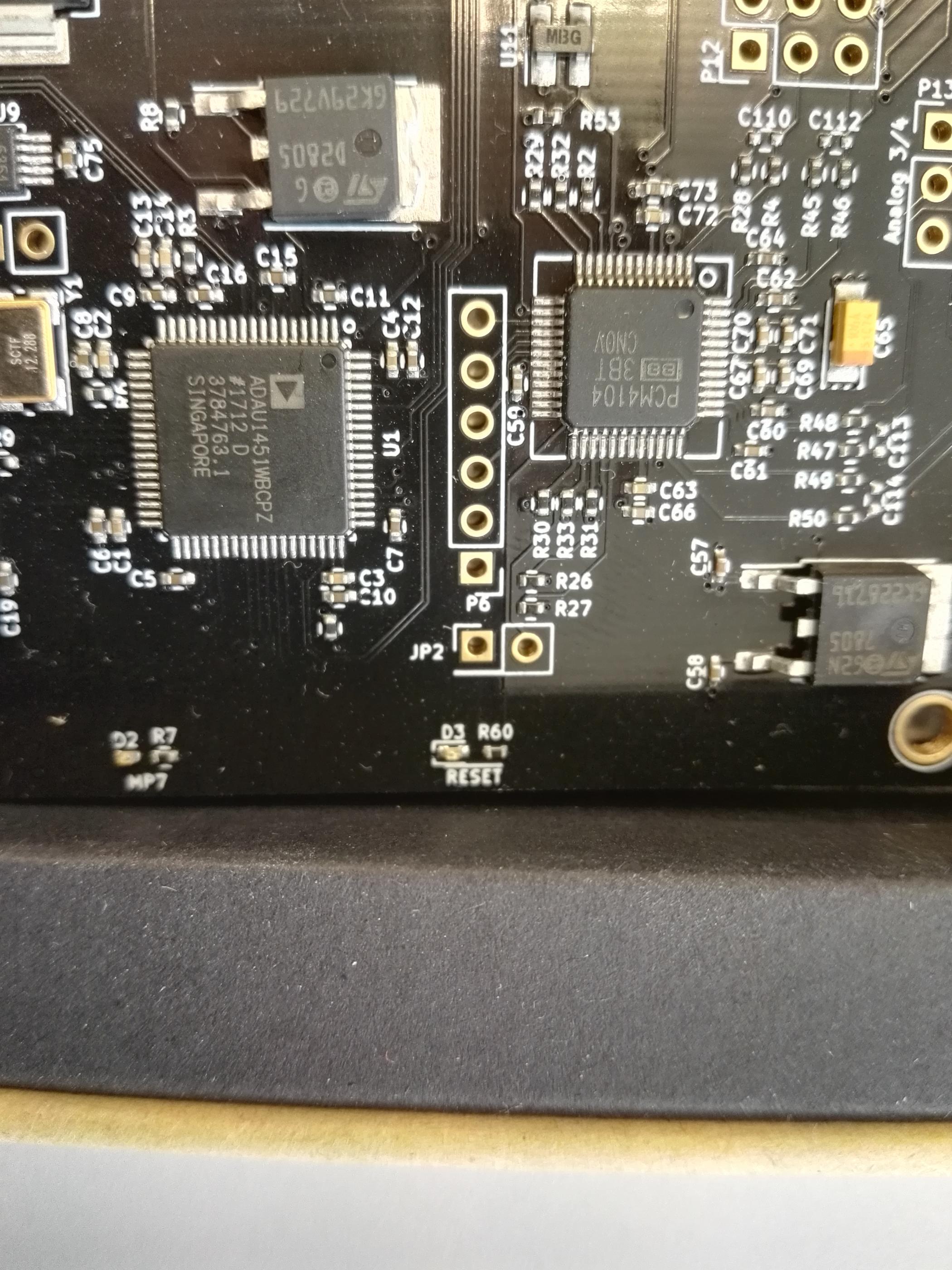

Has the ADAU1451 onboard as well as the PCM4104
See photos attached,
Need to put some work into this just haven't had any time lately, but holidays coming soon so hopefully....

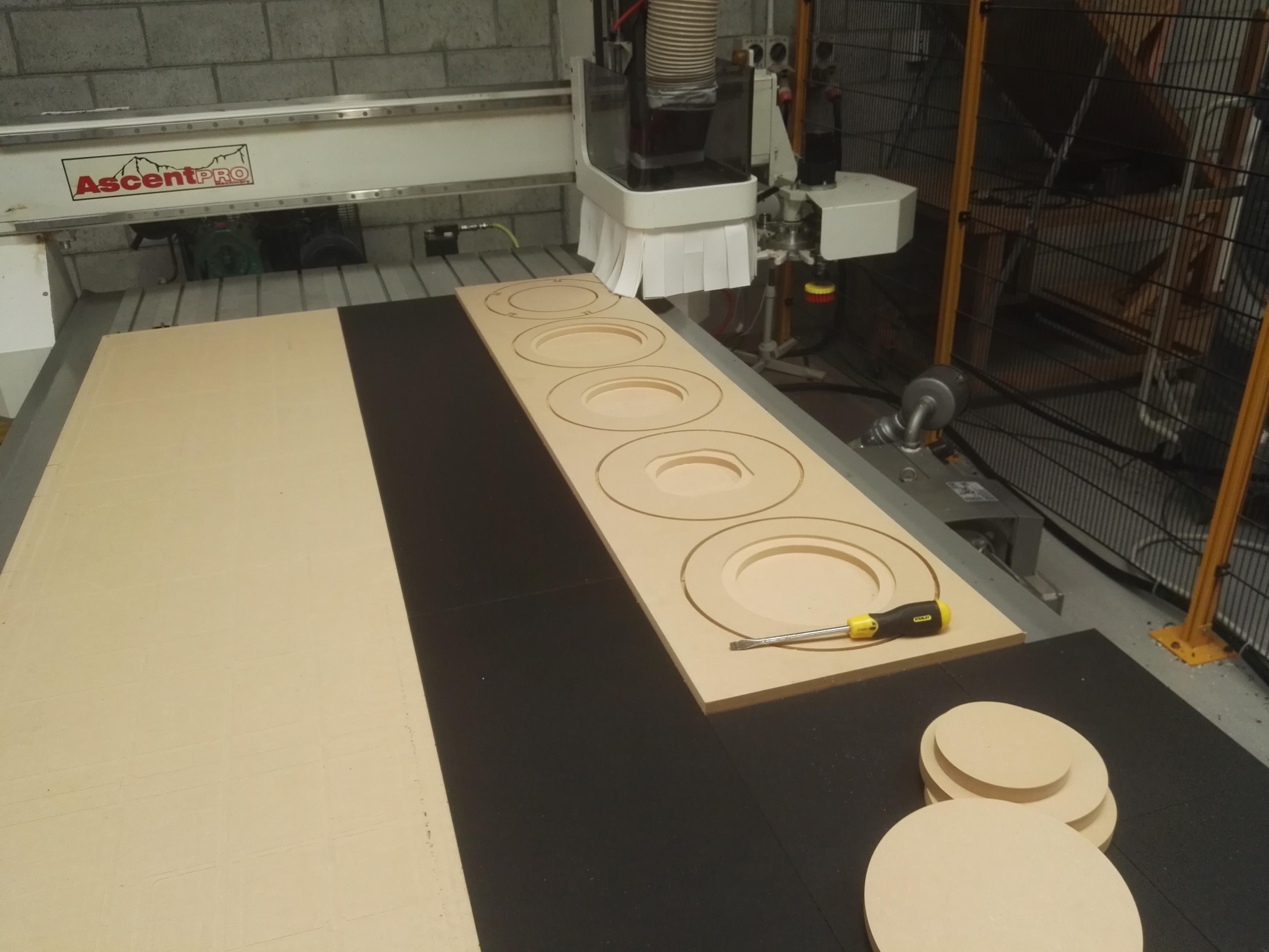

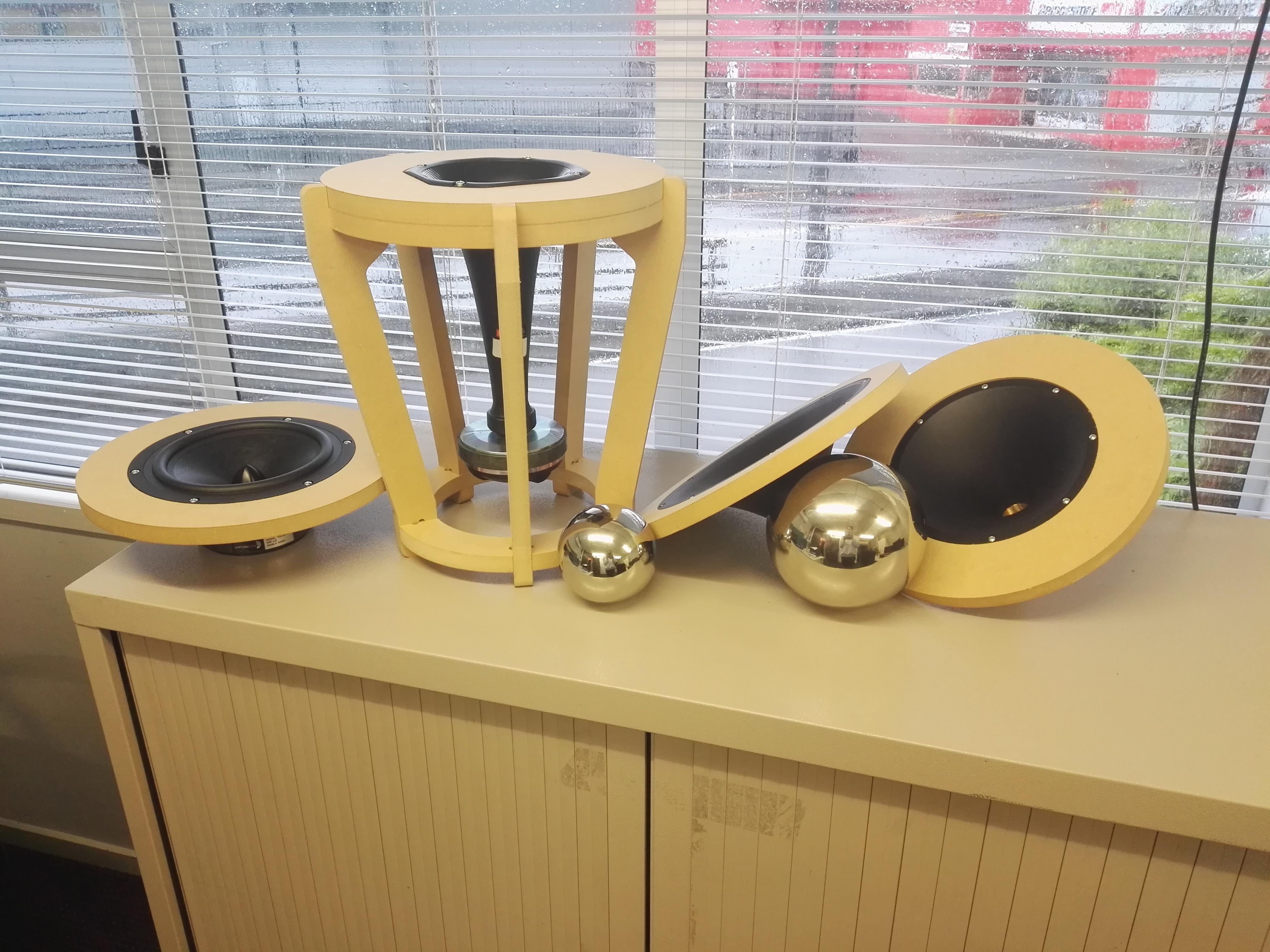

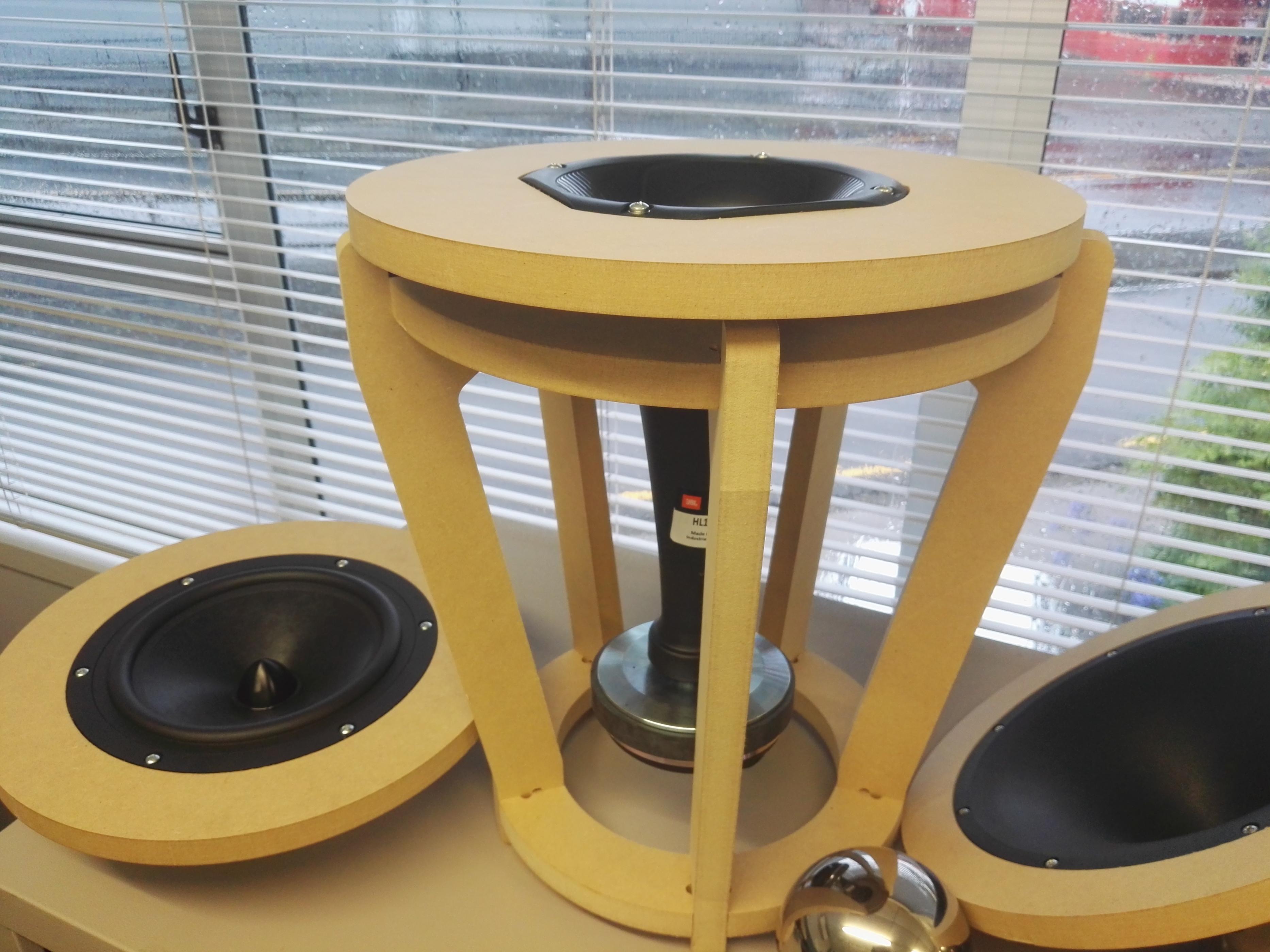

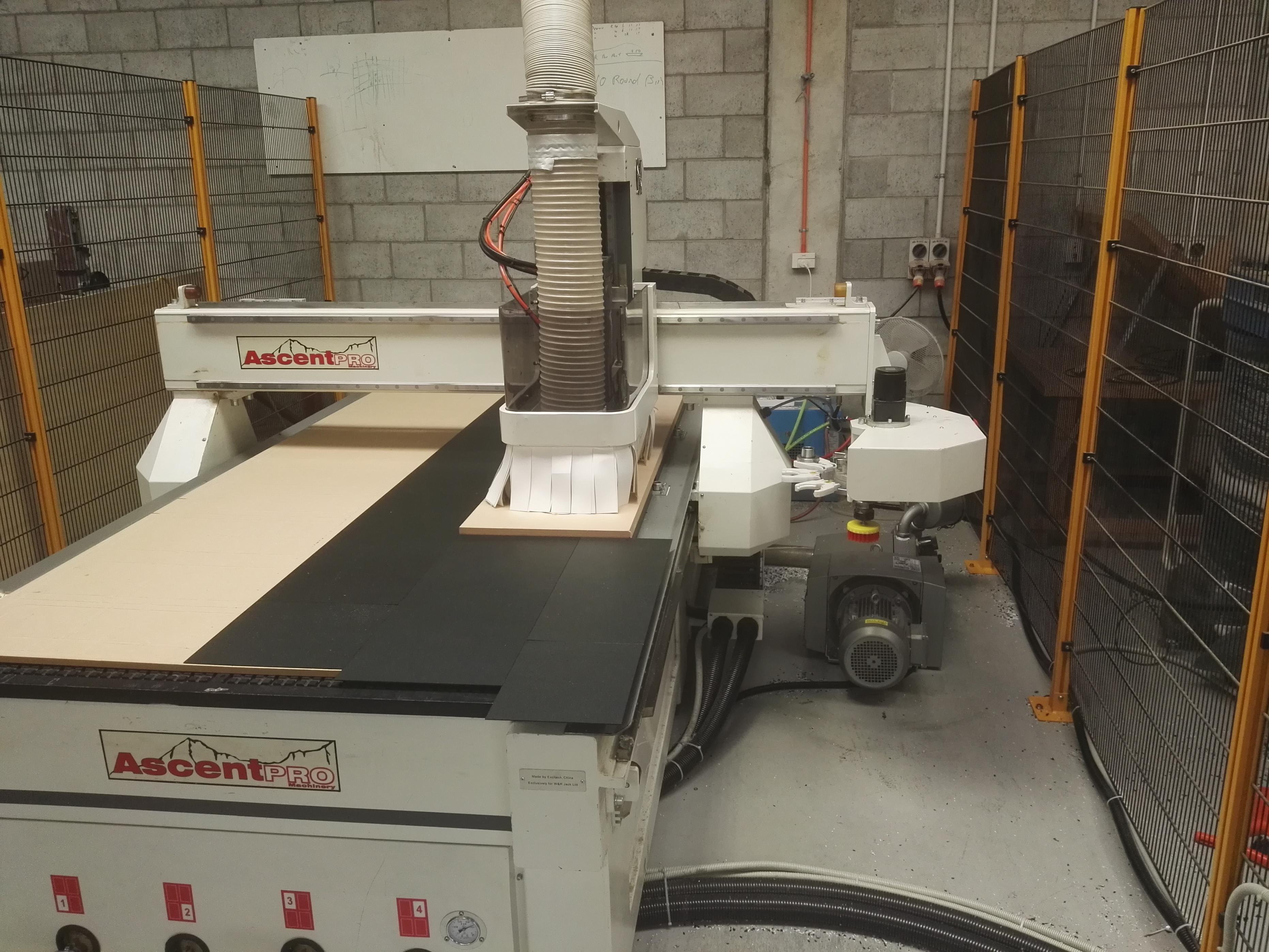

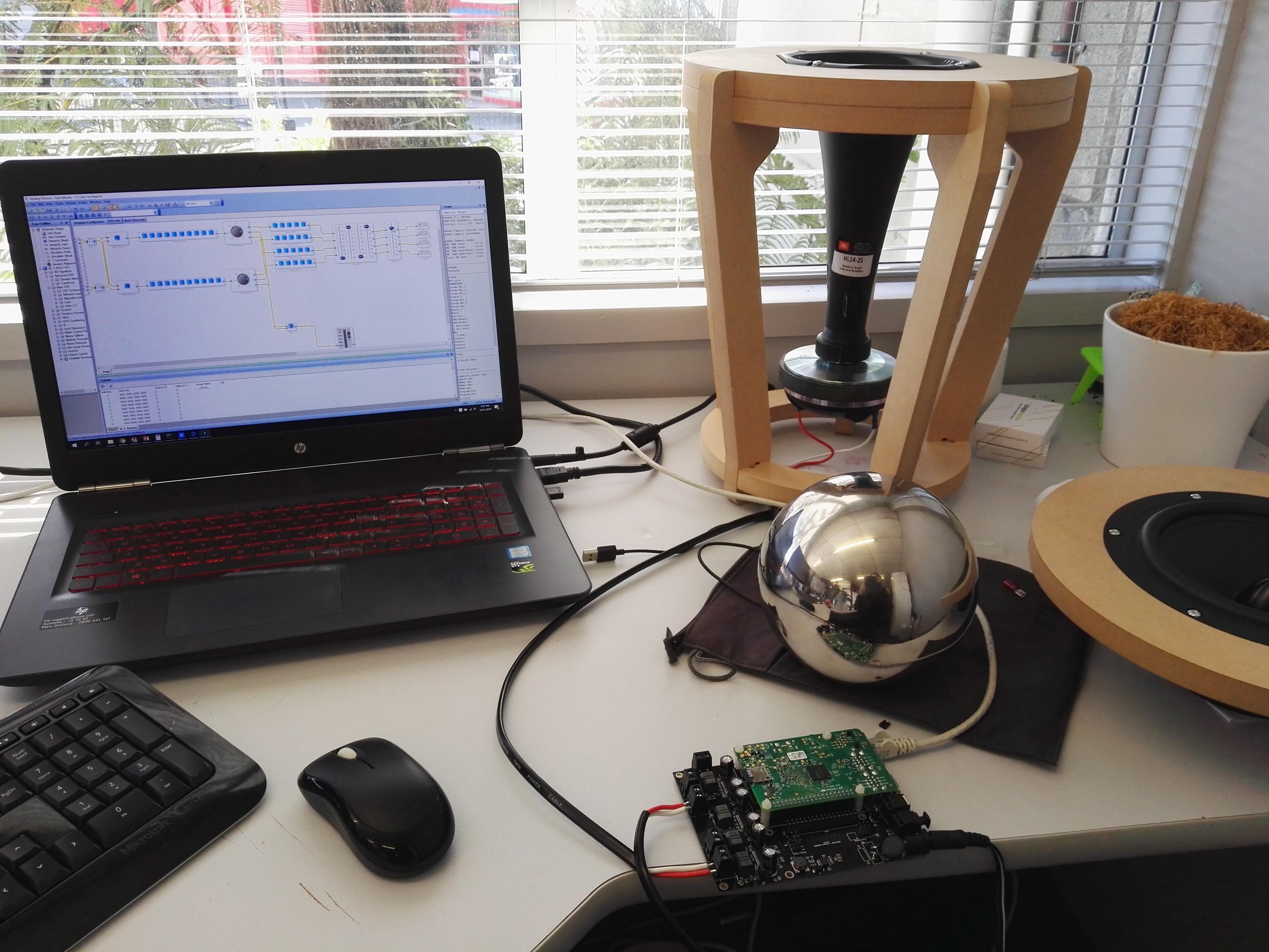

New year, back at work after the break and finally put some time in on the CNC.
Just made a stand basically to hold all the cones (and woofer) at equal height during testing. The top ring pops out and can be swapped for the other horns etc as seen in the photo.
Will set up the software on the raspberry pi and DSP in the next few days. Hopefully will be able to start measuring response this week or next.

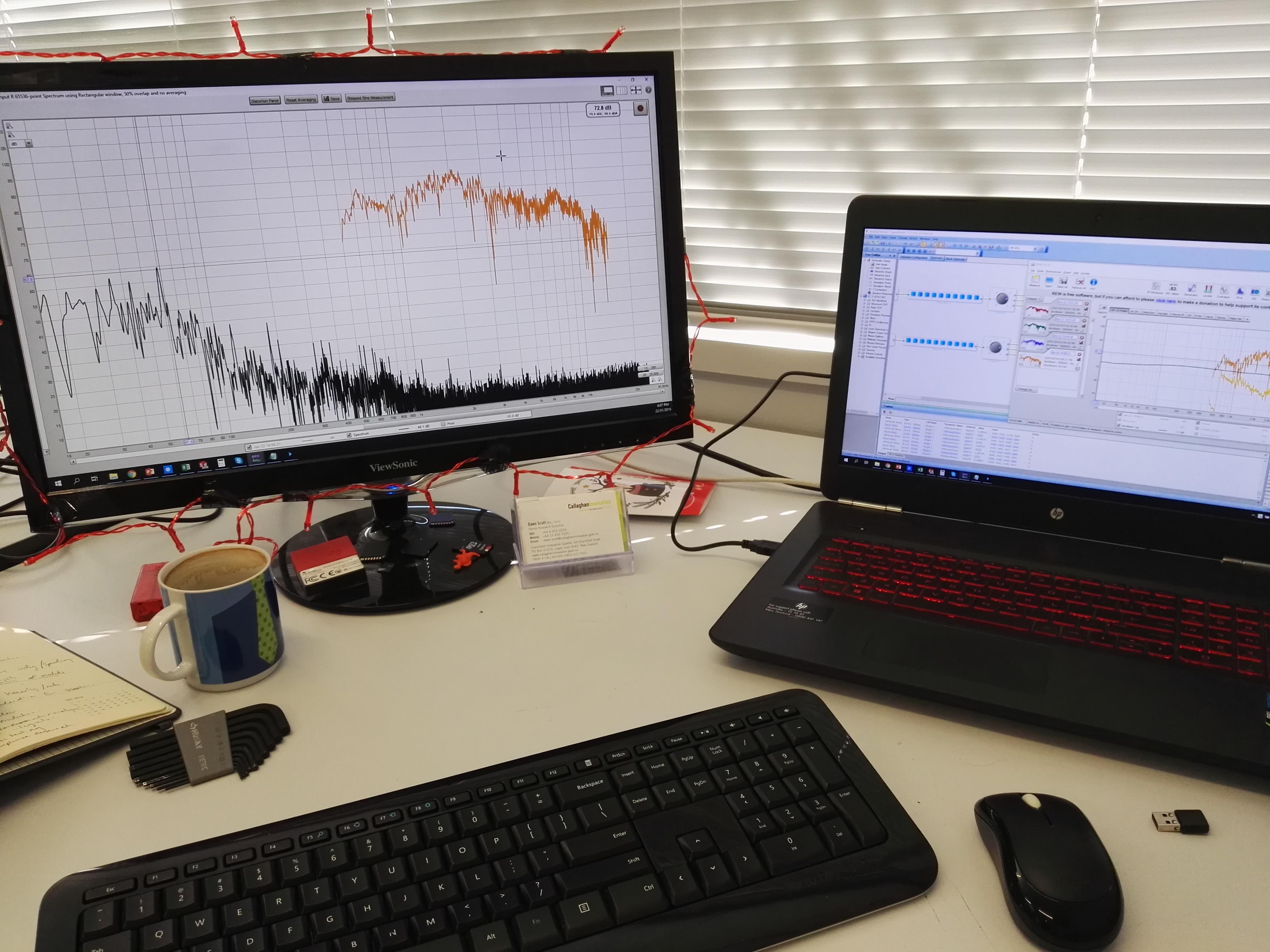

Did some messing around last week,
Got the amp going. The Beocreate software is a bit clunky and it took a few tries to get the image on the raspberry working, but seems to be ok for now.
Installed SigmaStudio and had a play with that - all working and the real time updates over ethernet are quite handy.
Got REW running - still getting the hang of it but can take basic horn measurements now.
I also went out and bought a Behringer UCA222 interface (the cheapest i could find) in order to have an optical audio output from my laptop, as the Beocreate has no analog in, and the only other options were bluetooth (buggy) or airplay. The optical interface is fine though.

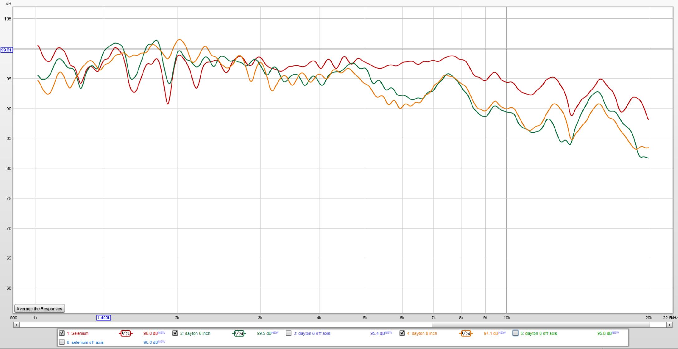

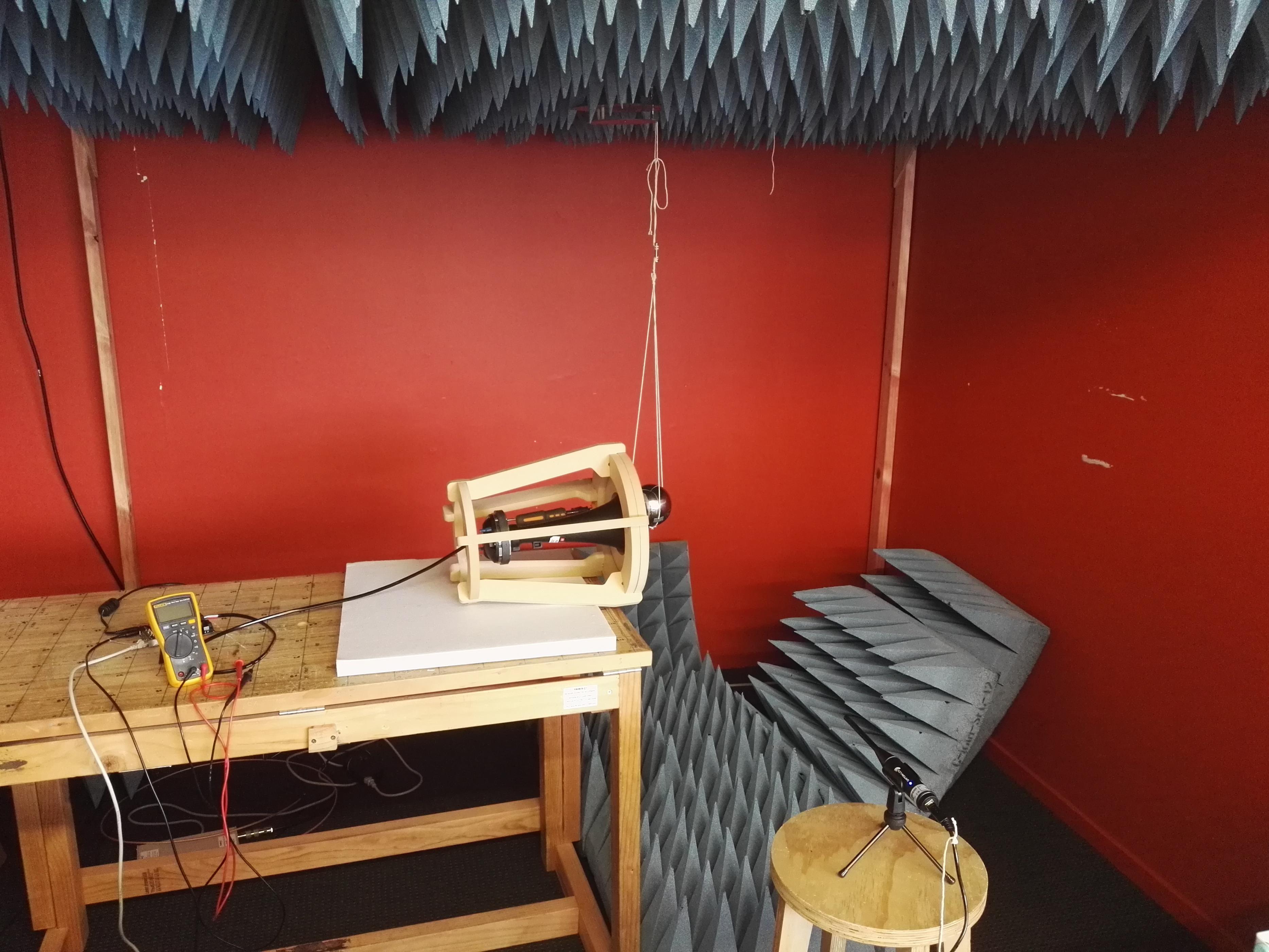

Did more horn tests.
Firstly did a basic 1m on axis sweep, results below. was done at slightly less than 1w into the CD for reference. The Selenium/JBL horn seemed best, and the 8 inch Dayton horn seemed ok as well.
Didnt include the plots, but the JBL horn was a lot more directional and had much more falloff on high freqs when off axis. the 8 inch Dayton was ok.
Did some very rough ball tests - photo of the setup. Didn't really know how to do it, but the setup shown roughly allowed to simulate a reflective back wall and ceiling, and gave me some flexibility with mic position.
I was just playing around, and tried most sphere size and position tests, you can see the results vary a lot but there is an obvious trend.
Worth noting in most of the cases the effect of the sphere was minimal, and a similar response was measured when the sphere was removed, and the mic position remained 90 degrees from the direction of the horn.
The only worthwhile difference was when i had a 300mm sphere offset from the center of the horn, so that it was much more directional - that is the highlighted measurement in the images.
Still no woofer tests, need to do the enclosure.
Perhaps an angled or curved plate of steel/aluminum would be a better reflector. Not quite omni, but still.
Welcome to any thoughts or suggestions

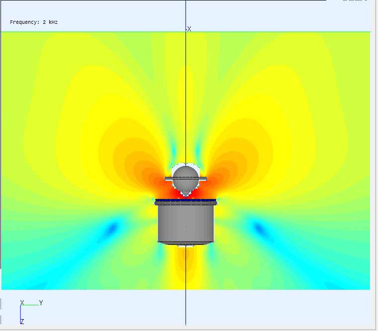

Hi. Interesting. I tend to agree, even a straight sided cone would be better than a sphere. The more directional high frequencies, will tend to be reflected back down, others will curve around a sphere and be reflected off the ceiling. You have to ask yourself, how many omnidirectional speakers out there use a sphere as the reflector?
Yea i did a few measurements where the mic was about 45 degrees to the horn and i agree, it seems as though the high frequencies appear to curve around the sphere.
Will be interesting to see how the woofer/sphere combo behaves, but definitely seems less than ideal for the horn/CD.
The Duevel Enterprise speakers look like they have a more suitable reflector for the HF

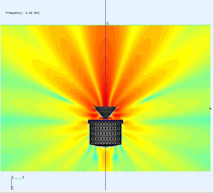

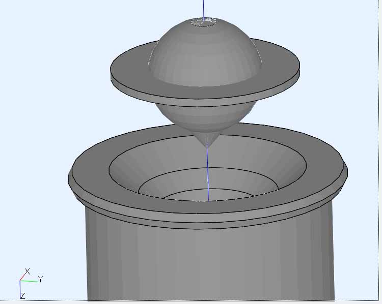

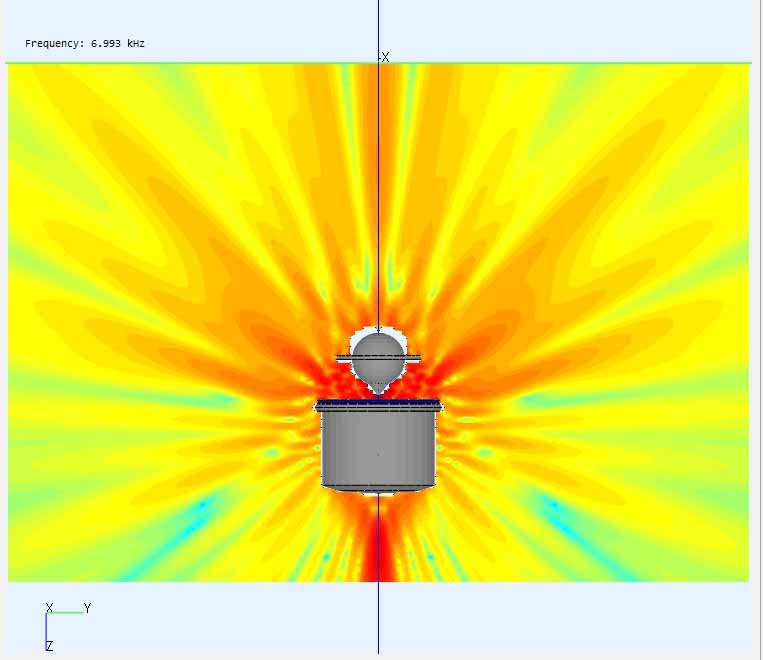

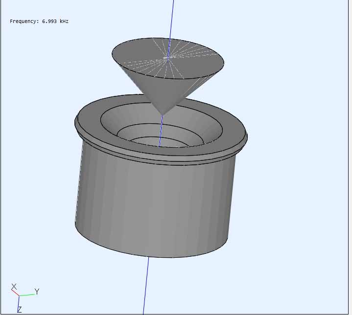

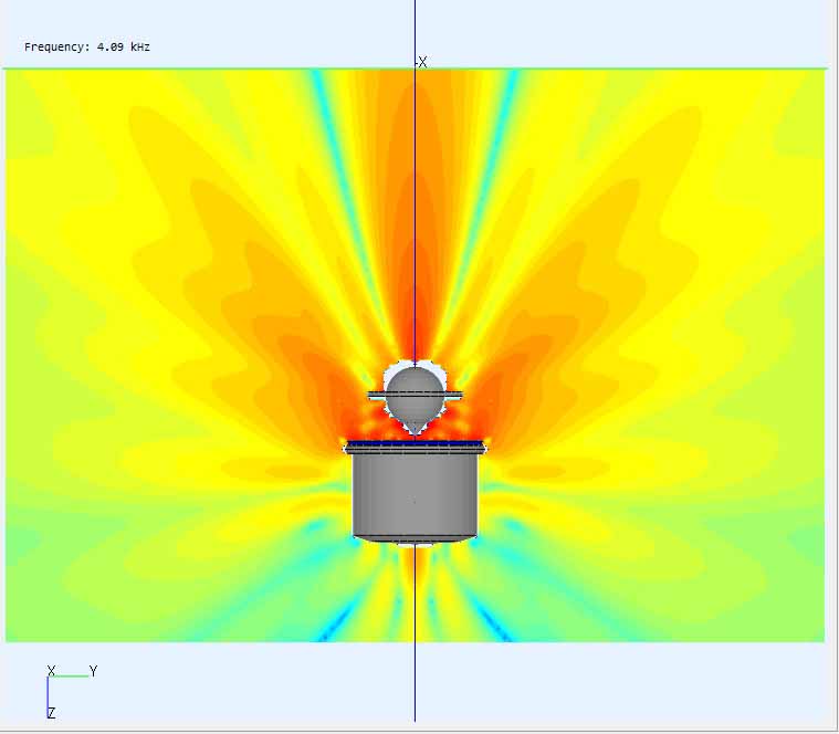

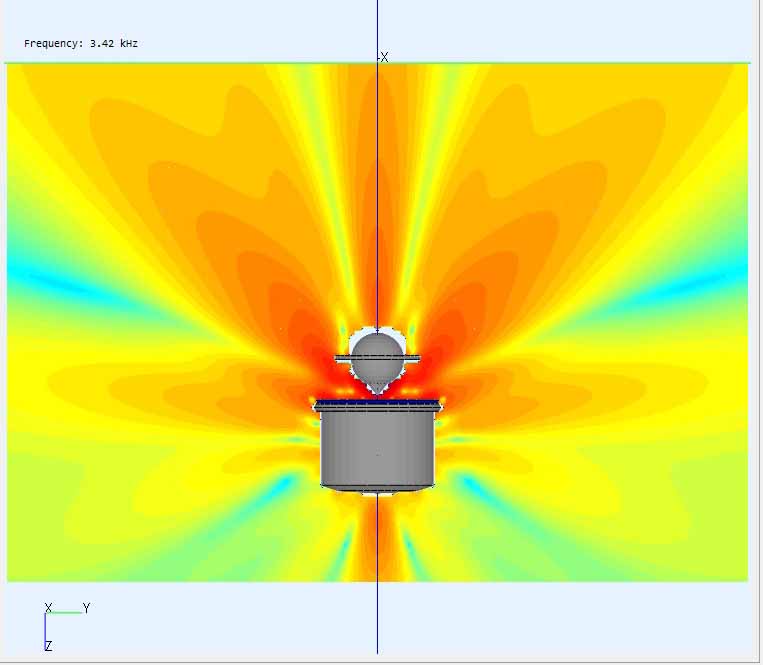

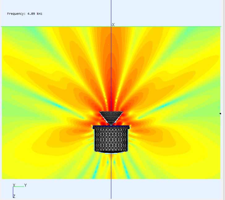

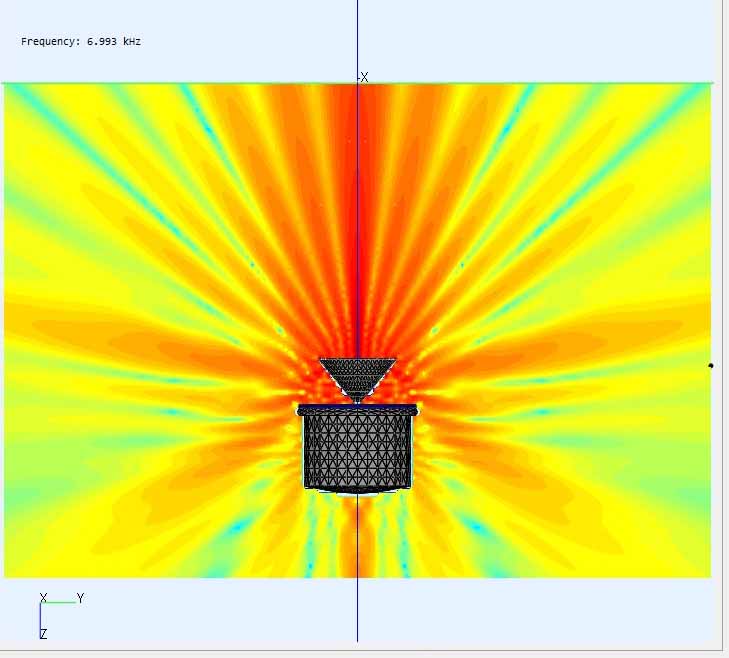

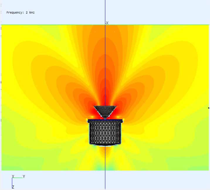

Maybe a different planet is required 🙂. I was thinking about how you could try a few ideas with those spheres. All of them ruined the aesthetics of course. The horn is 25cm ID, the sphere is 14cm OD, the disc is 23cm, and the cone is 5cm ODx3cm. Compare them to just using sphere in post #21. The field at the top of the sphere is a little jagged from simulation resolution used.

Our cnc is down at the moment so might put a hold on things, but will see what i can do by hand.
Also think it might be easier just to 3D print a reflector instead.
