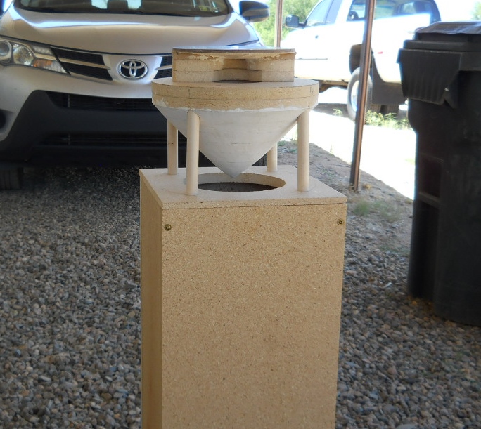

UPDATE 14/01/19
- Have made up test stands for the woofer and horns (photo attached)
- Currently setting up software etc on the DSP and will start testing when that's done
attachment.php
Will do some more updates here when there is news

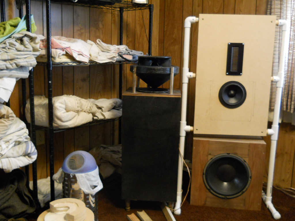

I experienced what others have stated here. The tweeter was running out of gas in the Duevel arrangement. I decided to marry the Duevel and acoustics lens - think Beolab 50. Here is a pic of the project still in progress. I need to complete the crossover. I really do enjoy the omni mid-range.

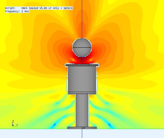

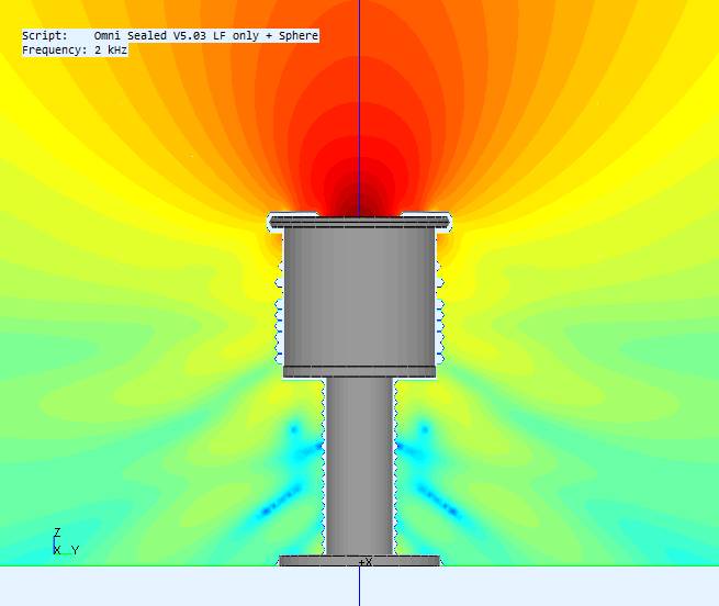

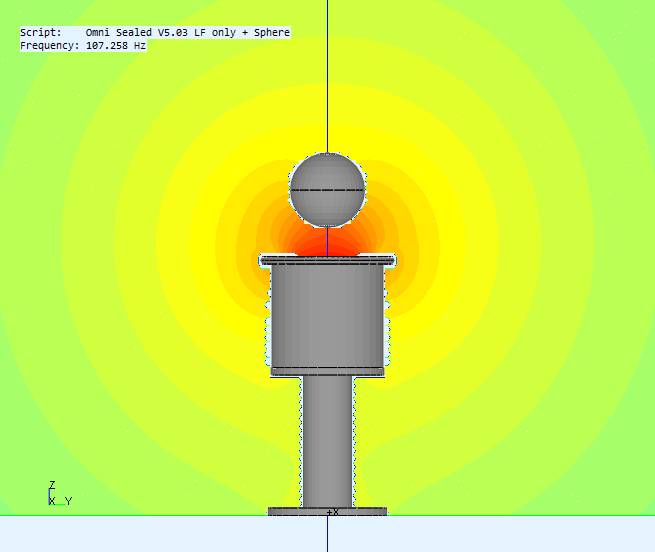

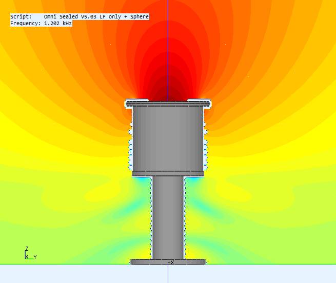

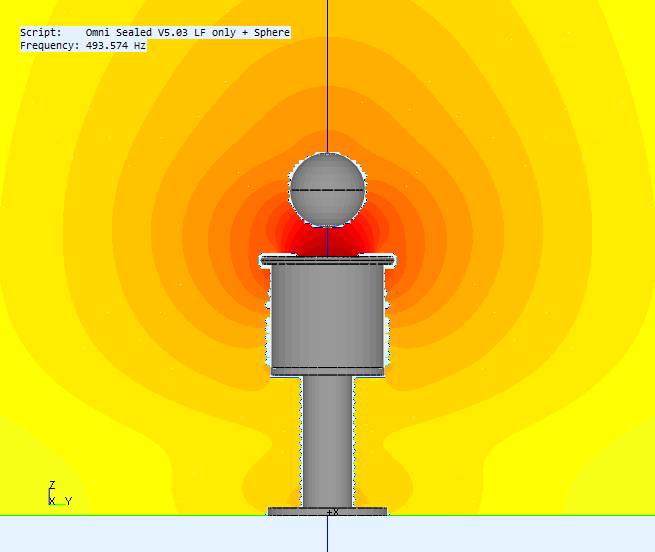

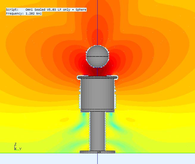

I could not find all the older trial reflector shapes I tried. So I just removed the top of my Omni ABEC model and added a sphere based on the Planet's images. I used my 8" Silverflute whereas the Planet has a 6" so I scaled the sphere to match. This should give a good idea of what happens.
I'm going to post the result images in 2 separate posts so that the unobstructed woofer is viewed over top of the sphere images. You can see the woofer starting to beam and narrow.
Thanks so much for this! Helps explain things a lot.
I see you still tend to get the upper lobe with the sphere. Will have a play around and talk to the other engineer.
Seems like a sphere is not the greatest reflector, but they are so easy to get hold of compared to fabricating a more ideal shape.
That's very true, spheres are easy to get.
Yes, its not ideal, but it could still work for a woofer with a reasonably low XO (<2Khz) and high order filter (4th order). In the images above, the last pic has the woofer dia, sphere dia and freq wavelength about equal.
The more difficult problem is the HF. If I get some spare cycles I'll post a sphere in front of a short waveguide like the Planets. I don't remember trying that combo in my earlier attempts. It might not be ideal but maybe workable in order for you to try an Omni.

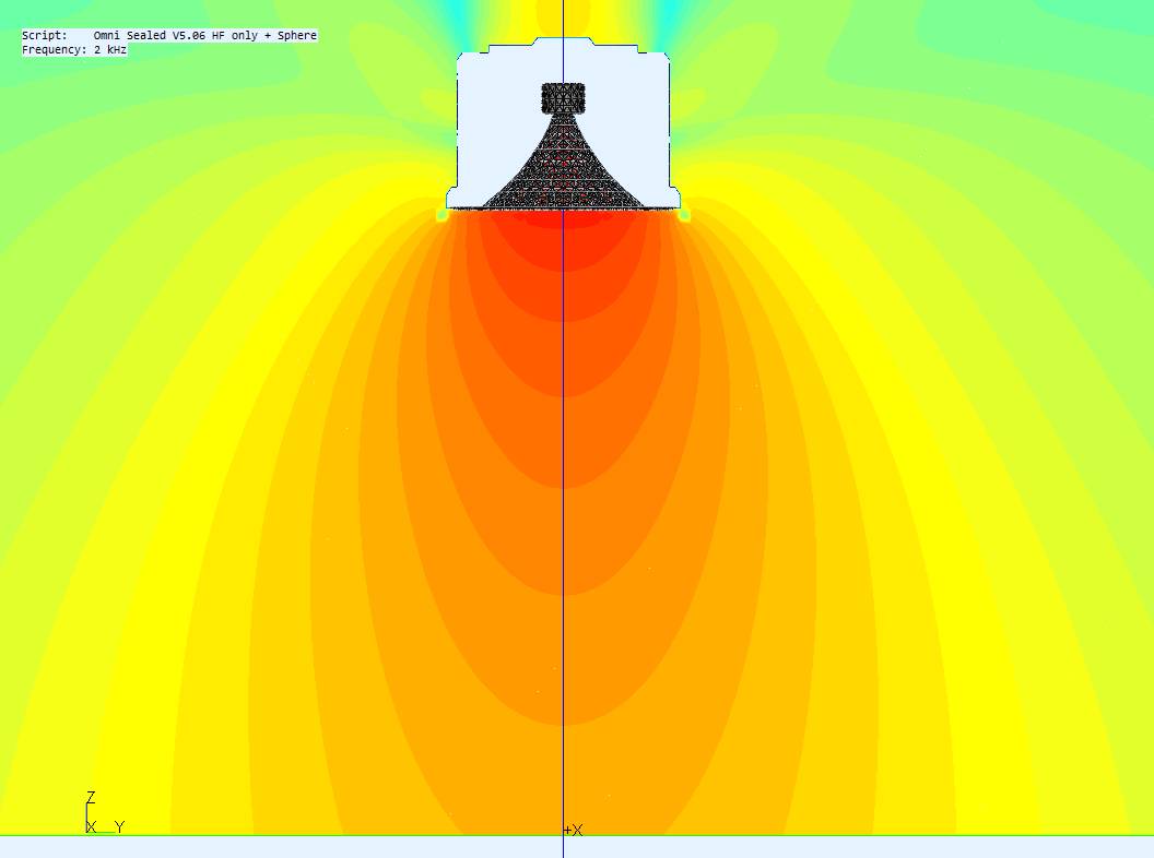

I do think its more effective to have inner/outer surfaces for the HF to direct the wavefront. You can get close by nesting 2 circular horns like the Dayton 8 or 10" models and add a tip to the inner one. I did find the spacing and tip shape did make a difference. I still need to post a horn + sphere,.. probably later today.

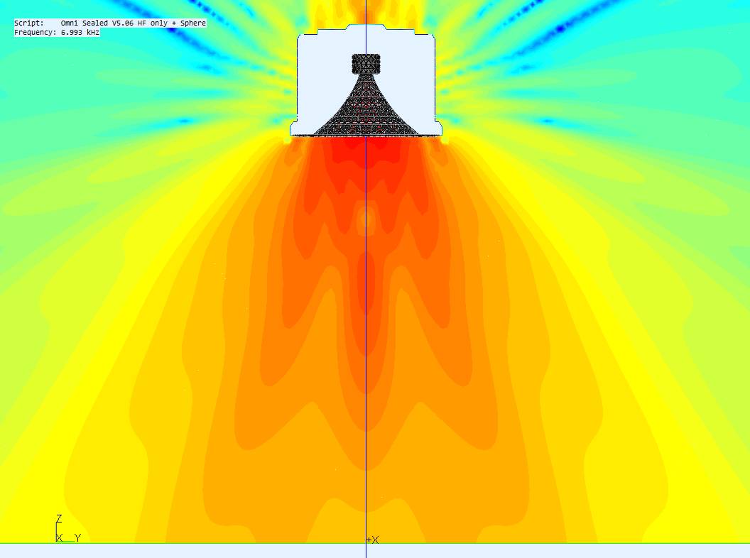

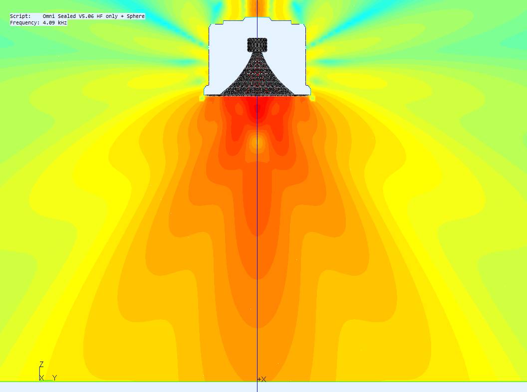

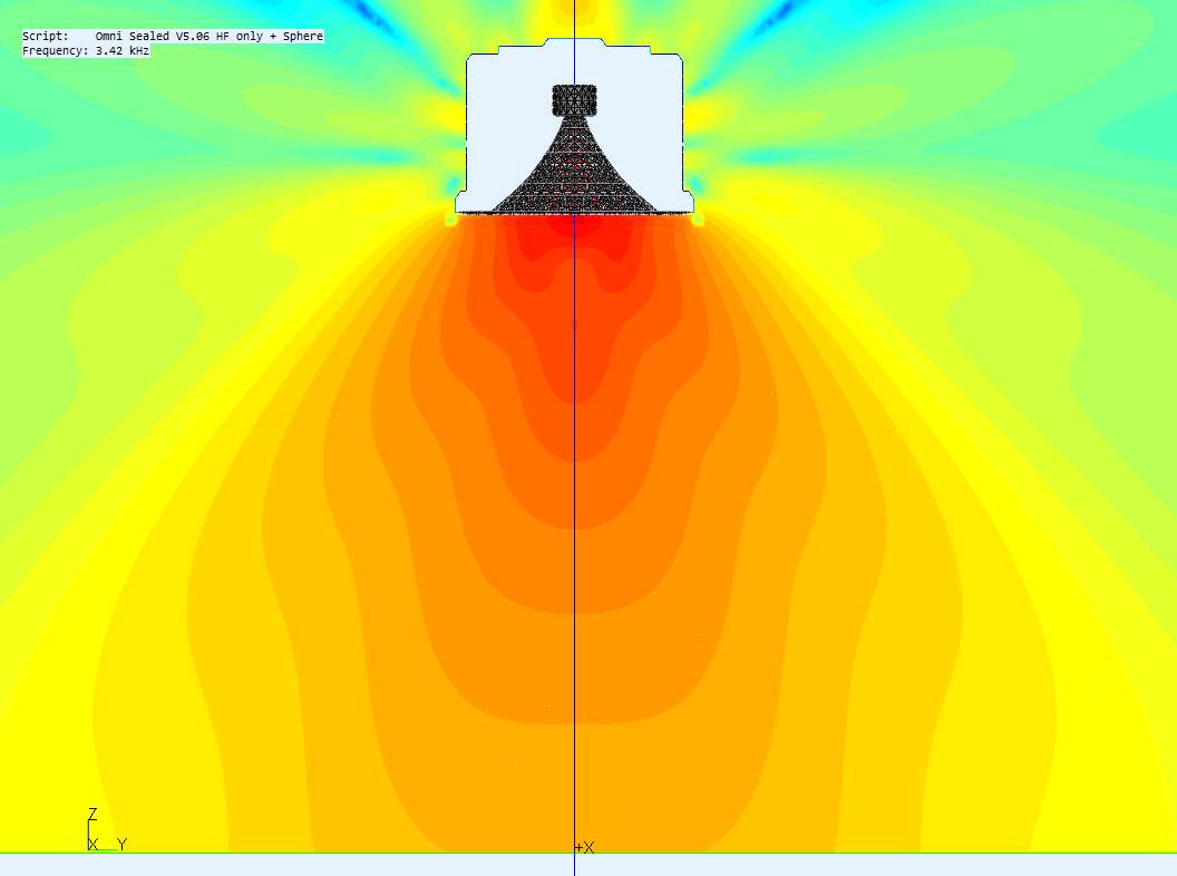

Sooner than expected. It seems I had some partial work when I was playing with the HF sections. So it was easy to drop a sphere in front. I use a 10" Dayton circular model which is larger than the Planet, so I scaled the sphere dia and offset just to get a picture of whats happening.
Again, 2 posts so you can compare top and bottom.
